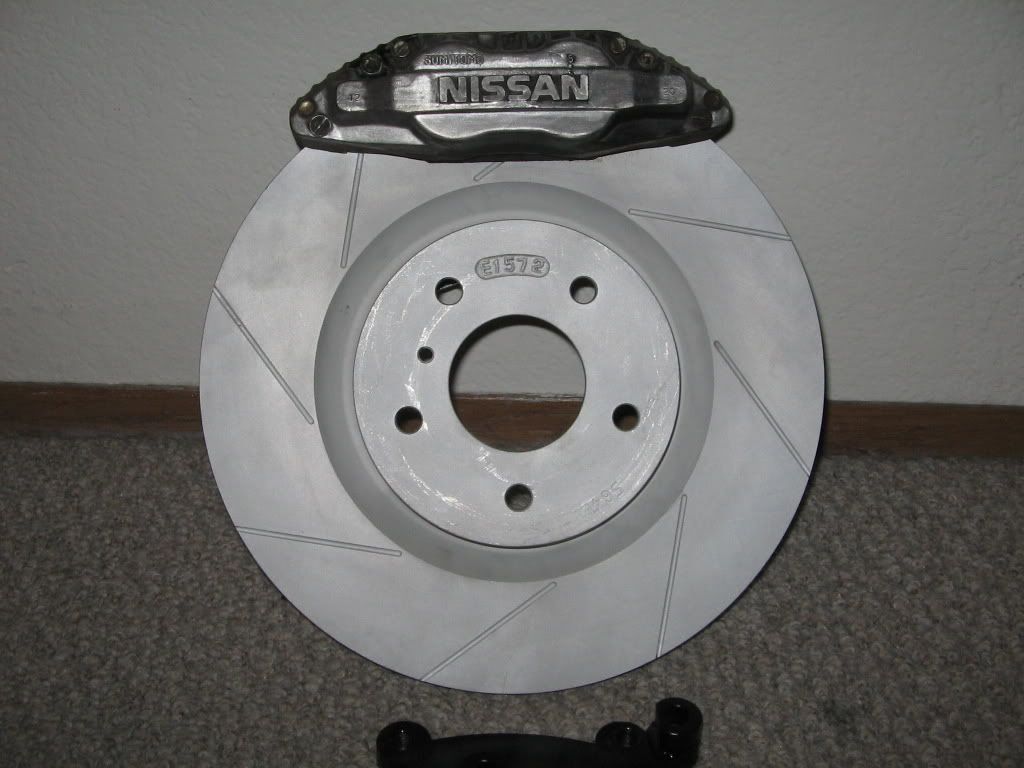

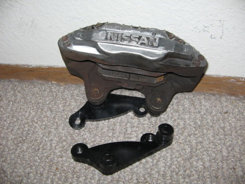

I have knock-off "Nightpager" brackets. They are paired up with 350Z 'Track' rotors. I have yet to check everything out (fitment) but, they have been done by other members, and they say that it is an improvement over the stockers. If it works out okay, I might have the brackets, and the centering rings reproduced.

Hey Chris. How much different did yours look, from my knock-offs? They are pretty heavy, but crude construction makes them look questionable.

They looked the same, I cant see any difference from the pics. I had bought them from Randy (becauseican) a couple of years ago but never mounted them. I decided to go with the Arz kit.
