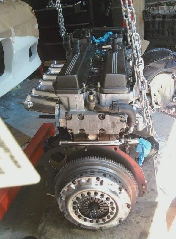

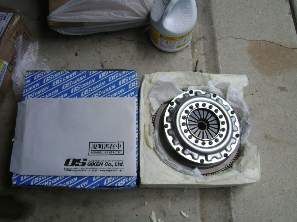

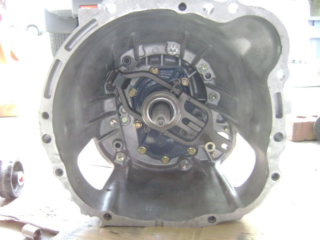

I see my thread is back from the dead. I've read alot of people complaining about the aftermarket slave on the spec leaking among other things. I ended up buying the OS giken twin disk instead of the spec twin disk. No regrets at all. I dont remember the weight. But I can say I know it wasn't back breaking heavy. These are not hard to get, just expensive. I believe driftmotion now sells them. Best clutch you can buy other then tilton (which is double the price). Here are some old pics of my clutch. enjoy.

ya just sold my tripple plate osg since it was the heavy fly wheel one and weighed in at 35 pounds if I remember right
I did not like how heavy it was
