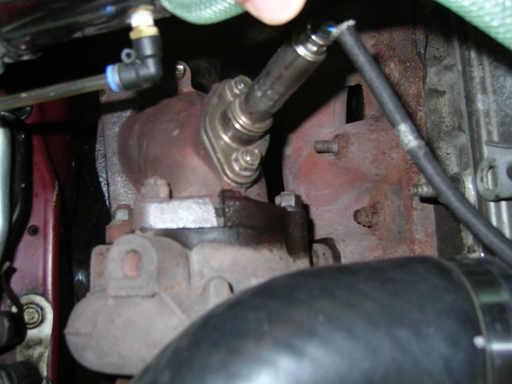

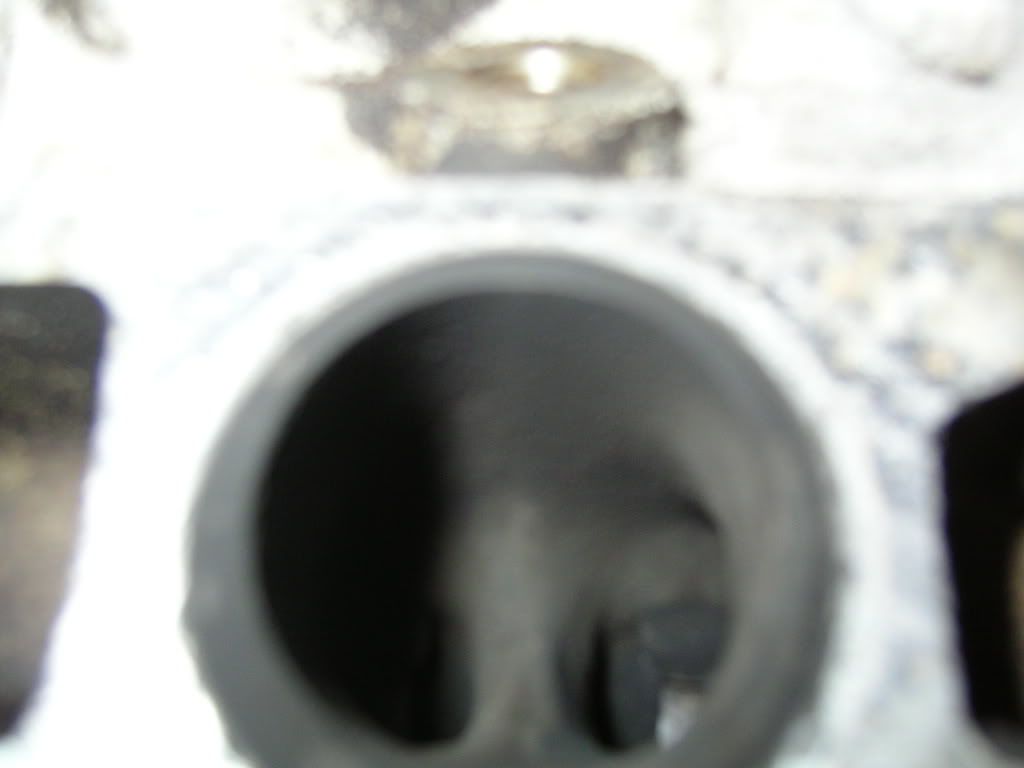

Well this is the story, I JUST got the car up and running after 8 months of working on it.... i finely get it up and running and i drove it around for a few days and all is good... but it slowly started to smoke. getting worse and worse.. and if you look down at the turbo there is oil coming out of the joints. but i took the exhaust manifold off and there was no oil coming out of the head..
and then the leaking turbo
^as you can see oil is just oozing from it.. adf
Is that a catch can right beside the turbo housing? You may want to move that over to the otherside of the engine bay where it's cooler. Just my opinion.......lol and good luck.
You'll have to wait on someone else to answer about what's wrong with your car. I'm sure someone will answer it shortly..............lol
