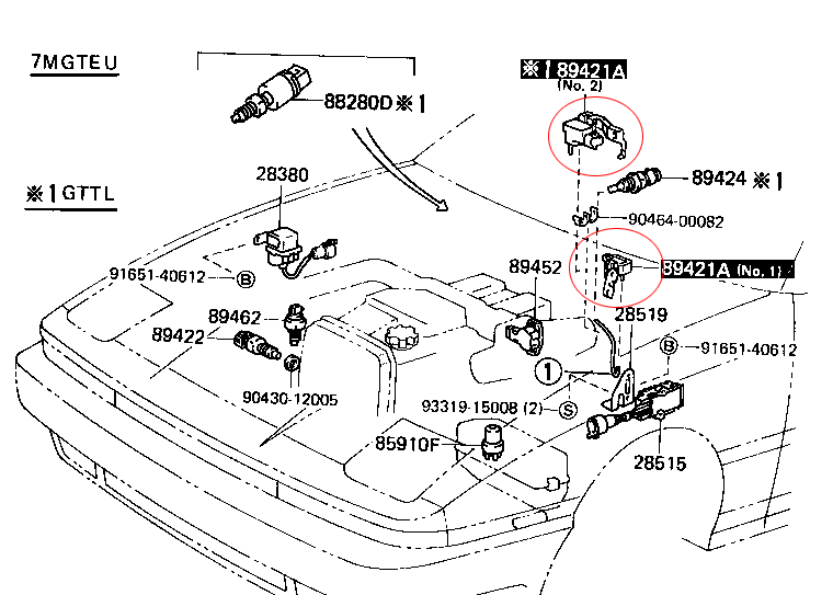

Tim any more info or close up pics yet? I have the Turbo A ECU(confirmed). I'm told I have the complete Turbo A harness from the seller.(Still trying to confirm the harness) I've also been wondering why my harness has (2) identical pressure sensors. Sorry I'm technically challenged and am trying to figure this out myself..
are you sure they are exactly identical? according to the japanese EPC, the TurboA indeed has two pressure sensors, one with the P/N 89420-14050 and one with 89420-14020 (which is the same as on all 88-90 turbo MKIIIs).
probably one is for the ECU and one for the boost gauge?
here's the EPC diagram.
Well looking at the two sensors on the harness I have, I can confirm the numbers on the one as 89420-14020, the tag on the other sensor the numbers are worn out and I can't make them out.

Is the sticker on the sensor kind of orange? if it is then thats the Turbo A map sensor!!
If it is yellow then it is the boost gauge pressure sensor. The sensor i am going to try and use is 89420-14020 which is the boost gauge one. If that dont work i am going to try a GM 3 bar.
