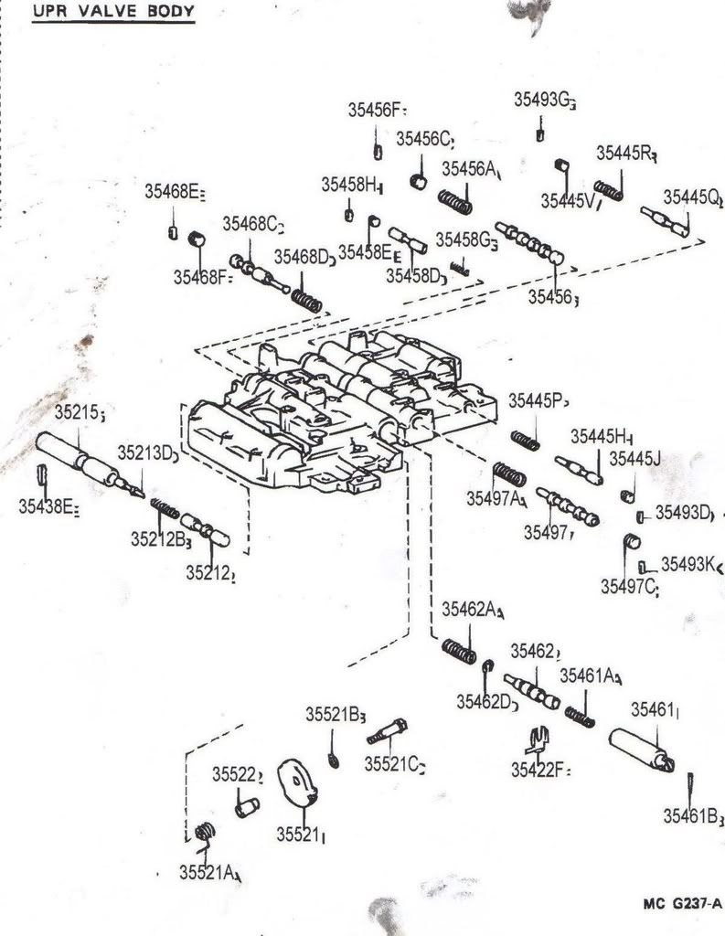

Gonna ask this here so I don't make useless threads. Not sure who is the transmission tech here but I need to know about a small clip in the valve body. When you take the two halves apart there is a small clip that is laying in there and I'm sure it is supposed to be clipped to something or in a certain direction. I couldn't really see a definitive picture in the TSRM. Does anyone know of a good breakdown diagram of the valve body? Or lead me in the right direction. Thanks Bill.

Surely someone here has done this before. I'll be digging into my valve body again tommorow or Tues. Depending on when toyota gets my valve body gaskets in. Any info would be great. Thanks Bill.

Well I went to Toyota Today and figured it out but I'll scan the exploded view they gave me for future reference if anyone else has this question.

Ok part number 35422F is the clip. It connects to 35462. When you take the bolts out of the valve body and lift the upper portion off this clip is just laying on its side. But if you look on the valve body you can see 35462 and where the clip goes. Also a pin and a woodruff key may also fall out but they are easily located. If anyone needs pics of this I can take my old valve body apart and show them. Thanks for the replies. Thanks Bill.
