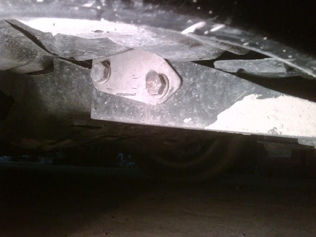

Here ya go!
Fernando

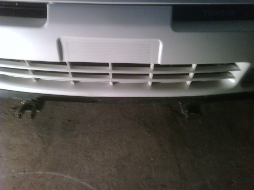

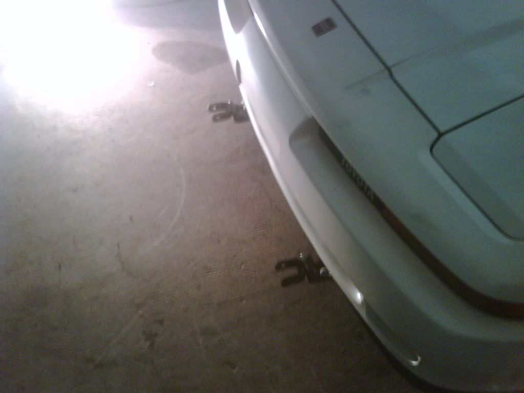

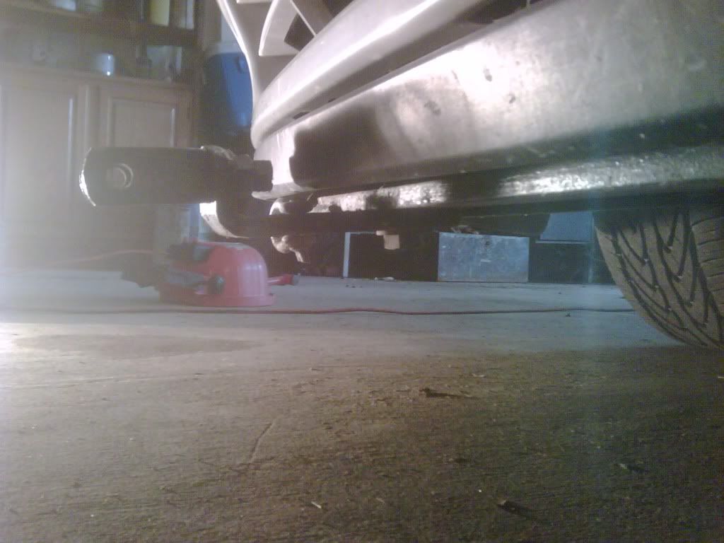

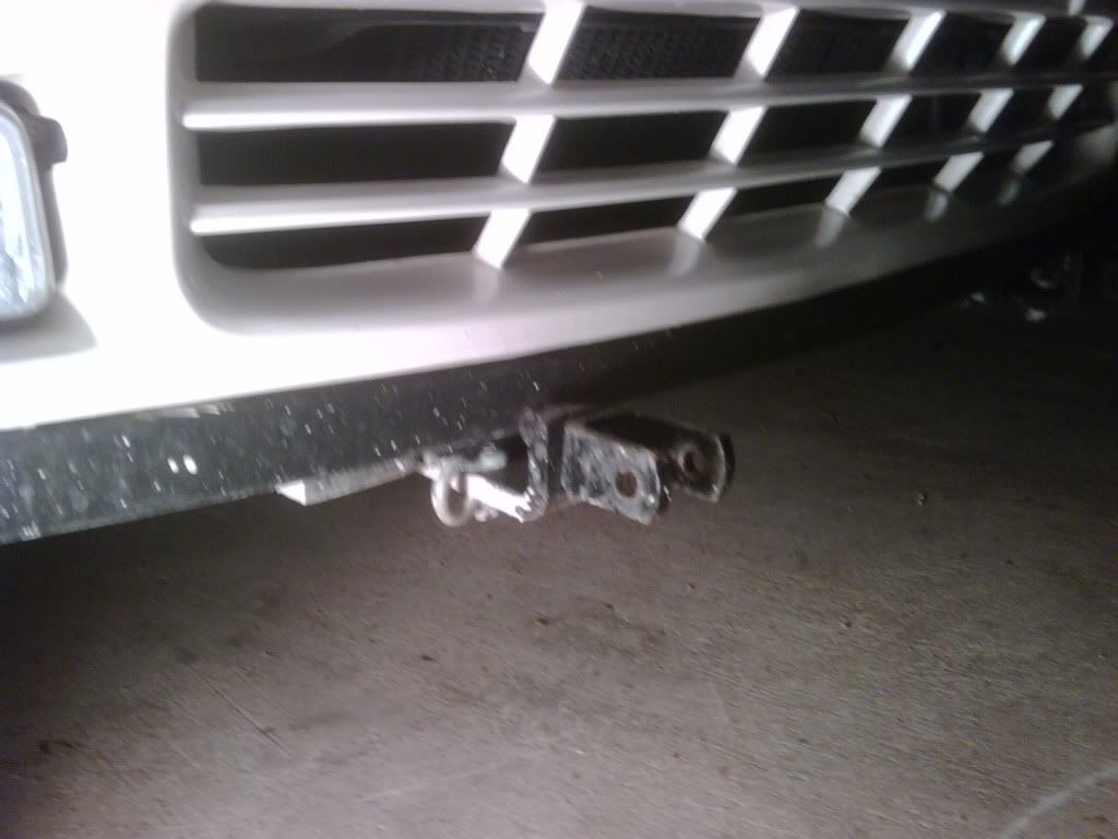

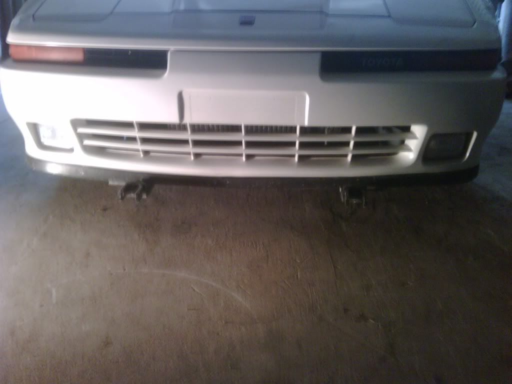

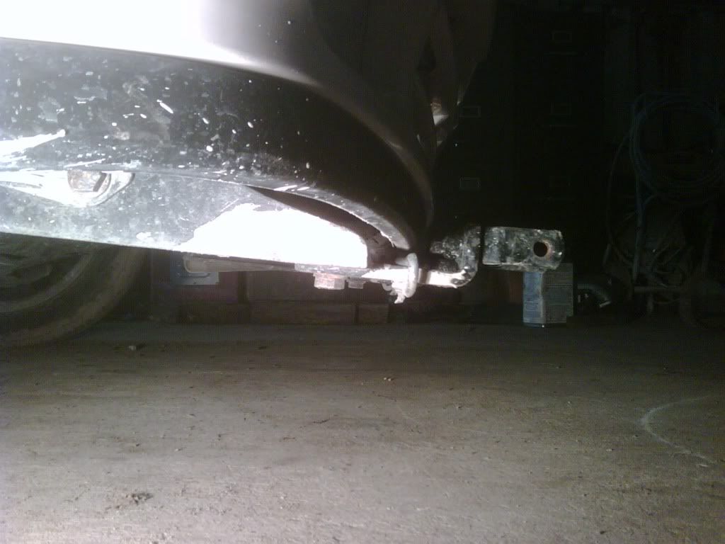

thanks for all the help especially the pics.i was thinking about the towbar idea and i really like it,but i keep thinking about the breaking issue, so i thought about why dont i :aigo::1zhelp:just sit in the supra that way i can at least steer the car to make it easier.i could use the breaks in the supra to help slow it down quicker. what do you guys think
