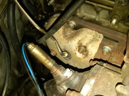

Fubar231;1387057 said:Remember, the bung is located on the runner of the 6th runner (Which i BELIEVE gets the hottest). And if memory serves me (Which i highly doubt it does) People said not to really worry about the 6th runner unless its ~1550+.
