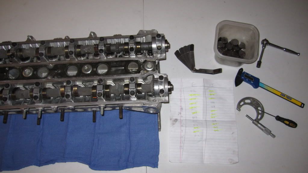

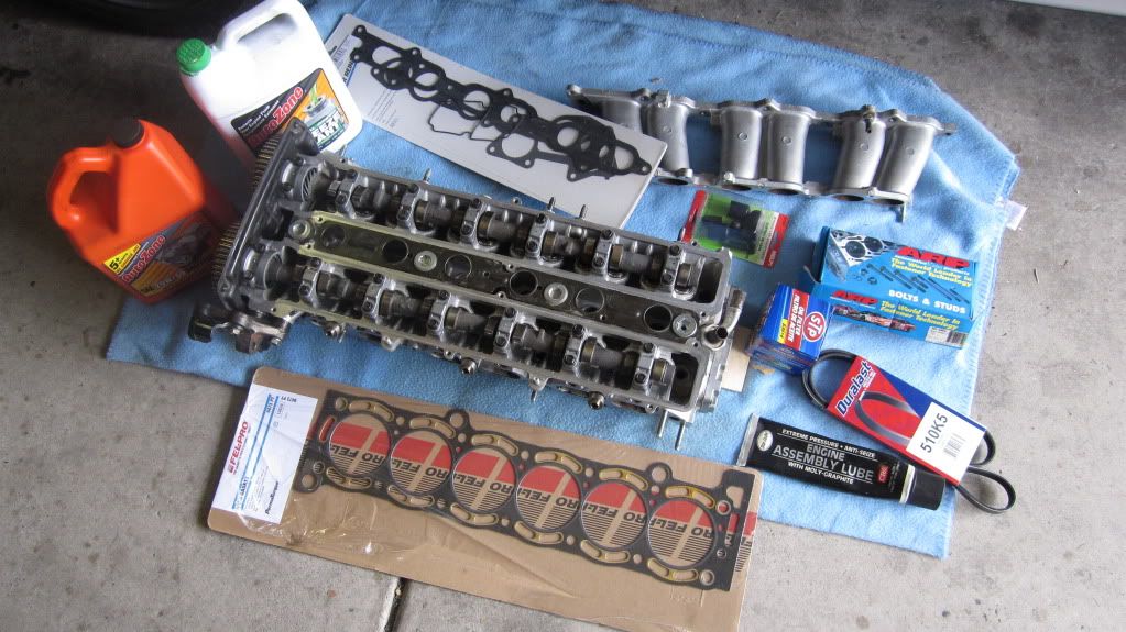

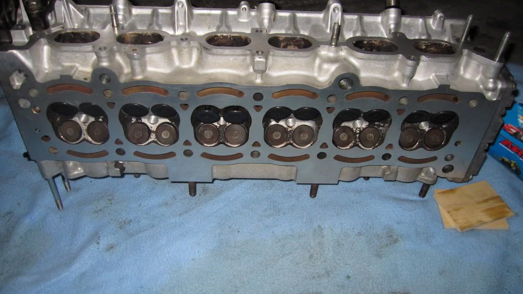

I was the installer of the head, The pic with the head gasket part circled is my pic and the actual gasket that is on the car, and that is my head in the picture as well.. It is NOT a metal head gasket, just to be clear... The only thing a feeler gauge was used for was a valve lash, which was a whole set of them.. Its kind of hard to tell but the thing circled on the gasket is what is sticking out of the head.. Here are some more pics..
Also the gasket in the pic that is the bottom, that goes up against the block..

No1 pointer i have learned. Always set the head on the exhaust studs or exhaust side to prevent war page. I would never set a head on the milled side. Its a piece of metal right it doesnt warp that easy wrong. Its a precise piece of alum that you want straight as a arrow. I remove those t stat housing studs when the head is going to sit for a lil.
I would sine you have the ease, You also have arp, pull the head machine pressure check, Idk what your prices are but usually about 60$ from what i have seen and get another felpro gasket which is about 85-100 depending on your discount.
You have it out its easy and its fairly cheap. No1 reason for doing it now is its not in the car and awkward as hell. If it was me i would. thats just me tho.

Machining the head is no problem, get that done for free.. Gasket is like 65.00 shipped.. Just don't see how that could blow out.. Ill throw a compression gauge on it and do a check tomorrow..
About the head thing, Built about 20 motors and never had a problem with the heads being sit flat..

Its just something i have learned from a machinist. There is no reason to set the head on the sealing surface after it has been machined.
You felpro looked different than mine. Have you check the torque on the head bolts/studs(which did you use). You are supposed to do a re torque as the bolt/studs will settle and which is why reusing is easier.

All in all seems like you did a ok job and maybe you just got a shit gasket. There have been some of those posted over the years but it also could have been the installers.
From the pics it does not look like something from the install.
