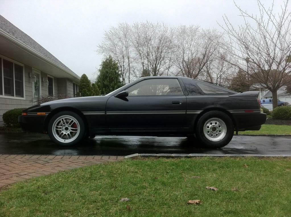

Well, One day later Tire Racks quick shipping had my new goddies at my door yesterday. This morning i woke up early and got them mounted up despite the crappy weather. They looked very nice when recieved with free lugs!
Weighed the Cobra wheels and GarbageYear tires, Scale said 54lbs......Each. Weighed the new combo and the scale said 38lbs! 16LBS lighter on EACH SIDE!
Best part is that i drove around on them and it doesnt tramline. The most problem turn lane barely sucks the car in, but it doesnt jerk the steering wheel or feel even half as out of control as it used to. I guess thats why the goodyears are #30 something in there catagory.
Another thing is since these have more offset the power steering feels way better. Used to be hard to turn when moving very slow or stopped, Not anymore.
Specs are 235/45/17 Continential DWS on Enkei RPF1 17X8 with +45mm backspace. The fitment is very nice, Tire Rack FTW!
PICS!!!

Good to hear you like them man. My wheels are a bit sucked in (not terrible, but it works), yours stick out just a bit more, look better too. Hard to believe they're that much lighter, I wonder if I can get those wheels in a size that would work for me..?

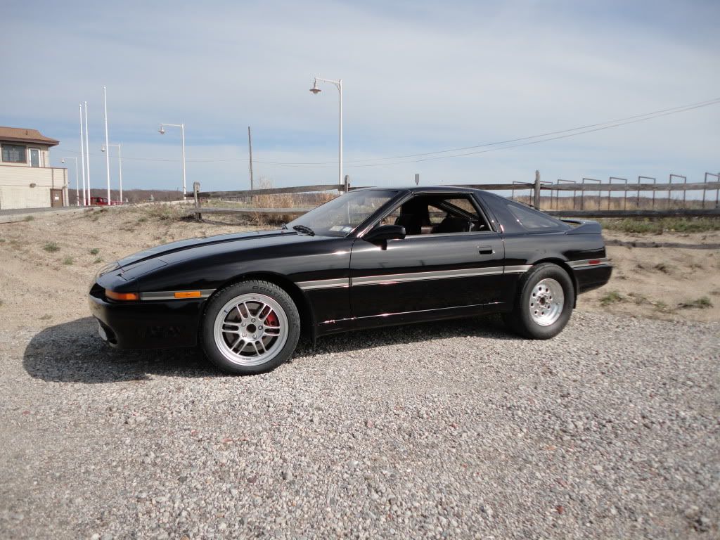

Now that i have put a couple hundred miles on these tires i would reccomend them to anyone who needs tires. They are great, quiet and comfortable and grip very well. Yesterday it was raining all day and the car drove perfect, Today its 70 and sunny and same result.
Updated sig with this picture. Took it with a camera instead of Iphone like last picture. Refer to Build Thread for more pictures.
