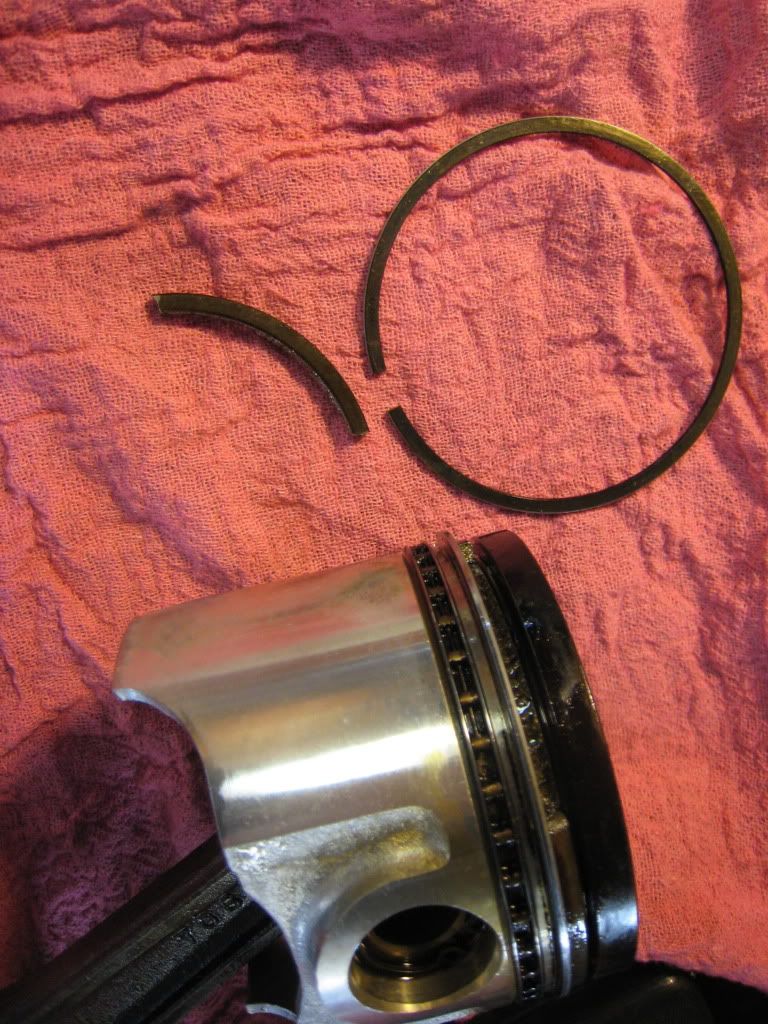

One thing I've learned over my years lurking on Supramania is to never doubt IJ... Until I pulled the rings off I didn't notice this, busted ringland on piston #6. The cylinder walls look good, no vertical scratches so I don't think it was busted for all that long... ugh... forget rings, now I have to buy new piston(s)...

I had a similar situation years ago. Piston looked totally fine, set it down and came back later. When I went to pick it back up most of it stayed there. Lol
62
IJ.;1880642 said:
I'm willing to bet there's at least one broken ringland in your engine or it's just plain worn out... :(
ta Daaaaa :D

No intentions of being a smart ass here, but you have your terminology mixed up a bit. The ring land is the part of the piston between and above the rings. You've got a broken ring, not a broken ring land. Those do break too though, so check your pistons carefully. Detonation usually breaks them.
Edit: LOL, sorry, I'm an idiot. I just noticed you DO have both a broken ring and a broken land. Sorry about that.
62
You doubted me?? ;)

Not that it matters but the rings aren't broken, in fact I even used the one you see in the picture to check my ring gaps on that cylinder (they're within spec)
The big question is WHY did the ring land break? I know I had a couple of runs while setting up the maft pro where my AFRs went way high (19+) and the knock sensors killed my power... but that was a few weeks before I did the 6500+ RPM pulls in 4th gear and noticed all the oil pouring out of my filter. I assumed the piston broke during those runs, then I noticed the oil pouring out, limped it to the garage and pulled the engine... I wouldn't think I could've driven a few hundred miles with that busted piece of piston just being held in place by the two rings - right?

"incipient detonation" Google it ;)
I remember reading up on that when you suggested that the last time I saw you post about it. Kinda shitty from what I learned about it.
