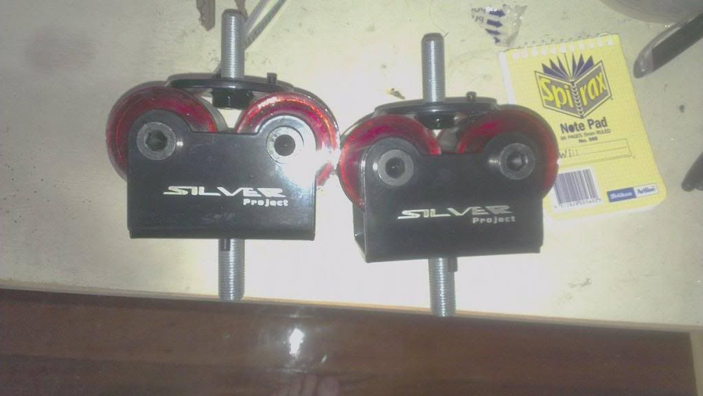

Doesn't hit the sway bar (Probably due to running 6 degrees neg camber which i've attributed to the upper arm pick up and the lca ball joint pick up being different lengths to standard, not to mention me moving the balljoint 15mm~ out) the wheel does hit the upper arm on full lock under load though, Running the soarer knuckles I lost about 30mm of track, so I had to make up for that with a 30mm spacer, it's a bit wet at the moment and I can't be bother doing anything till my clutch gets back so photos will wait till then.
These did just arrive however, so I'm one step closer.

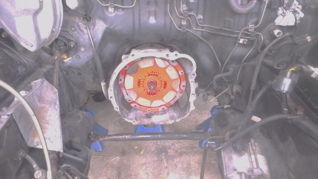

Couple of updates, clutch arrived.

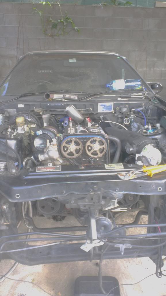

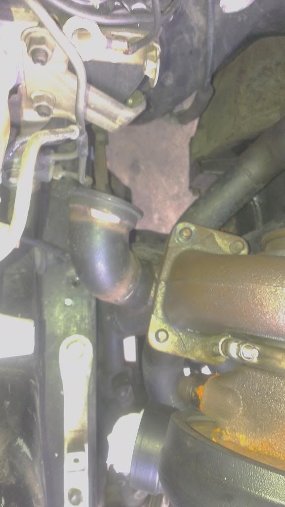

Put the motor in, test fitted my exhaust manifold, fouled on the exhuast studs, so I took them out, could bolt the manifold onto the head.. Waste gate runner is all wrong.. Shit..
Pondered my options, bolted my rr intake manifold on, Didn't realise they foul on the fucking fuse box, so I took that off and some random relays that sit under the fuse box (If anyone could tell me what these do, that'd be great, thanks.
Got here and gave up...
TBC.
