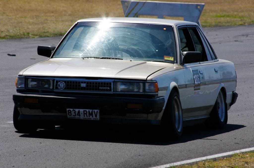

Oh and this was my previous drift car a 6mge powered mx73, just had modified knuckles and coilovers all round, did pretty good for a geriatric old thing..
