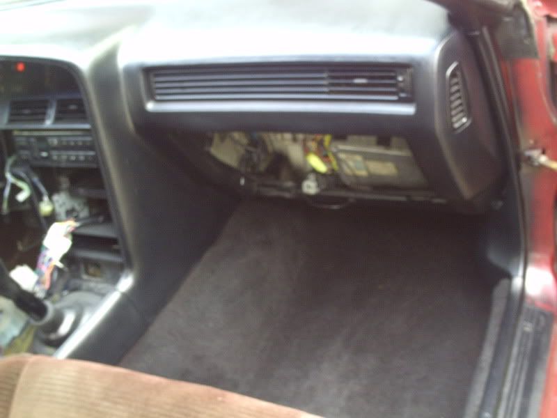

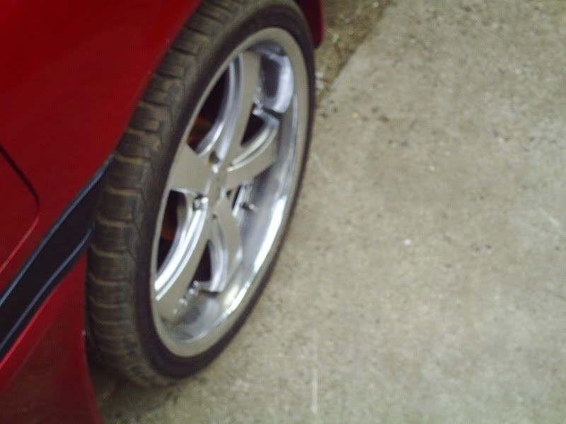

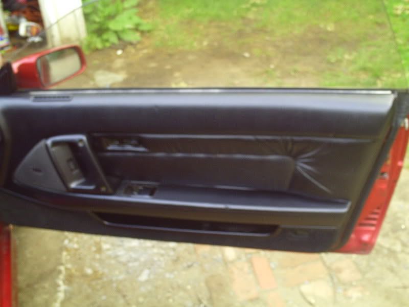

some more updated pictures and a random last minute video i took before it thunderstormed here.
showing fitment of the 19's on stock suspension before i install my springs
carpet and dashboard dyed black
black door panels

duplicolor vinyl and carpet paint. semi gloss.
My boy used the rustoleon flat black vinyl paint and i saw his today and it came out nicer in my opinion than the semigloss so eventually everything will be redone with the flat black vinyl paint

i think 19's are perfect and the largest i would go, All of my boys have them on their lexus sc's and i have some friends throw them on thier mkiii's so im like if they could do it i can do it too lol. Cant wait too see how it looks dropped tho, I kno with the 19x9.5 in the back with the 275/30 tires its gonna rub from the offset, so i definitly will have to at least roll the rear fender the fronts look ok so far.

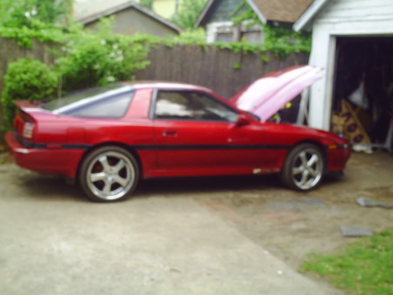

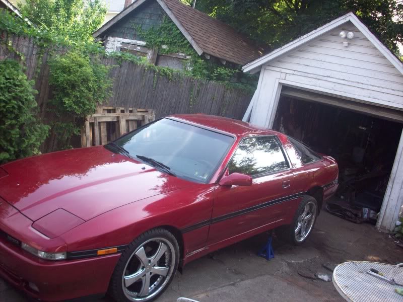

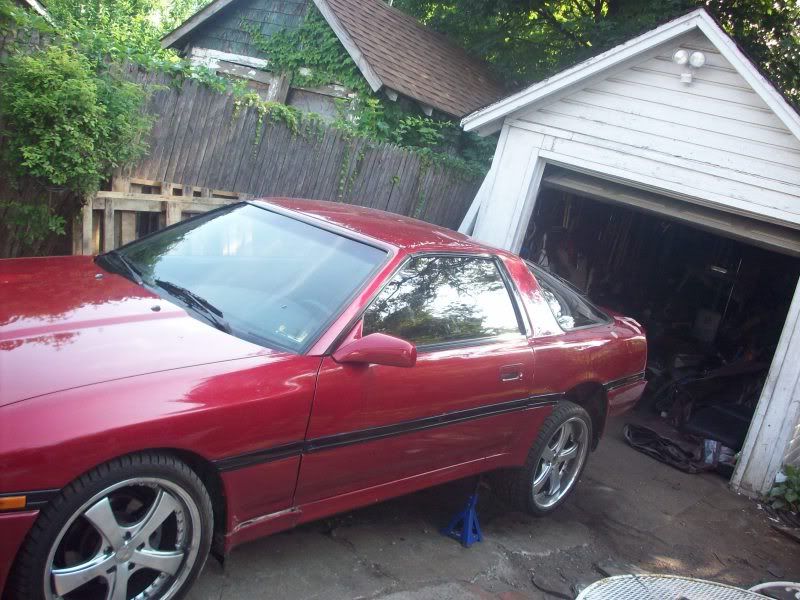

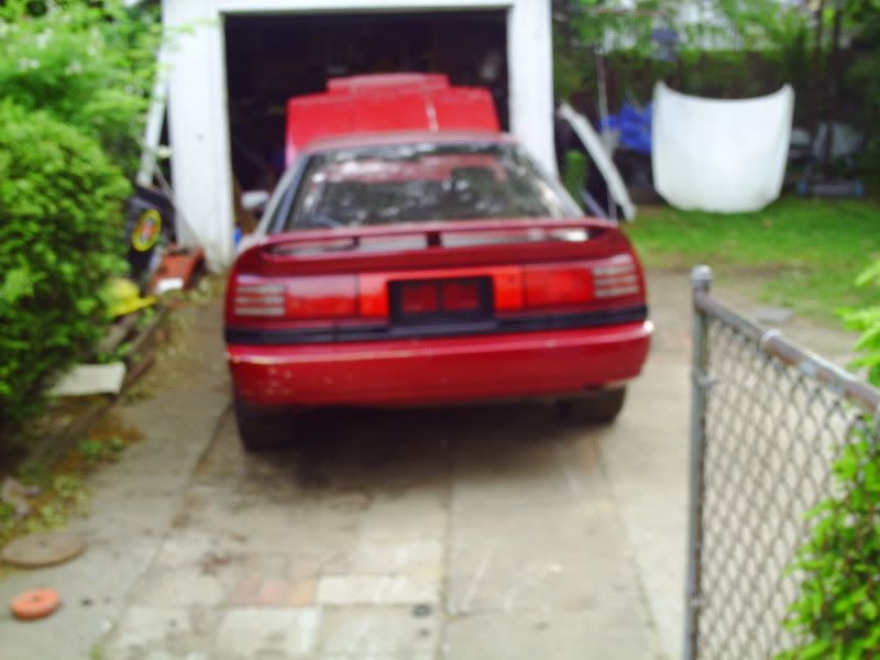

Time to post some progress. I got a set of used eibach springs, just finish installing the back and notice that one of the rear struts is not the oem tems and is a autozone special Gabriel shocks. Sucks ass. The other three shocks are all tems but its time to save and start putting money aside for a set of Bilstiens. I can tell just from looking at the rear even though the springs havn't settled in yet, there gonna rub and I need to roll the fenders ASAP.
Will post pics when im finish with the fronts

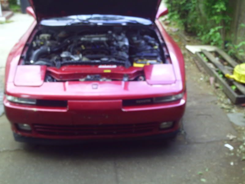

Turbo is Officially blown today, It had some shaft play and in and out play while i had everything apart during the hg fix. It wasnt smokin at first on stock boost but when i installed my dr. Jones mbc and turn it up to 10 it started smoking bad, real bad. Smokes at idle, and on deceleration. Smokes really really bad. I wil be installing an oil catch can to see if it helps but until i have funds to get a rebuilt 57trim on, i will just be checking my oil regulary.
next upgrades I'm saving for are intercooler hardpipes, wheel alignment, and redo my brake system and finally bilstein shocks all around.
In the meantime still transforming the interior black piece by piece and redoing the stock toyota linterior and exterior lighting, all leds bulbs all around.
queenskid926
Tires yeling @ every Lite
Jul 27, 2007
1,112
New York City

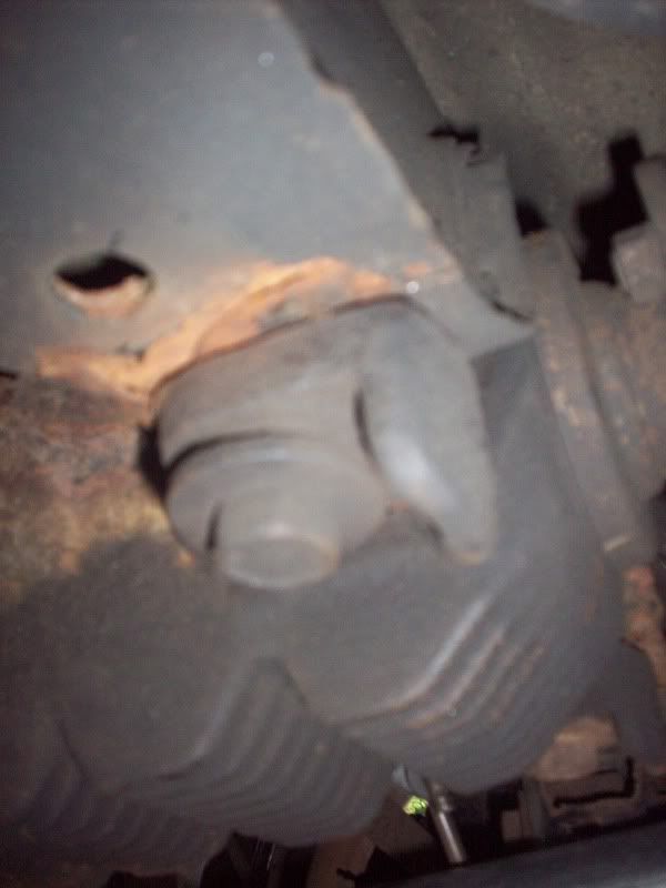

time for an update, and some pics, Good and Bad news,
Got my 2.5" intercooler hardpipes installed with all the couplers and t bolt clamps, car feels great. faster spool up and holds boost nice and steady.
Ordered a new cps cover and marlin crawler shifter bushings from driftmotion.
Bad news, found out that i have a cracked subframe right where the diff bolts up. Looking to get it welded this week.
Turbo is blown dumping alot of oil, But i have a stock replacement from a friend that will be going on soon.
