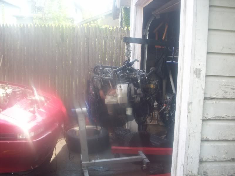

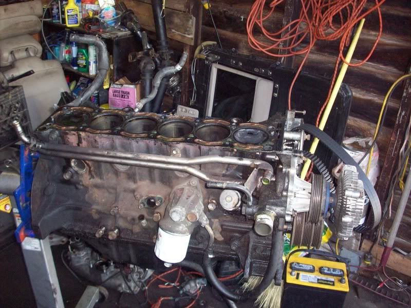

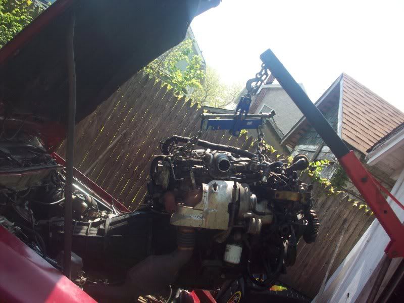

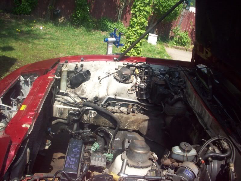

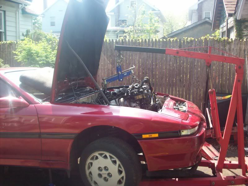

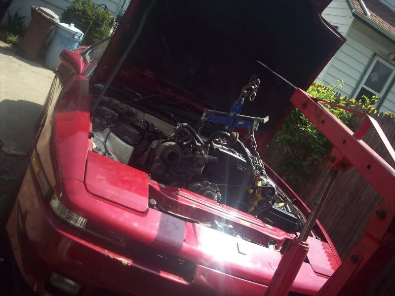

Got some progress on the Supra done today, Pulled the motor and tranny out this motor and got the motor set up on the engine stand. Taking a little break now to post some pics. Going to start stripping the motor today and pull the head off to send to the machine shop and try and start removing everybracket and begin degreasing it to get ready for the paint.
Time to stack up on duplicolor high heat engine paint.
And Tomorow i will try to start removing everything from the engine bay to sand and respray it black since in the end the color of the car will be repainted black as well.

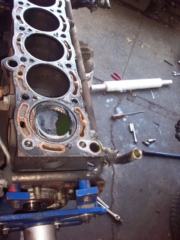

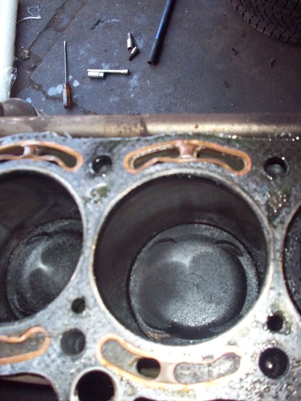

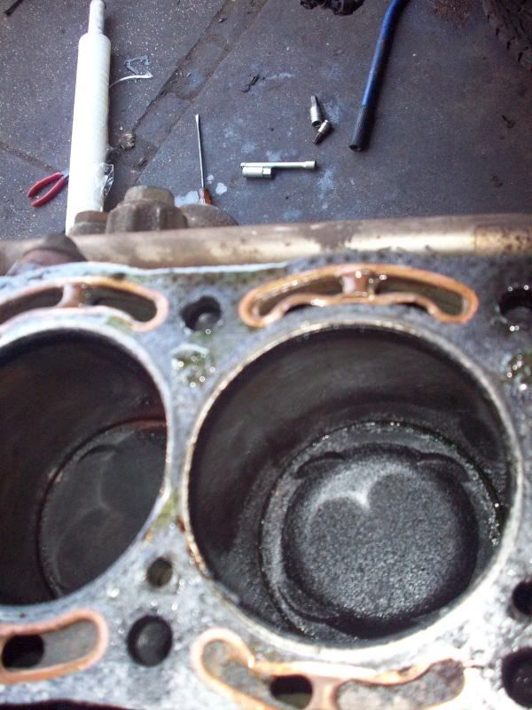

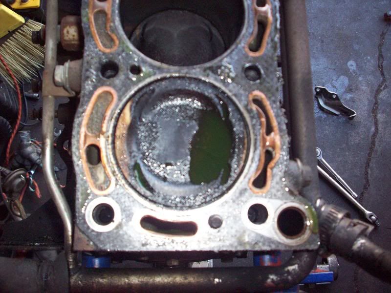

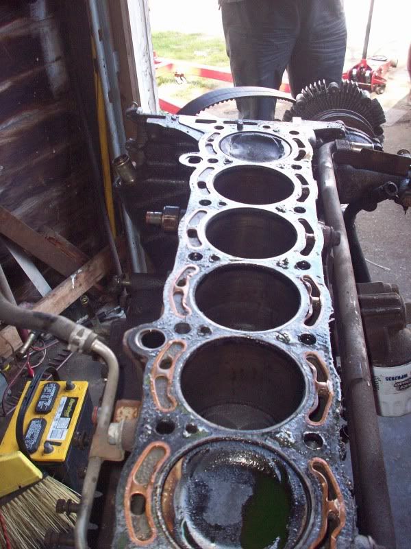

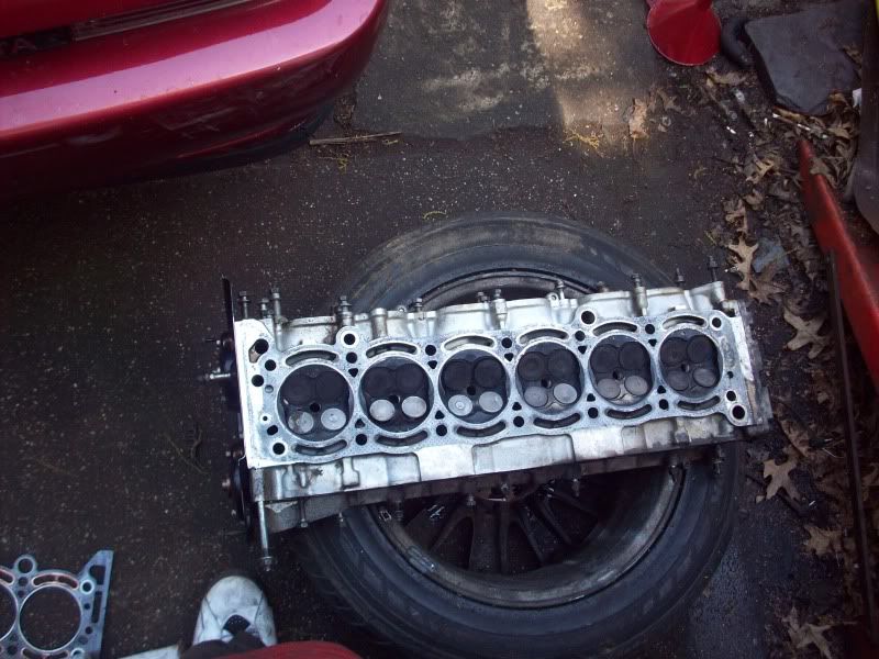

Made some progress today, pulled the head off and sent it to the machine shop and the headgasket was definitely blown. Seperate from rings for the water jackets and actually broke off completely in one spot.
Head is at the machine shop. Hopefully i can get it back sometime early or mid next week so i can have this car ready for toyota day may 8th at e-town.
Got the block stripped today and clean degreased it getting it ready for paint. Also going to start cleaning degreasing sanding down other parts and brackets so everything will look all clean and pretty when its done. And so that i can spot leaks faster as well.
Making some progress. Hopefully tomorow ill have the block resprayed as well as all of the brakets, timing cover, and if im nice do the intake mani's as well.
Orderd some fipg from driftmotion, a 10an drain to go with my driftmotion ct26 soft lines i already had, and arp studs and new oem hg from toyota.
