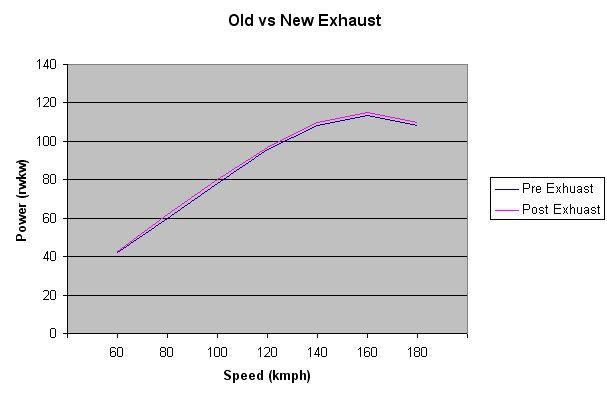

Slightly more power across the board, will post both sheets and a quick vid later. Err the 3inch in farking loud though, like race car loud, fucked my tune massively too. So probably more power in the 3inch with some tuning:icon_bigg.

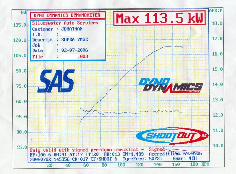

Old system was FGK Fujitsobo extractor into 2.5inch cat into 2.5 inch press bent into 2.5 inch straight through muffler.

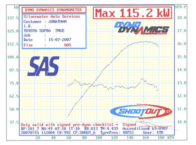

New System, same extractors, 3 inch cat, 3 inch mandrel bent system and 3 inch straight through exhaust.

^^^ Indeed I was worried about losing some bottom end but nope. I have scanned in the graph, its amazing how much the 3inch has fucked up my tune though. Leaner which is good but its all over the shop. Notice also that it was wound out to 180kmph on the dyno this time which suggests its holding in the topend alot better too.
Old Graph:
New Graph:
In saying this I wouldn't rush out and throw a 3inch on your NA because it makes more power, my car is now so loud you could probably hear it 2 miles away at full throttle. But I only drive the car on weekends to have some fun and in motorsport, not the kind of exhaust I'd put on a car that does alot of driving unless you were to throw a proper muffler on and possibly alos a resonator.
