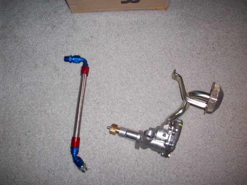

Oil pump - Driftmotion
7M Oil Pump Hose -8 AN - Driftmotion

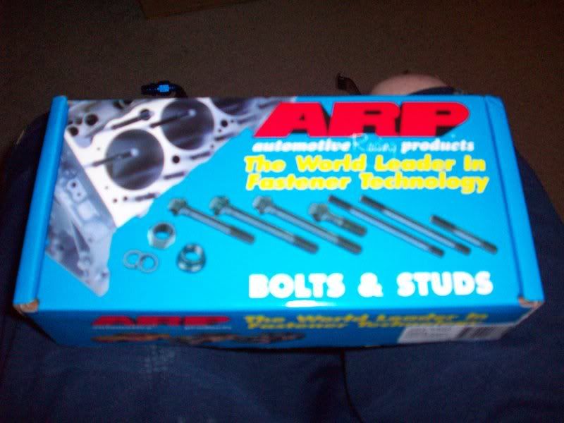

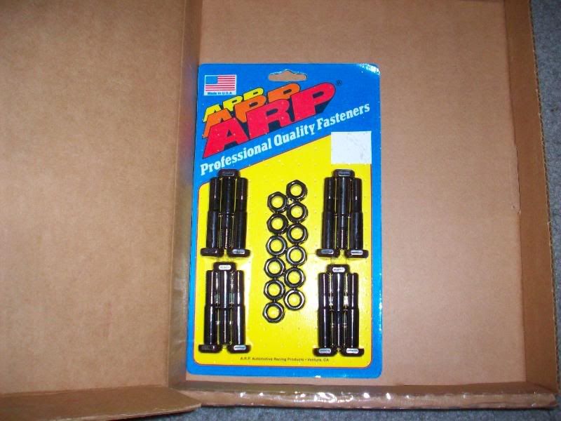

ARP Main, Rod, and Head bolts - Driftmotion

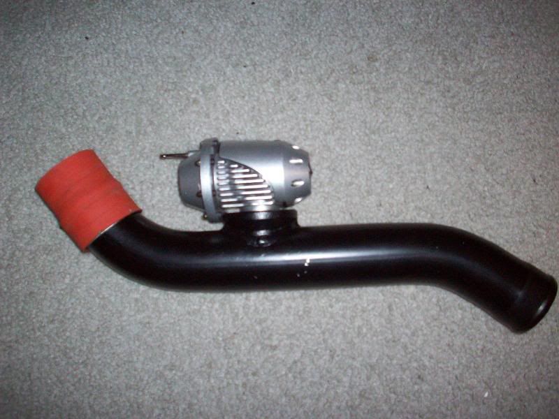

Bov and Pipe - Member

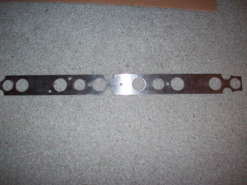

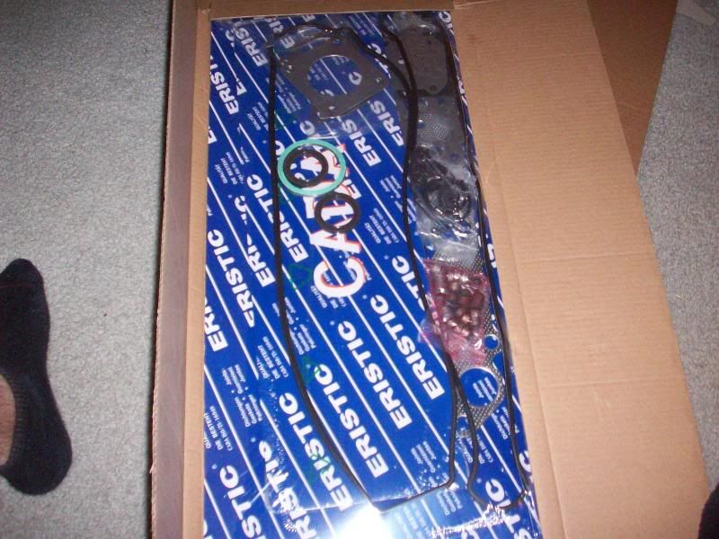

Gasket Set - Eristik Gaskets

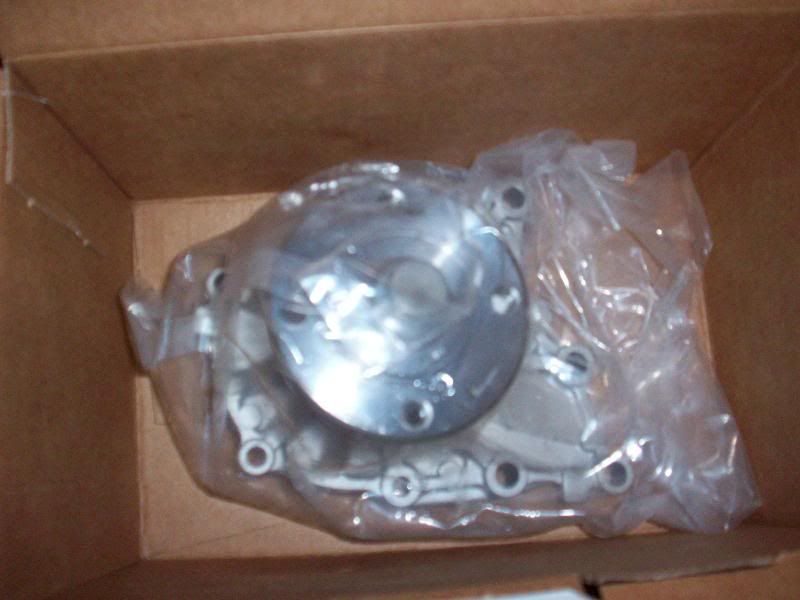

GMB Waterpump - Driftmotion

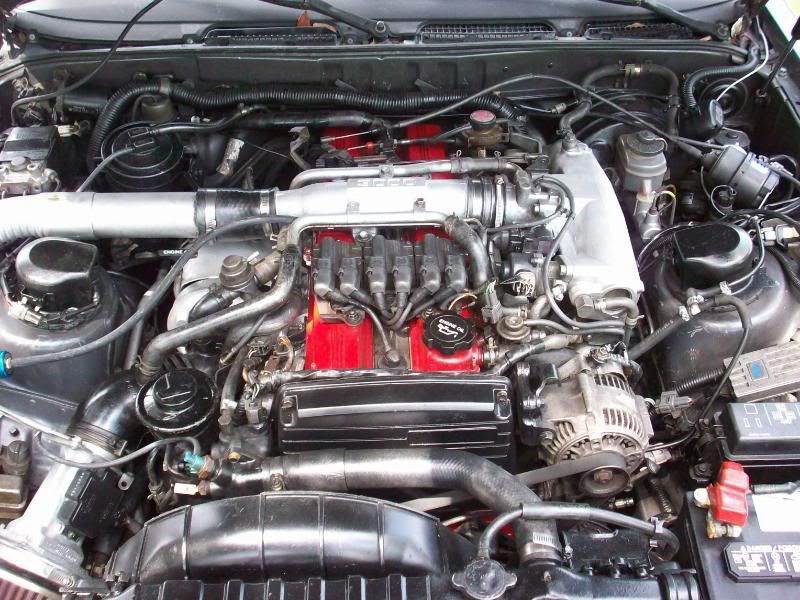

Pics to quench the thirst...for now.

Well for internals, you can get a set of NPR pistons that come with rings and pins from DriftMotion for $120.00 plus shipping, if you plan on keeping stock internals. The gasket set you have is a good one, I used the same. Don't use the oil pan gasket, it seals with silicone and make sure you used a good amount of it.

IBoughtASupra: The oil pan gasket is no good from the kit? Or can it be used WITH gasket maker?

No, do not use the oil pan gasket. Use Permatex silicone and use a lot of it. Be very generous....imagine you are about to have see all the Vagina in the world and have a chance to get every one of them, do you only want to bring on condom? Use a lot of silicone or you will regret it. If you don't you will be pulling the engine again to reseal it or dropping the front subframe to drop the oil pan and reseal it there.

you also do not need to use gobs of fipg on the oil pan. all you need is a nice bead that is continuous and keep it going and go on the inside of the holes. the bead soze only needs t6o be around 4-5mm as when you bolt it down and the excess rtv is just going to squish on the inside and out side. if you have ever looked at a factory seal the excess barely comes out at all. fipg or 3 bond works the best.
toyota never put silicone on the intake gaskets or any of that except in a few places like the front cam caps for the valve cover seal and the rear timing cover. it is not necessary if the surface is clean, straight, and you have decent gaskets.
IJ.
Grumpy Old Man
38,728
62
I come from a land down under
Only time I'll use silicone is when there's no gasket required, if there's a gasket I use Permatex #4 or #5, as Hvy suggested 3Bond 1207b is my RTV of choice, it's a little exe but is a brilliant product.

I just like to use a bead of silicon on the intake side for piece of mind. I use a light grade of emry cloth to polish the surface after I clean it with our parts washer. I am not loading the oil pan with silicone but I am not being greedy either. I once put a bead and well, it leaked and I had to pull the engine again to reseal it.
