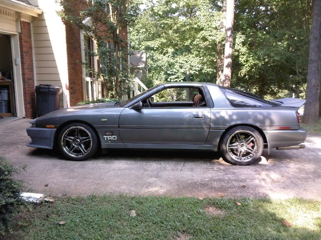

hmm would you happen to have a photo with the eibachs?

Eibach's, Tockico blue's, Suspension Techniques swaybars.
Mind you- This is only about 15 minutes after I put the new wheels one, and the car had been up for awhile, so the car prolly sits about 2-3mm lower than this.
If you want lower, get Intrax.
They ride for shit, but you'll be slammed.
Got rid of mine for the Eibach's.
