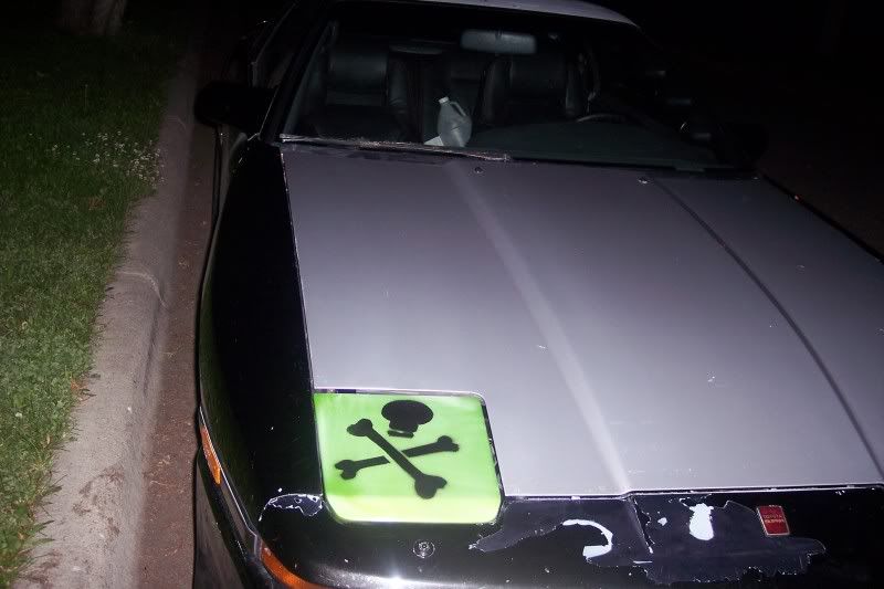

A friend of mine noticed something missing with my car and quickly fixed that issue.

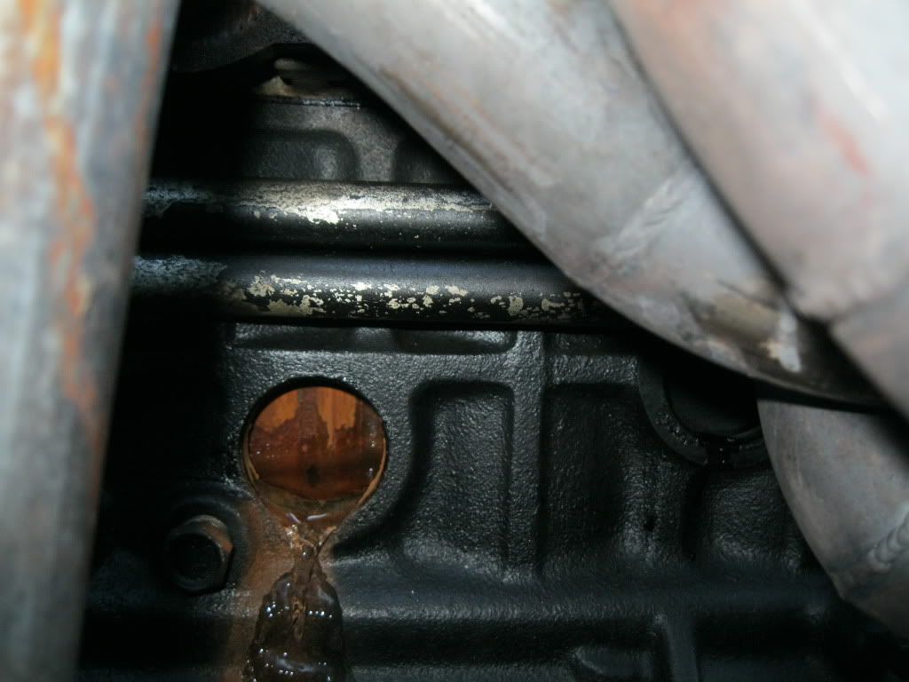

So today the frost plug popped out and the engine over heated and is burning oil like crazy.
Full part out coming soon I am done with the supra game, kinda drunk but definitely done with the 7m. I achieved what I wanted and a $2 part fucked me over.

...What the hell causes those to pop out. I've never even HEARD of that happening.
That seriously sucks, the car was running strong too.
And by out of the Supra game, do you mean you're getting rid of your car, or doing a V8 swap like you've been talking about?

Were the freeze plugs OEM or aftermarket? Likely a moot point after your past few posts, but a couple years ago a friend blew out some non-oem freeze plugs during a pull on the dyno. I believe he and several other members of this forum found that minute differences in the sizing of aftermarket offerings led to an increased likelihood, if not certainty of blowing out during use. Just a thought.

Happens more often that you'd expect :(
A lot of times how they're fitted makes the difference, an old old school guy taught me to get them in with the minimal amount of hits possible as a lot of small taps removes the crush fit.
Sorry to add clutter.
The plugs in question that were too small were made by Dorman.
The only aftermarket freeze plug that was properly sized was qualcast.
But what was on this motor, toyota?

An old old school guy taught me this as well. ;)
Talk about a complete pain in the ass. We realized we couldn't get them in with 2 big hits, so we settled at 5 medium hits and hoped the Permatex 1 will do it's job. ;)

No clue what brand, I pulled all the originals out before I brought my block in to the machine shop and payed for new ones to be installed. :(
