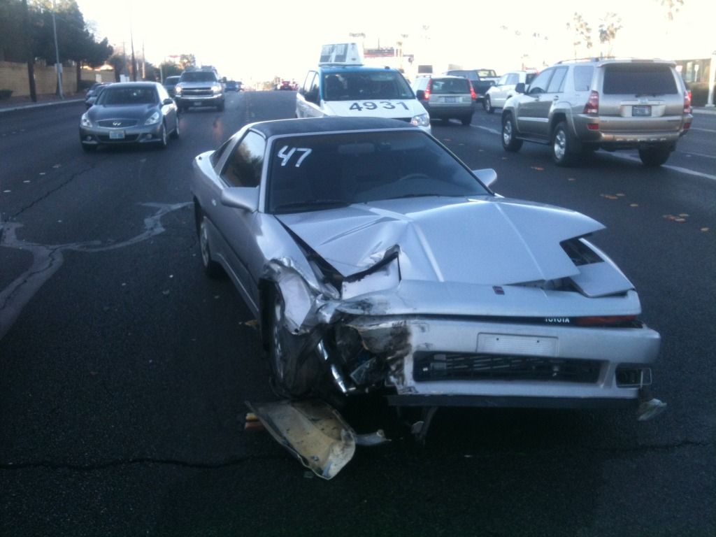

If you didn't see the other thread :(
Devin LeBlanc
Apr 7, 2010
1,830
32
Las Vegas NV.
Planning on getting a whole running car and just swap the motor in.
Well adjuster is coming tomorrow to look at the car so we'll see how it all pans out.
I did total everything up thats on the car right now and it comes out to 7824.45 in parts. That does not include the 100+ hours of labor I have put into it. Hopefully the insurance company can write me a fat check otherwise it wont be pretty...

That looks like it hurt.
My insurance was good about everything when my supra was totaled.
I believe they gave me 3/4 the value of the parts I had put into it plus the value of the car.
I bought it back for about $1000 and parted it out.
