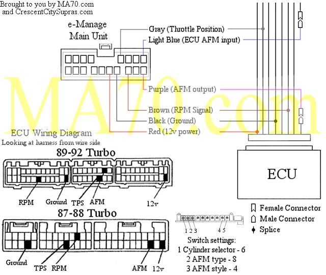

Emanage Blue UPDATE !!!
Using info from another thread about the Apexi SAFC/Neo:
http://www.supramania.com/forums/attachment.php?attachmentid=46955&d=1290357997
..and the diagram I already had for the emanage...
Emanage diagram:
...I have finally had some success with my emanage blue installation !!! Wiring for the ecu pinout is same as shown in the pdf, only difference is the emanage wires
are different color than what is on the Apexi unit. So using the two diagrams and connecting each wire 1 at-a-time, I was finally able to get my car to do more than idle with the red light
error code 13. It now idles with green light , and takes throttle, and compensates for my hks bov venting with the anti stall set at stock rpm @650. Progress right ?
It is in my book. The emanage does red light back to error code 13, but only after WOT...weird. I will say this, throttle response difference is HUGE ! My first initial drive with the
emanage finally up and running with a green light was quite inspirational. I laid twin trails of rubber in front of my house, at half throttle. Now as far as the error code 13, this
dictates incorrect wiring, or wrong jumper settings. I have checked both of course so I will be able to tell more once I find out why it is still throwing the code. I still need a dyno
tune, but I was able to set basic afr values with the support tool. Car still runs rich under boost, but not as much and I am no tuner by any means. I just changed the values enough
to make sure the emanage was making correctings, and I just monitored my wideband and noticed the not-as-rich readings.
The first link above should be a downloadable pdf for the Apexi SAFC/Neo. I am working on what my harness looks like using these 2 diagrams, so just bear with me and I will post up
what I have gotten to work so far.

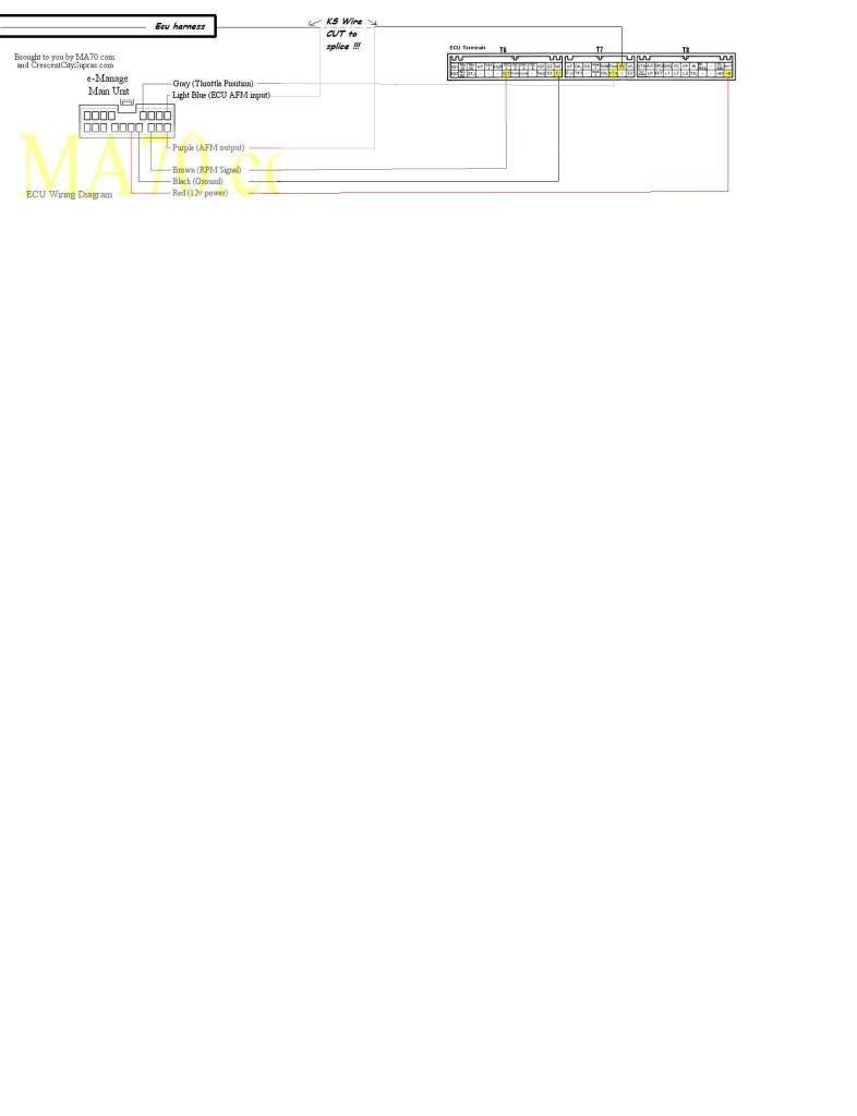

MKIIISupraGuy
Sep 14, 2009
639
Lousy-ana
Here is what I got, just remember the KS wire is the one you intercept and splice for the AFM signal. Follow this and your good to go.
Hope this helps the emanage blue guys out !
