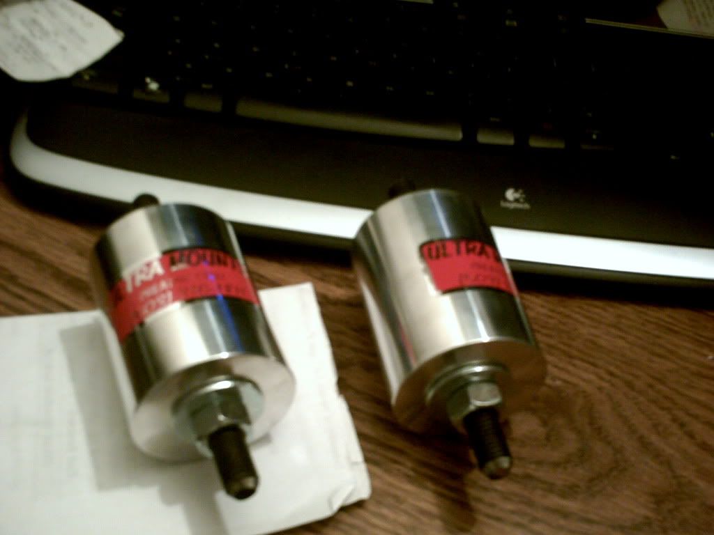

sooo i while back one of my motor mounts tore in half and fell off during a launch so i got my self some of these
never knew motor mounts could make a car sound so agressive. also installed some dual efans for the summer

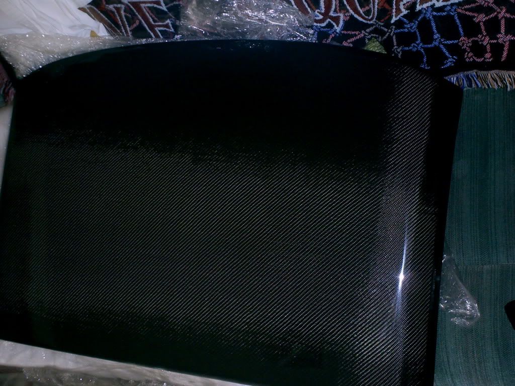

uh i forked over 250 dollars for the ebay carbon targa cuz my stock one flew off when i was driving :cry:
BIIIIIG mistake, i recieved it with a few chips and the thing has horrible fitment issues so i returned it

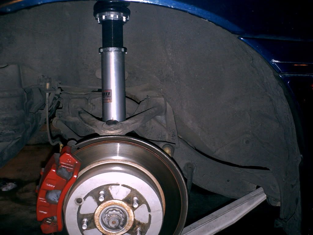

found a pretty good deal on some new megan track spec coilovers, 770 shipped so i couldnt pass those up,

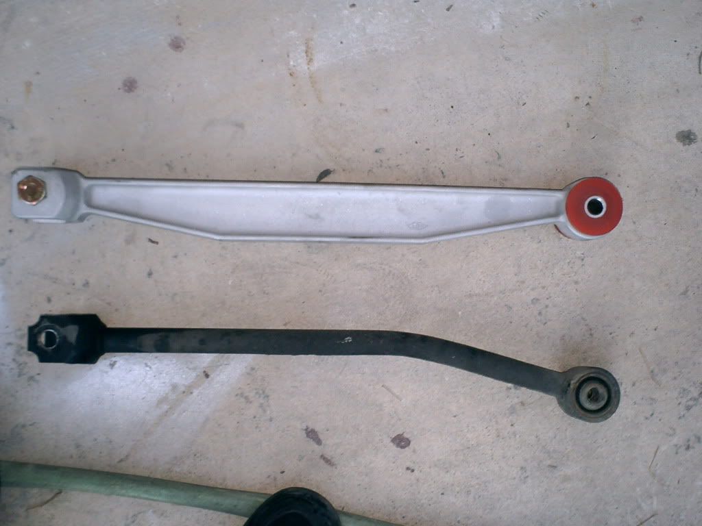

been trying to track down my wheel hop issue so i bought some new lipp aluminum traction arms for $175 :)

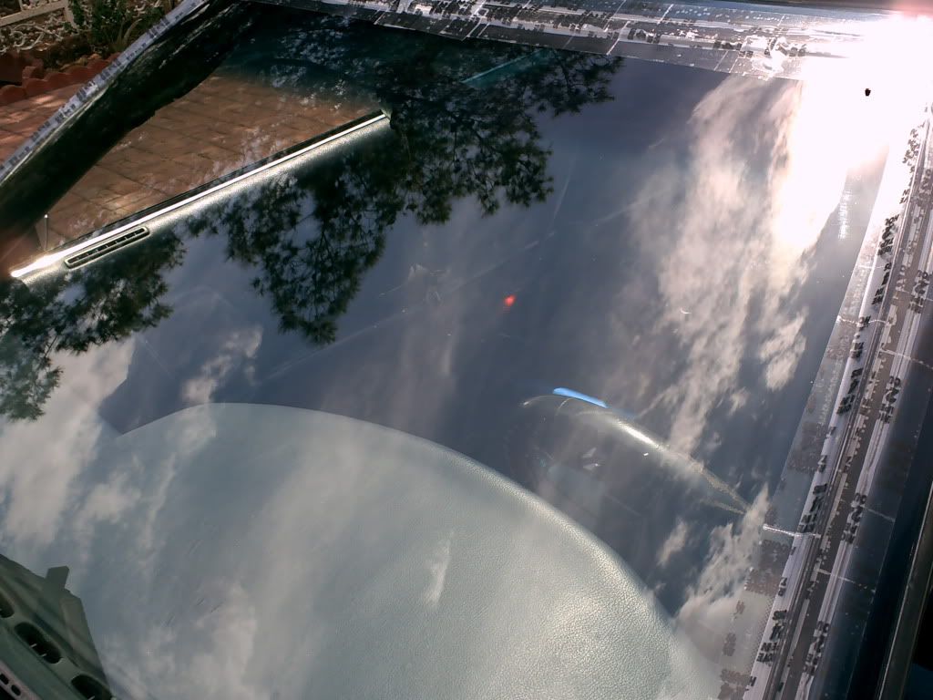

NO MORE CRACKED AND SCRATCHED WINDSHIELD, $150

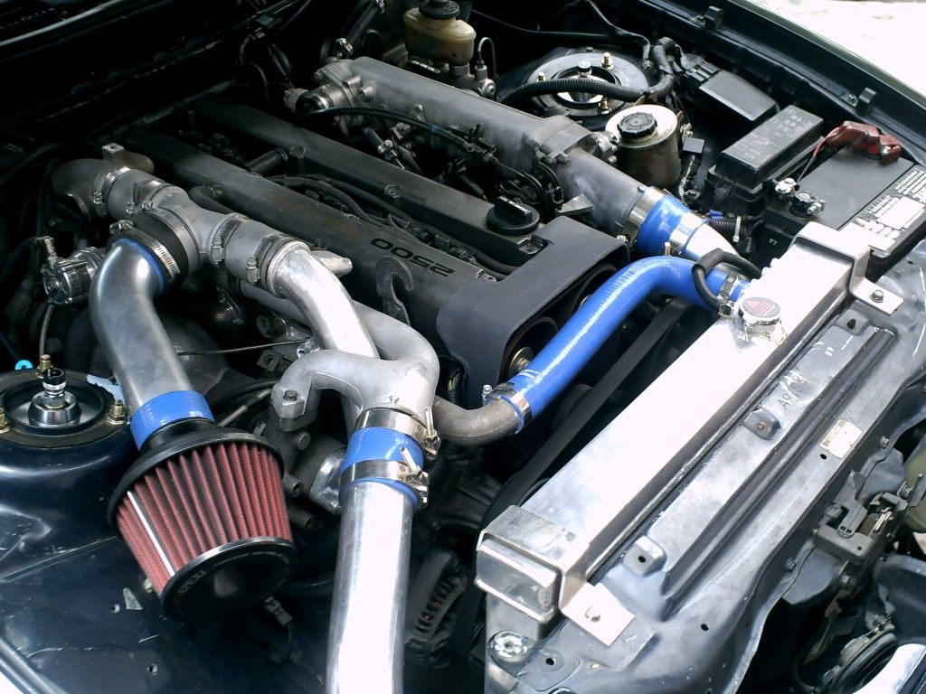

and engine as it sits recently, pay no attention to retarded intake

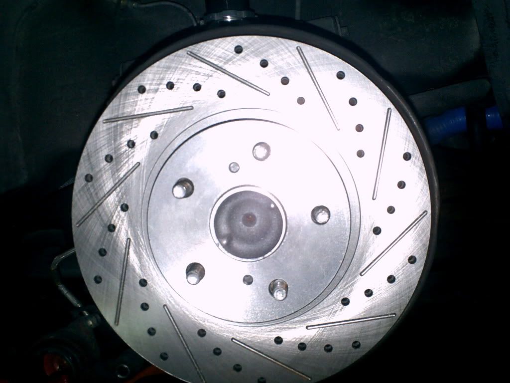

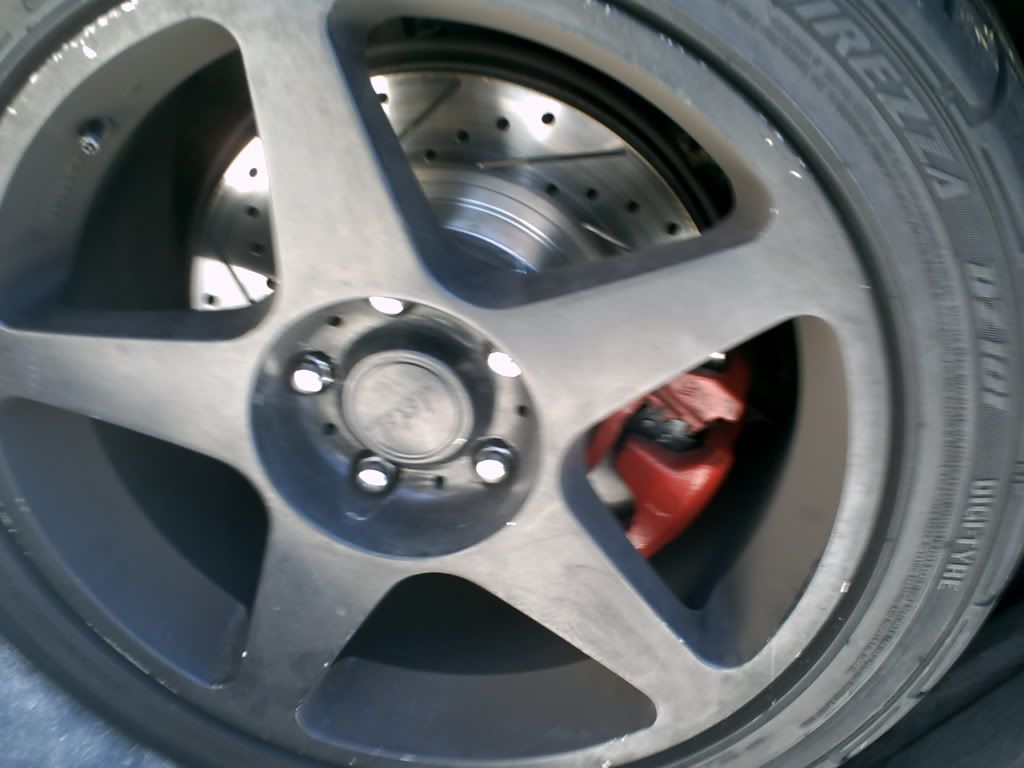

just finished up installin the new rotors and pads last night, im very happy with the results

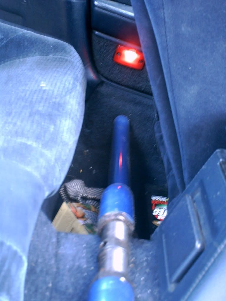

with this, the car feels stiff, and i hardly can tell the targa is off.

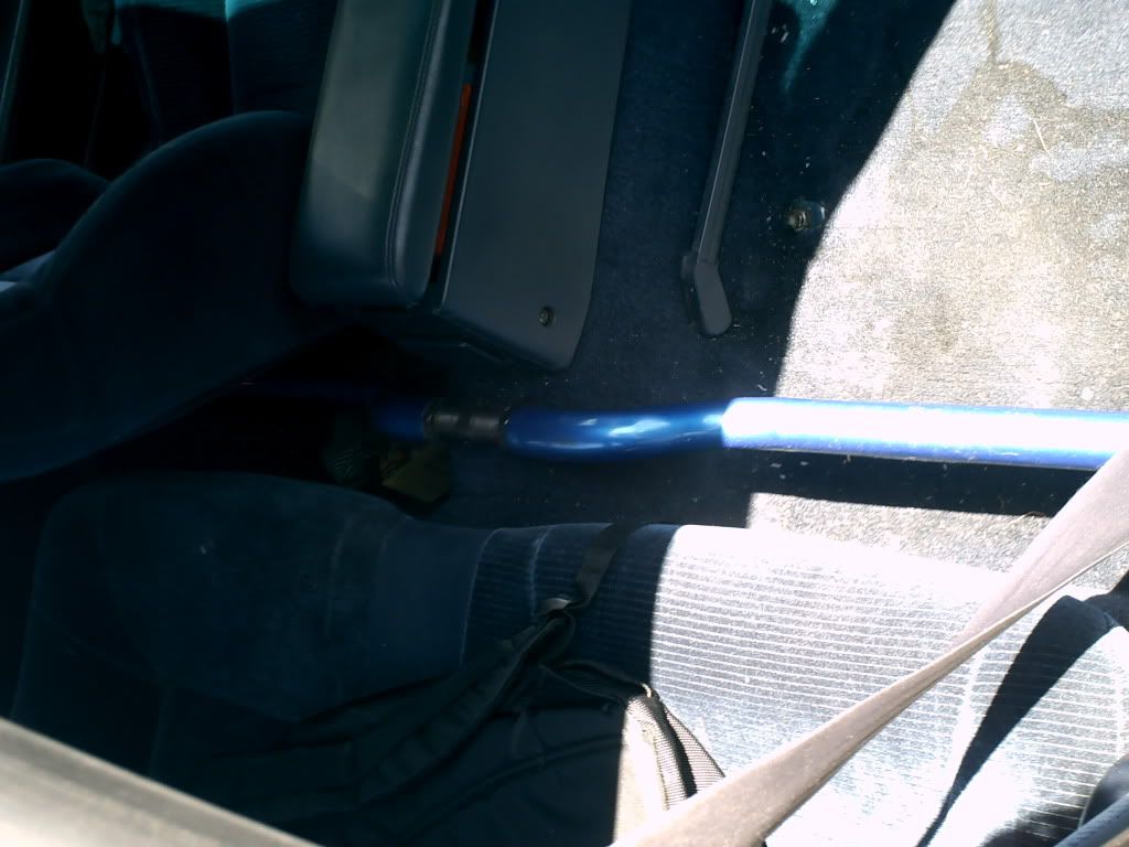

Doluck rear cross brace

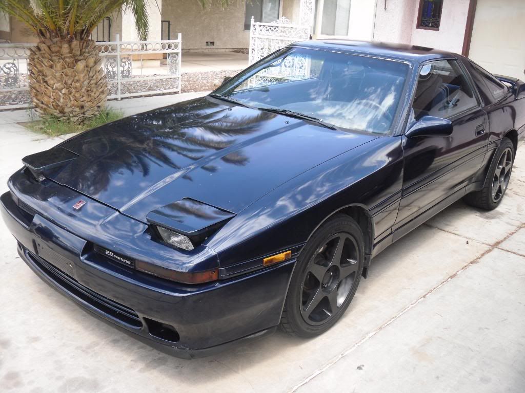

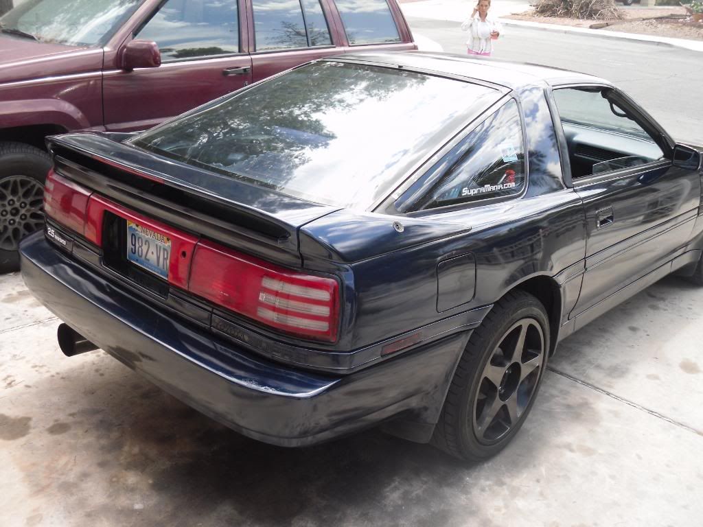

heres the car recently
next is some front tires, a diff ,some cams and maybe methanol injection along with all the fuel upgrades

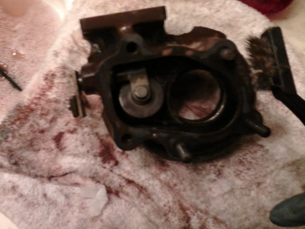

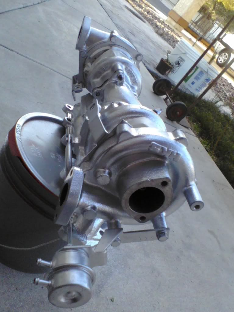

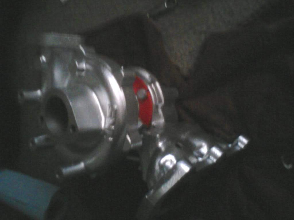

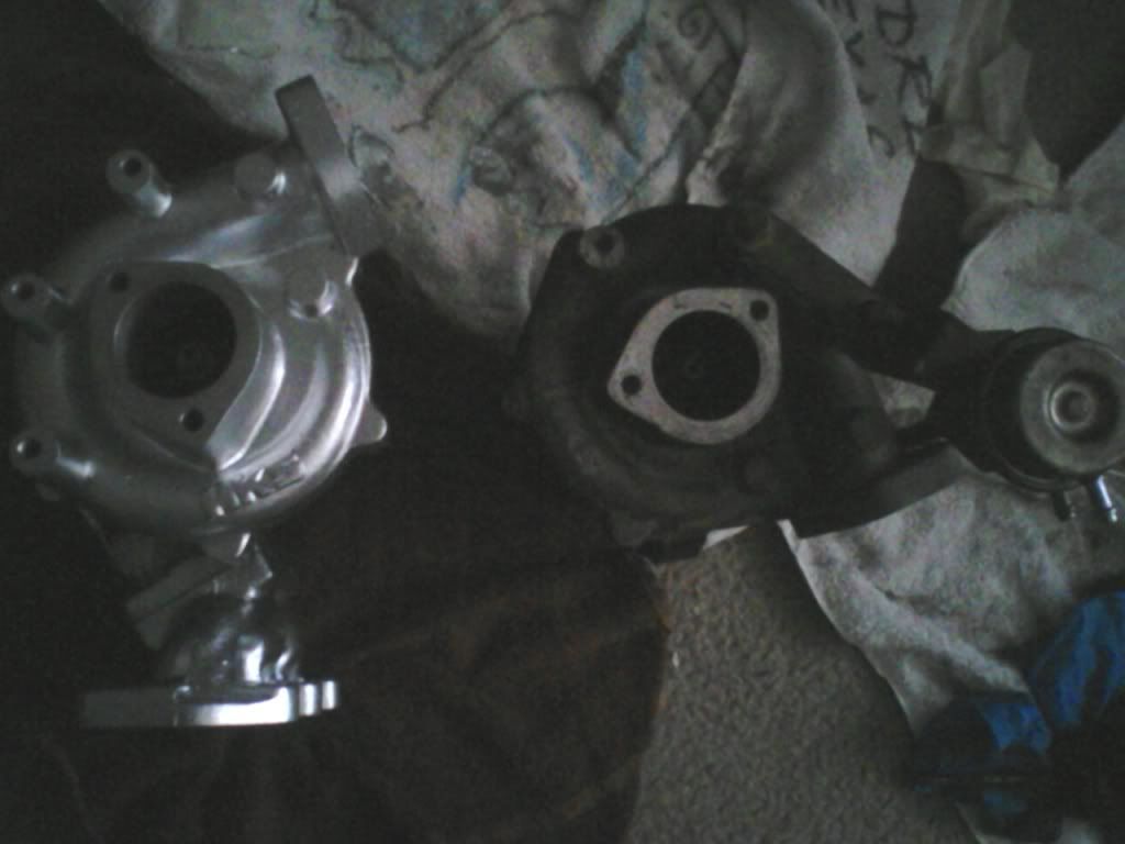

heard a weird noise from the turbos so i pulled em and decided to clean em and ceramic coat the housings. noise turned out to be a busted downpipe gasket
also, does anyone know what the second nipple on the above wastegate is for? wasnt connected to anything when it was pulled

nice car, i was and still am considering a doluck cross bar, someone had one at a local meet he said it helped alot
did yours come blue or did you paint it?

previous owner put it in so im not sure but it looks to be original paint
and i really dont feel much flex with the top off so its doing something :)

carter;1475874 said:
Do those sit on stock manifolds?
Nice lookin car man, love the midnight blue
But would you happen to have a video of you gettin on the car?
no videos yet and they are hks manifolds ,these have 4 bolts up to the turbo instead of 3

You do realise they were withdrawn from sale due to some strength/installation issues?
Be a good idea to isolate your Rad with some rubber under the mounts.

i talked to suprasport and they said that the fork end would snap because people installed the washers incorrectly and other than that they were fine, took me about 3 hours to get the washers in the right place but after that i havent had any issues or crack in it, and the mounts do have rubber under em i just need to but im still getting a voltage reading from the coolant and the battery so ima pull the rad and redo it.

Did you test with a Digi Multimeter?
IJ.
Grumpy Old Man
38,728
62
I come from a land down under
Digi's give an incorrect reading due to the way they work, borrow an analogue one then if it still has current go through all your grounds and make sure they're clean/tight.
A rad will only last a few months if the current is too high. :(
