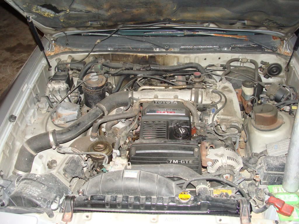

Here is the motor bay as you can see not very clean.
