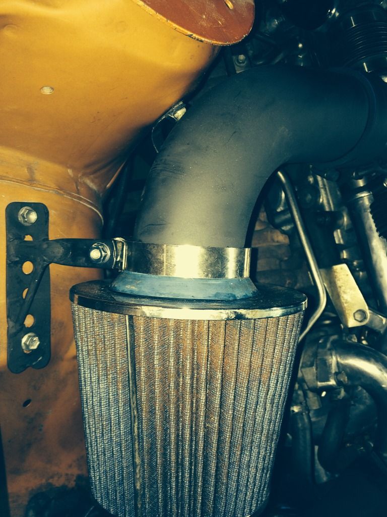

I started cleaning her up... polishing and painting with hi heat. the pistons were gunky which made me suspect that the vss were toasted...
For the meantime, I started mocking up the block after I made custom brackets.
Pistons appears to be OK after cleanup
Anyways, I replaced VSS with Ferrea 2jz VSS, lots of countless hours put in, made an r154 bracket, made the driveshaft work for now by adding a bracket to the center wheel bearing... refigured intercooler pipes, then had problems with huge air pocket with no water circulating, replaced water pump and thermostat. Now the end result.
[/URL]
Thank you for taking your time to look at my build thread. I hope this inspires everybody to not give up. I want to also thank my wife and kids for the support.
