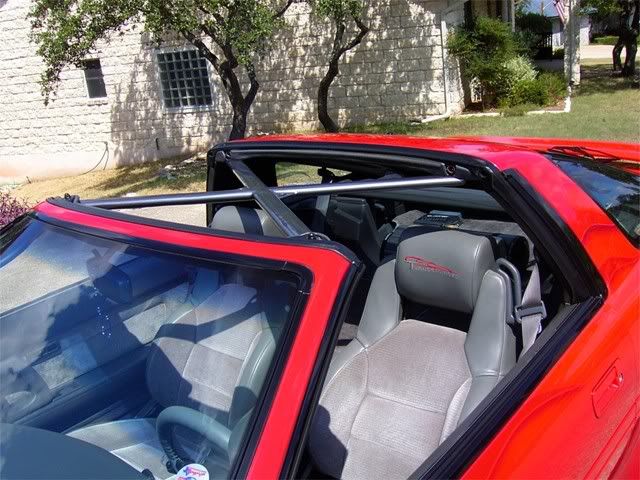

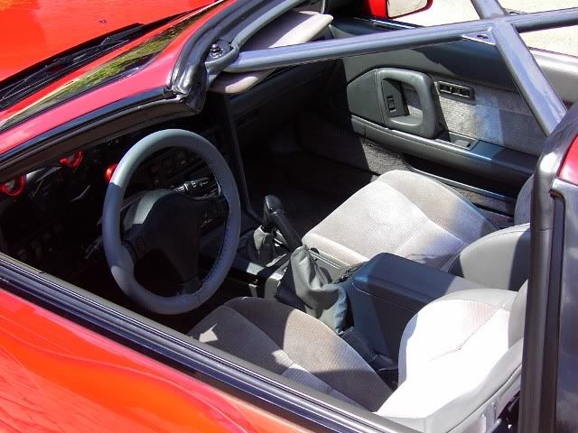

I'm not that tall (5'-8") but I have no headroom issues with the bar that Kyle built for me. I did have to modify both the front and rear headliner pans, then reupholster them, so I am very interested in seeing what you have designed Jayson.
I definitely wanted one that stayed on the car, that's why I bugged Kyle for a year or more to build me one, although I can see where alot of people would like to have what WeezL developed.
I doubt that you will be able to build anything more rigid than Kyle's bar though. But don't believe me, go ask him for pictures of his construction and how he built his flat oval tubing.
That is a gorgeous brace! I love the simplicity of it! Can you leave it in while the targa's in place? And what is Kyle's handle so I can ask him about it?

Thanks Neodeuccio, Yes the bar stays on the car while the top goes back on. It makes for another great "Oh Shit" handle.:biglaugh:
Kyle's handle is projectsupra, he's a real nice guy so I'm sure he'll share with you most of the details, but I don't think he will build anymore. They were way too labor intensive. For the flat tubing alone, he took 1" pipe and sliced it in half, welded it to the sides of 1" square stock, then grinded all of the welds down, and that was all before he even started building the actual brace. Before I painted it, I finished detailing it by molding in the welds around the gussets with fiberglass and bondo.
He's also the guy that built the T-Top MKIII using a roof panel from a Nissan Z, very talented individual.
