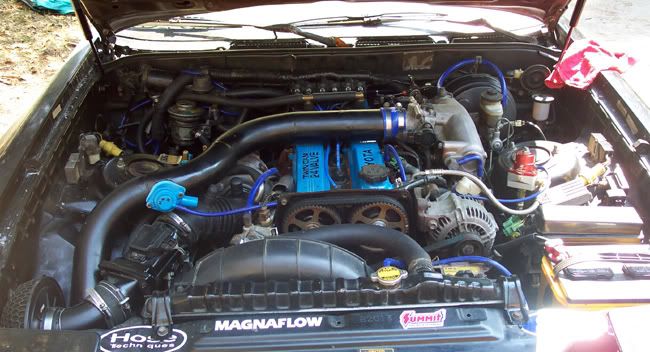

this is how mine is ran so far, i want to say that IJ said to add the 45 on the upper to clear the hot side of the turbo but this 3 inch piping only gives me so much room lol
the only downside to this is that i had to make a bracket for the coil packs and lengthen the wires for it, im determined to keep the BOV there lol

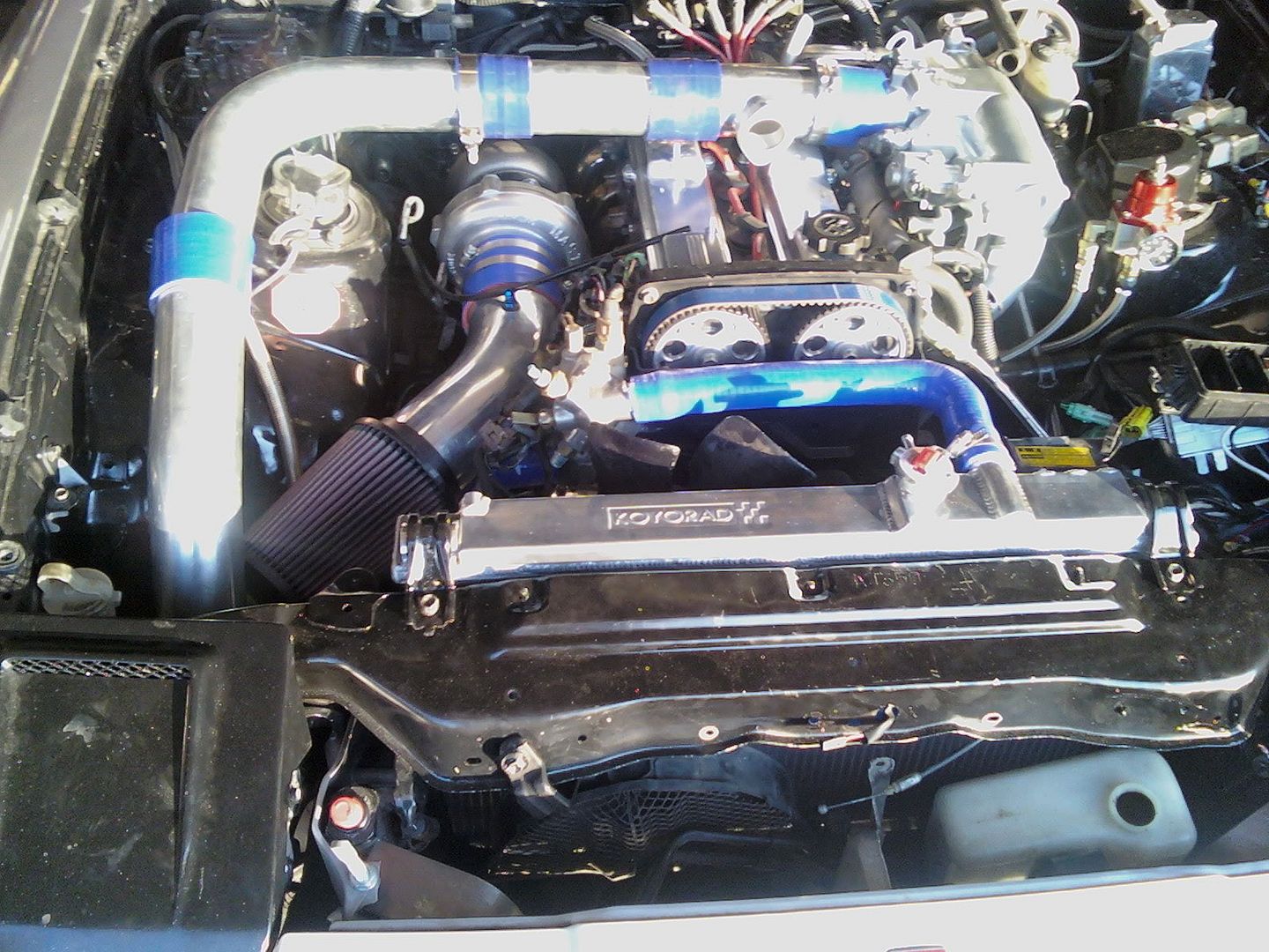

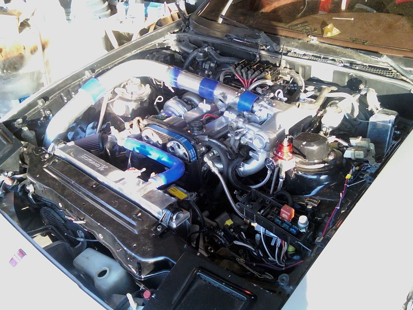

If you can't figure out the top pipe routing. I bought the HKS 3000 pipe and then used a 3 inch aftermarket pipe for a honda civic. It works perfect. Here is a pic of mine before I fixed the ISCV hose and went back to the stock cooling setup.
