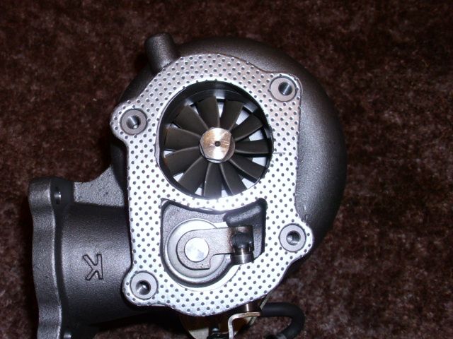

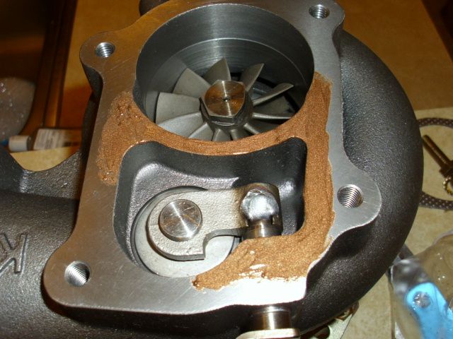

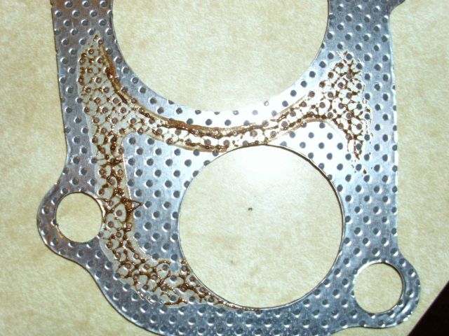

Was going to get my ct26 rebuilt/upgraded to a 57 trim but I found two hairline cracks on the wastegate port. Made an offer didn't really think CxRacing would agree to, but they did so here I am lol. Thought it had a 60mm compressor when I bought it, since they advertise it as "60 trim", but it's actually 66.6mm. I planned to return it but I liked it's truly divided wastegate and the thing really does appear to be pretty well made.. I spooled it up with my leaf blower and it spooled up nice and smooth. Seems balanced.. enough xD
I cut the gasket that came with the divorced downpipe so no useless parts of it would be exposed to the exhaust stream. Ebay gasket... probably would burn up over time, little bits getting stuck in my catalytic converter. Had some copper anti-seize compound lying around so I used that to mark where to cut lol. Dremel cut-off wheel was too big to make the curves so I used a drill bit in the tight corners and worked both sides of the gasket with the cut-off wheel in some parts (smaller profile if you're only cutting 1/2 way through).
Took a little too much off in one spot but it'll work. Going to glue it to the turbo with some high-temp copper sealant so it won't move around during install. Need it to stay in just the right spot.
