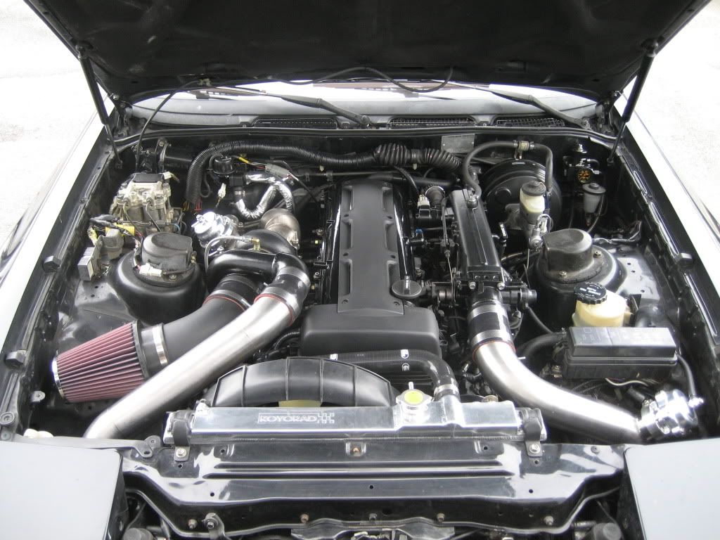

Nice Gix!! :icon_bigg

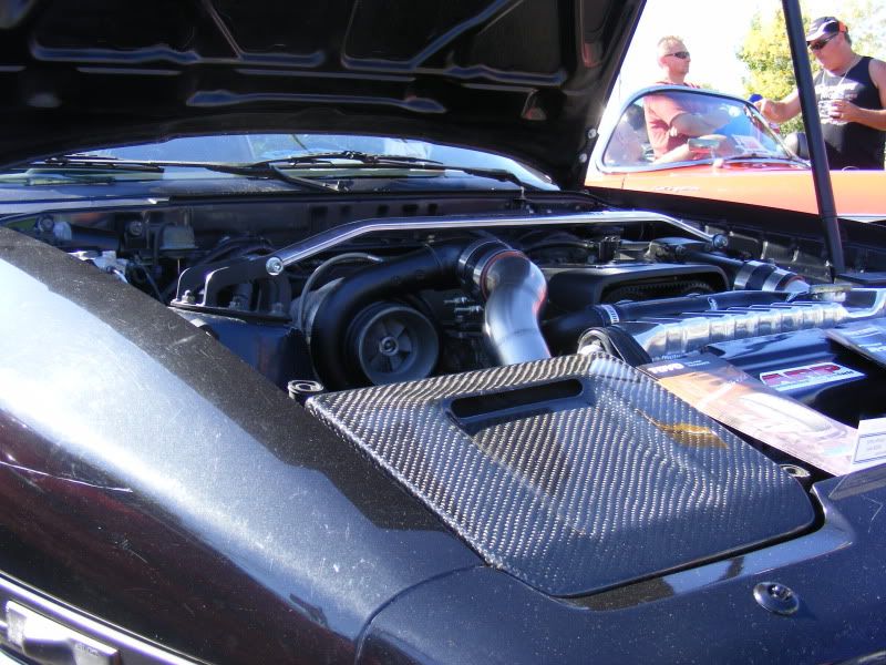

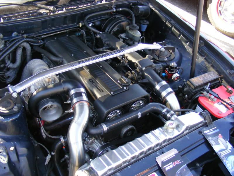

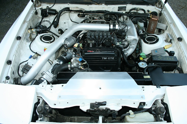

I guess I'll go next.
Now I know theres some controversy about progress shots, so let me say that these picture was taken at a car show. I could... if i wanted to for some crazy reason... start it up and make a pass down the track.
Theres still a few more things I wouldnt mind cleaning up.

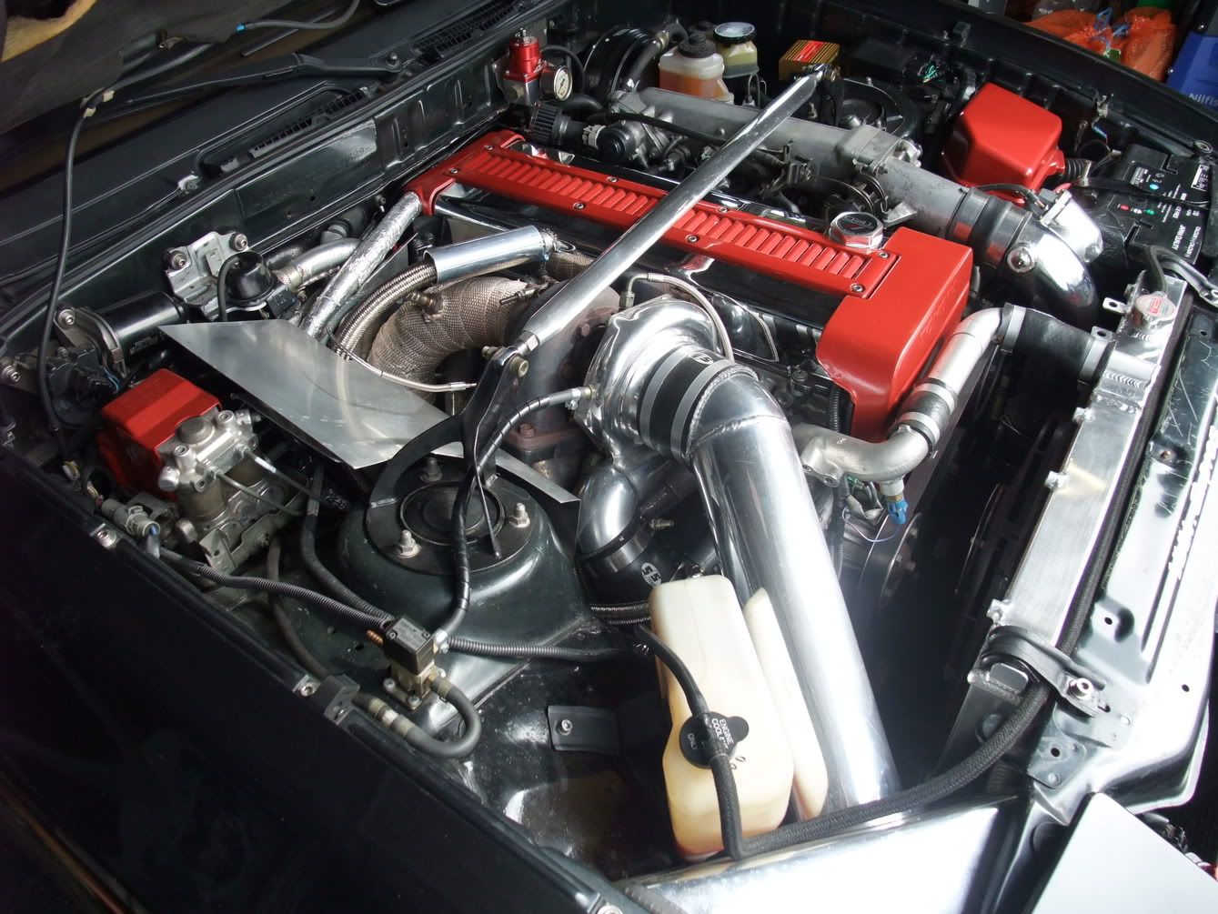

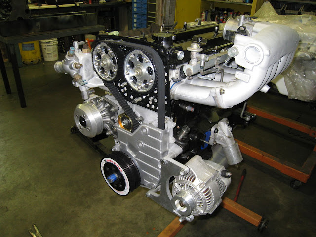

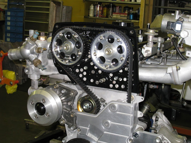

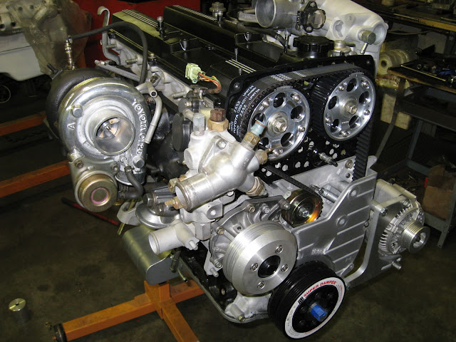

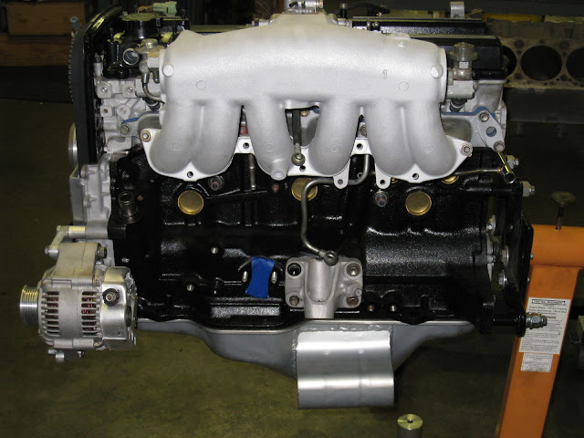

The engine is being built for enduro racing (6, and 12 hour) http://picasaweb.google.com/raceready7m/RaceReady7M?feat=directlink and has had moderate upgrades, not the best in the business, as this engine will not see more that 7500 RPMs and HP will be limited to 300 WHP, by virtue of the 50 trim CT26 (more in my build thread "Race Ready 7M").
Extensive head porting is complete and combustion chambers coated w/ ceramic thermal barrier. Cam caps coated with molydisulfied coating, baked on. Interior of the block coated w/a oil shed coating and outside, coated w/a black thermal dispersant. Exhaust parts are coated inside and out w/a ceramic thermal barrier, to keep the heat inside, where it can do more work!
Enjoy! Van

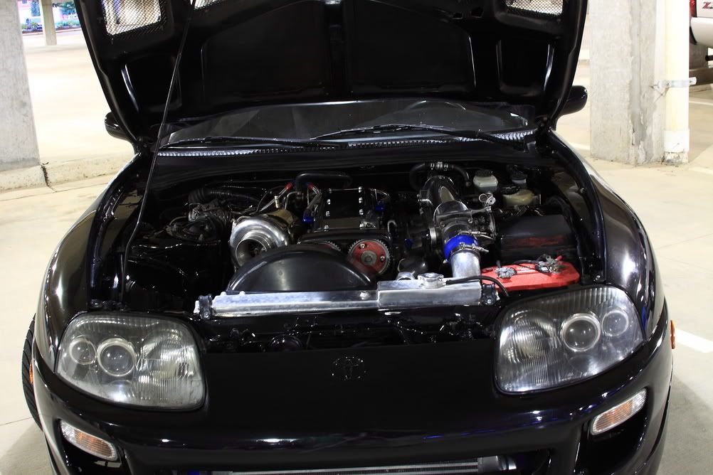

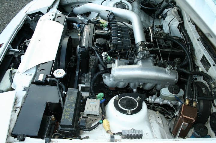

These are some upskirt pics of my supra, I hope they're elite enough. :)
After some years of trial and error it is now fully circuit-proof. Amongst other improvements to make it circuit-proof I've installed heat plates and quite a bit of heat wrapping. Btw, it's a 1.5jz

zurud;1516312 said:

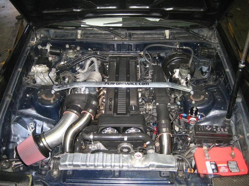

Nice wire tuck. Where did you hide all the wires and fusebox.
I did pretty much the same thing on my drag car:
You can fit most of it behind the dash on the passenger side. :)
dslocal
Nov 9, 2008
340
slo
yup. I made my own heater box/ventilation that is a quarter the size of stock. opened a lot of room for wiring and then the fuse box just went into the fender.
