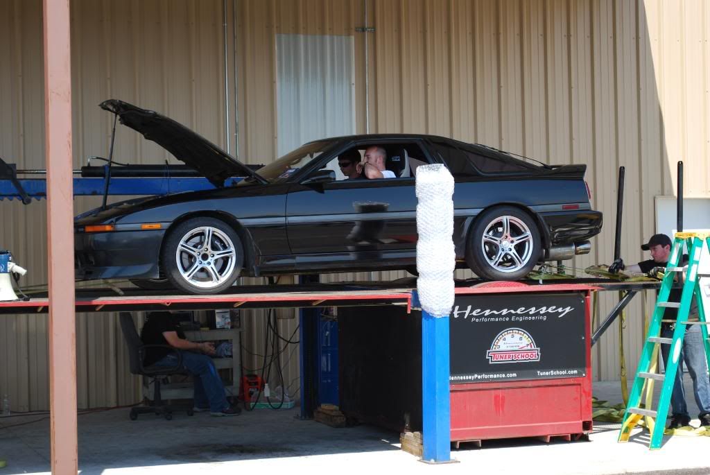

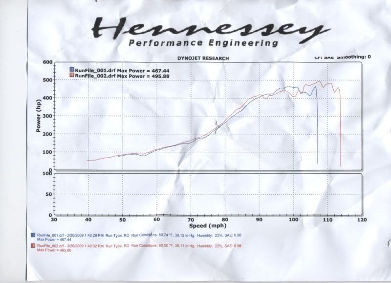

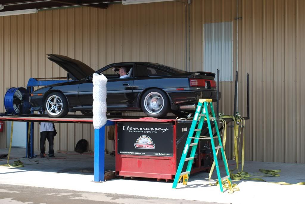

So we took my car to TX2K9, dyno'd at 496 hp, it definitely has more in it. We only pulled to 6k (built for more) and it was cutting out up top with the boost around 25.

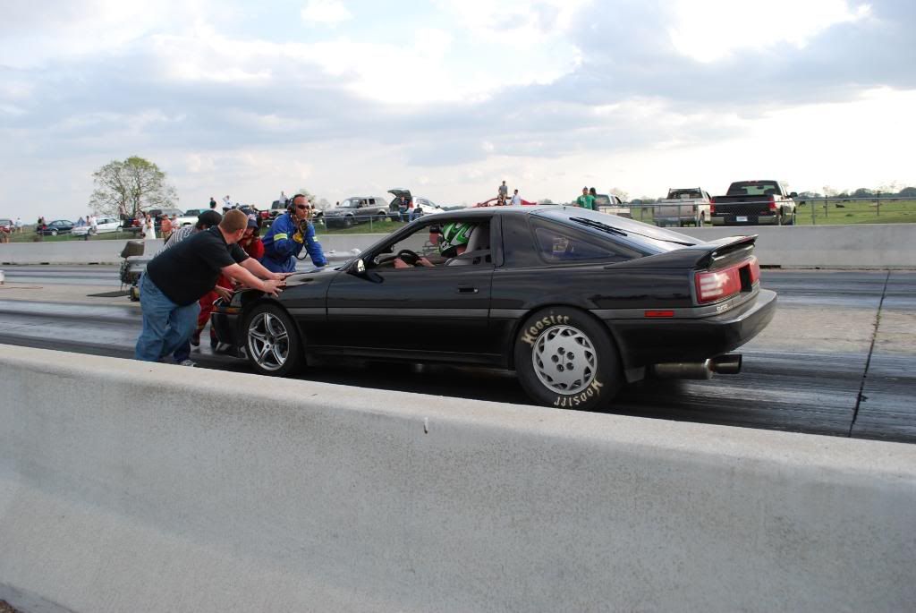

Then, in the actual competition rounds I had a by run... and of course right after I did my burnout and rolled up to the tree it would not go into gear. I fought it, turned off the car and then it went in and I told the guy "hey its working now can I go?" He said "sure but your time won't count." So I started the car and then it would not go into gear again. We had to push my car off the track and back to the truck
Thanks to everyone who helped push my car off of the track and back to the truck - I know there were WFO guys pushing and jugodegolf was helping too, and thanks to Fred AKA bigdough666 for the pics of my car on the dyno and being pushed off the track. Thanks to my girlfriend Amber for the cool vids.
