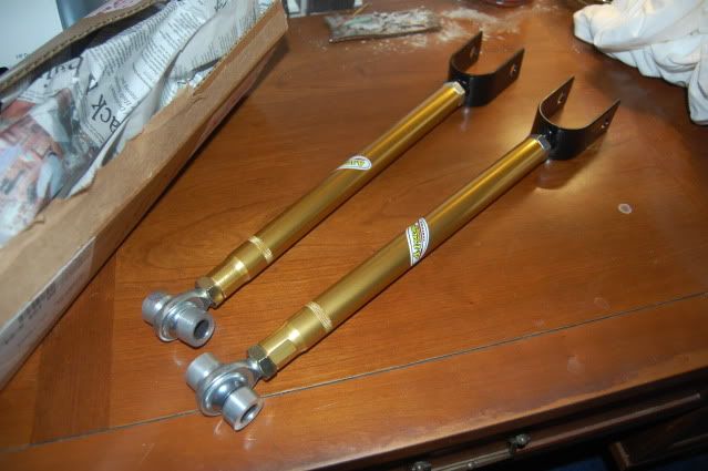

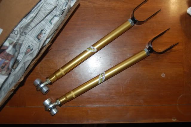

A1-racing adjustable Camber Arms arrived yesterday thanks to horsepowerfreaks and A1racing

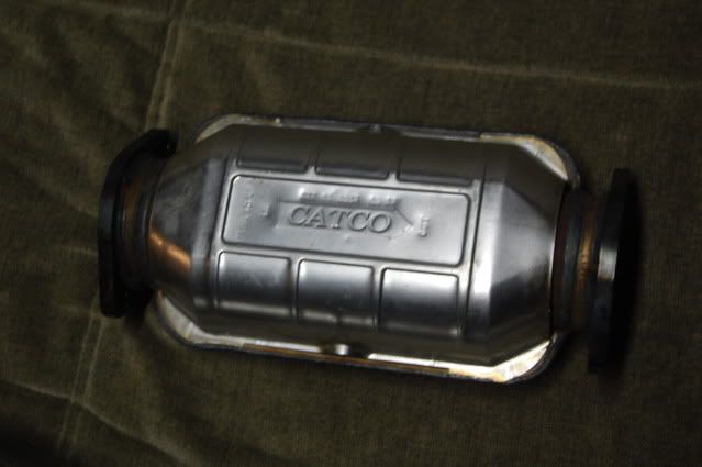

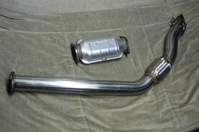

Some new parts came in today thanks to JSCspeed.com :icon_bigg
TMS 3inch downpipe with flex section and TMS catco direct fit cat

Here were some of the part issues:
1) A1 performance=CRAP DO NOT buy from them the trailing arm rod ends did not have enough thread on them to fit properly and I still haven't had time to call horsepowerfreaks up to figure this situation out.
2) TMS downpipe= CRAP DO NOT buy this downpipe it hits the transmission

The reason the dp hits the tranny is because the pipe points straight back and the exhaust angles to the drivers side. So when you bolt the two together it kicks the dp into the tranny. Since your running a convertor you could have the downpipe bent some if theres a shop that has a bender.
Did you have problems getting the two lower nuts on at the turbo? especially the one towards the block? On mine the nut hit the pipe and weld. :3d_frown: Takes around half an hour to get two nuts on.
I agree, this dp is the biggest POS I have seen. I dont know how they can sell any without getting every buyer bitching about them. I wish I wouldnt have let them talk me into not sending it back.:nono:
