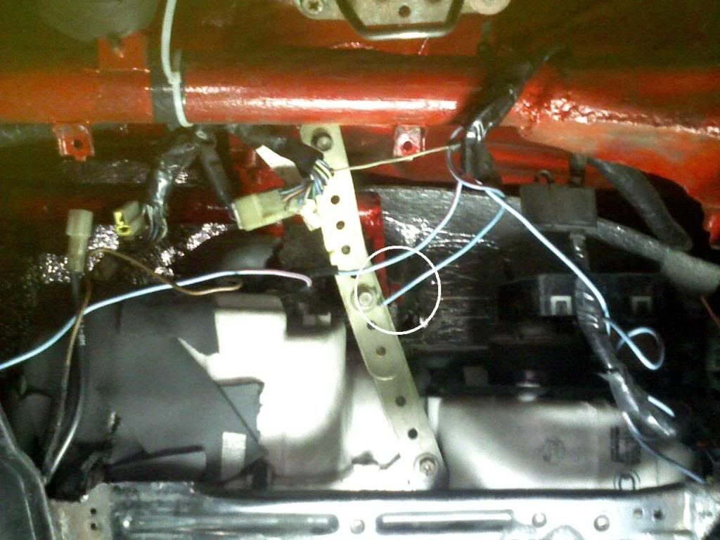

haha sorry for the late reply.. but il explain... this is really my build. the car is a RHD to LHD convert you see filipinos do all kinds of stuff to cars like chopping the dash in half and switching sides on everything patching it back together and switching arround the seats so the driver currently on the left side may enjoy the power seats, also making a rod across under the dash to facilitate braking so the firewall doesnt have to be cut in order to transfer the brake cylinder.
but this is an old convert when they newly started converting the JDM cars thats why its a lousy job. recently converted cars you cant even notice they are converted unless you spot the welds on the firewall. or the angle of the sidemirrors and headlights or gauge cluster.

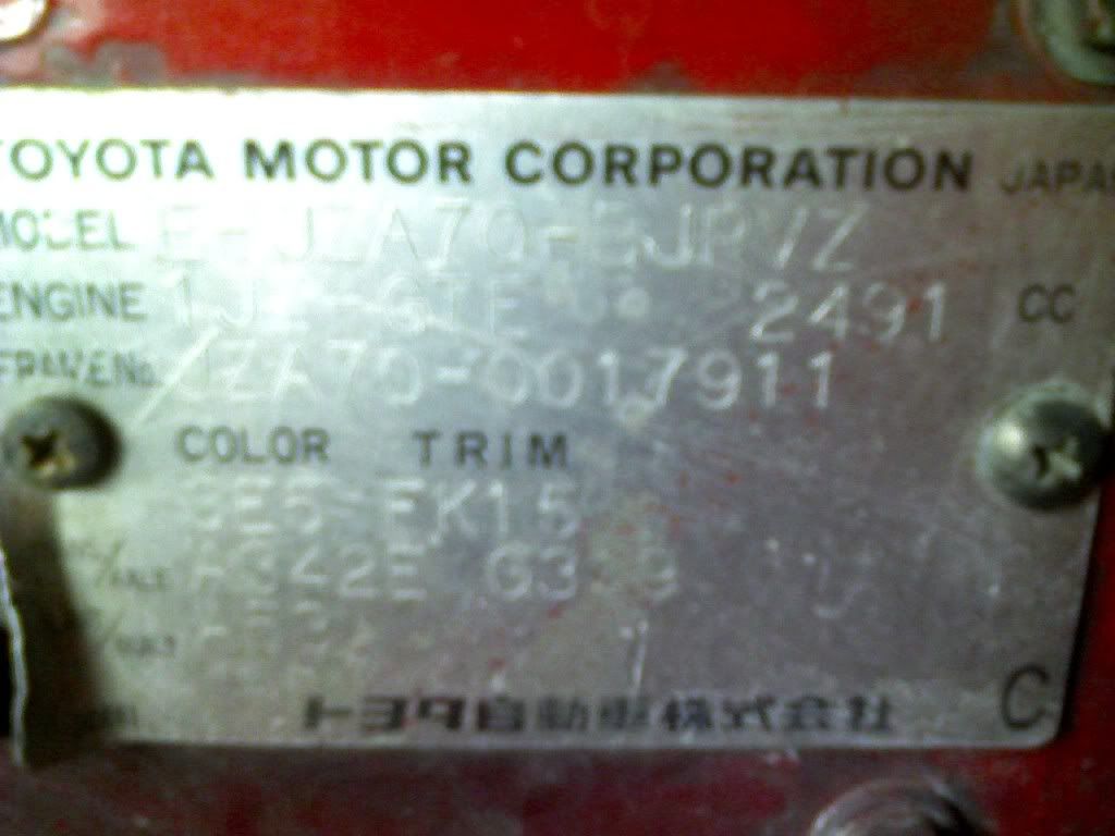

if you want you can check the chassi no. the car was imported from japan and converted.

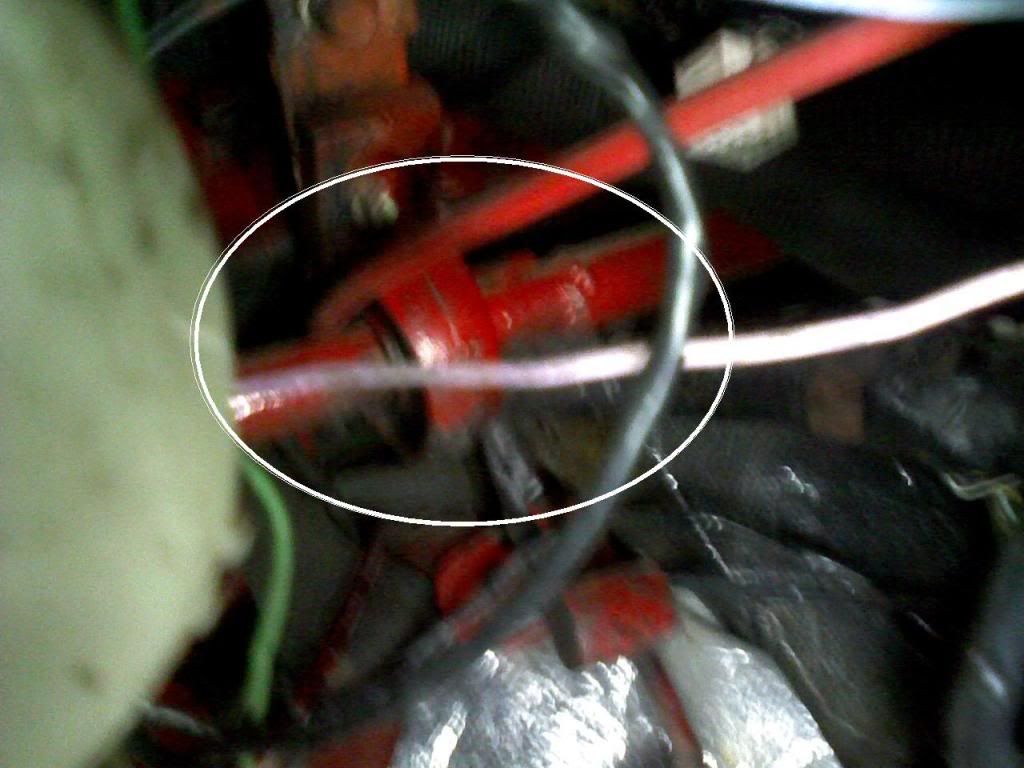

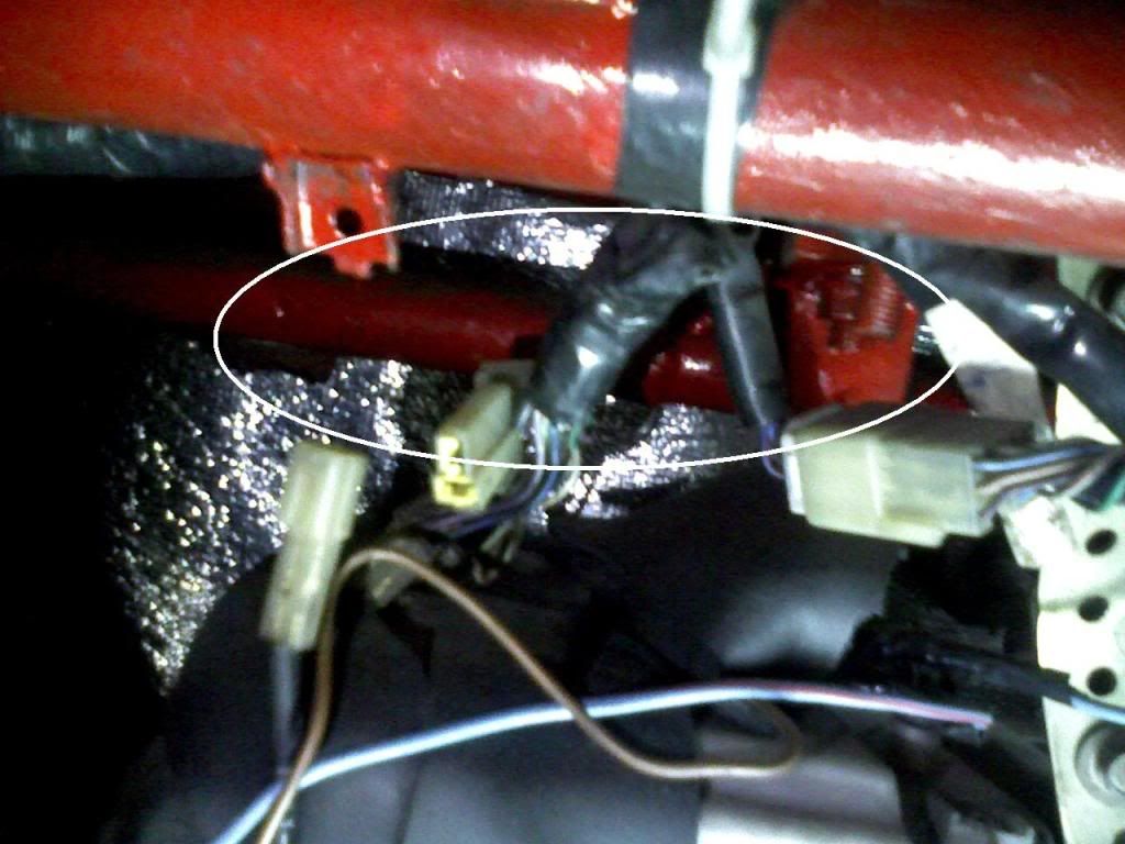

here is a pic of the rod from the break pedal, across the dash to the drum at the right side.
i know it illegal acrording to american laws and its unsafe but hey, its the philippines.lol
