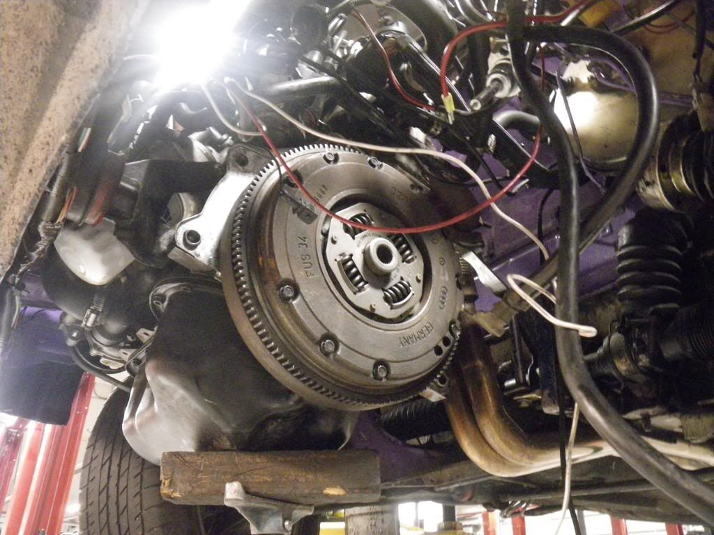

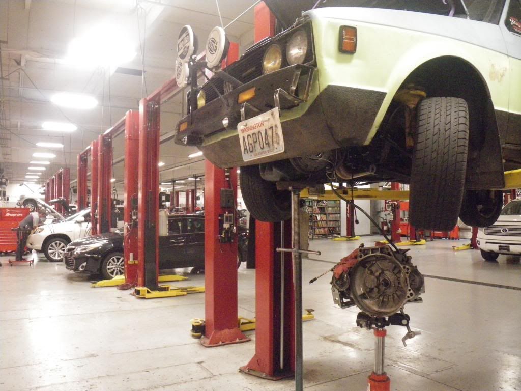

On a more positive note, I have sorted through the quirks of the Rabbit. She's making a pretty fun, economical daily driver! I somehow managed to convince my boss to let me do the clutch on her at work on Friday.... (not on the clock of course!!) Turns out a bad input shaft seal was the cause of my woes. I was surprised - normally I am so good at replacing EVERY. SINGLE. LAST. STUPID. THING. when I have a car apart that much..... must not have though about that seal.... bye-bye practically new clutch... oh well.
Fun pictures just to stick something on my build thread!! :D
the inside of Broadway Toyota.....

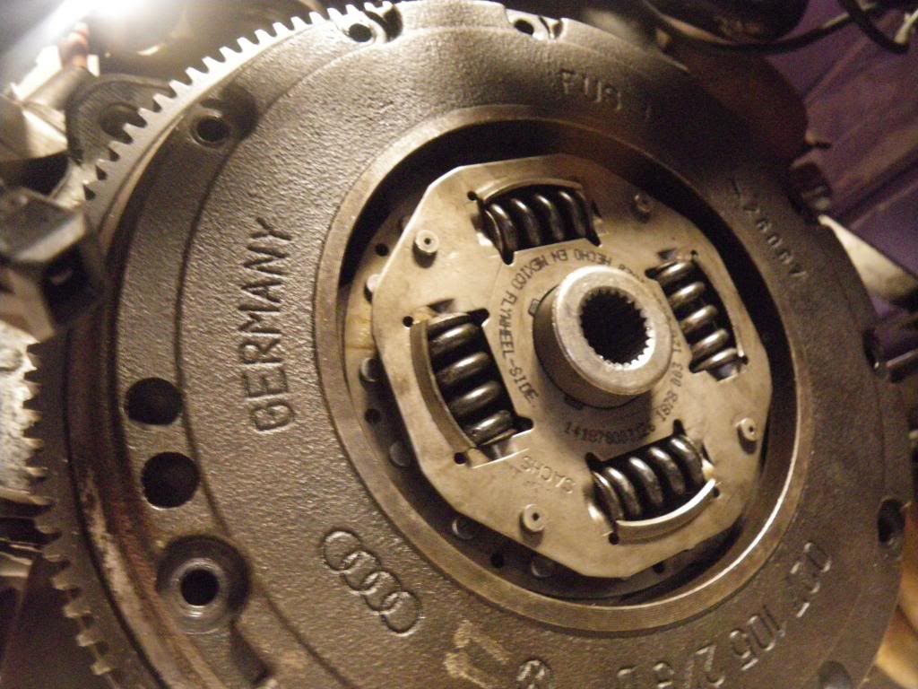

She got a lot of attention.... surprise surprise... I had more than a couple people comment on a particular part of my clutch job.... anyone got a guess??
Here's a hint:
Thursday is my next day off.... Hopefully they will let me stop on by then and set up that damn frame straightener... I am just dying to get my hands on that thing.....

its usually quite dark during clutch jobs in your defence, it functioned in that orientation?

OKay.... I see you all give up. Toyotas have the flywheel bolted to the crank.... VWs have the flywheel on the trans side. Looking at the clutch "flywheel side" label... that would be installed backwards on a Toyota :D
