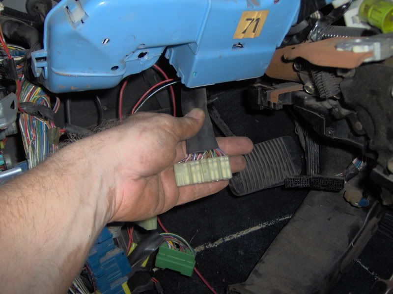

Not all pre 89's are pre wired for it. My 86.5 na was not and my 87 Turbo parts car was. I had to swap the entire body harness from behind the dash so I could have it, and it was a bitch. I think most turbos and some na's were prewired but it's easy to find the plug. It's great to be able to read your codes off of it without leaving the comfort of your drivers seat. :) Here's a pic

SupraOfDoom;1020975 said:
I hope mine has the harness ( I haven't checked )... because mine should be here tomorrow.
What does the harness look like? Just the same one behind the dash w/ an extra plug or what?
The harness is the white plug in the pic, above the pedals. I don't have one installed, but luckily my car came with the harness for when I decide to put one in.
