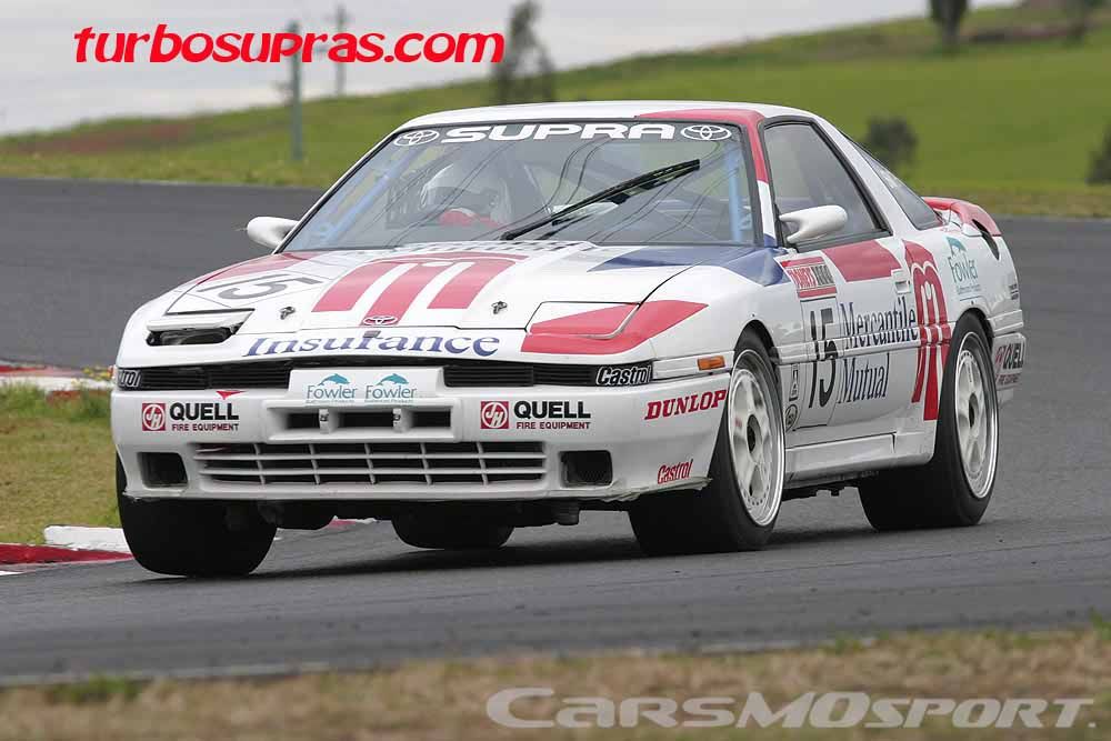

Based on looks, camber is needed to fit crazy offset wheels; If you want to wear out tires, and you are ok with that oh well. It's your money and your car. From a handling perspective camber helps to keep tire contact patch during cornering. look at pic below. How do you think that Supra would do with .8 to 1 degree negative on that turn?
Some of us don't drive in strait lines only. Im not all about drag racing my Supra (boring) Some group A Supras would run - 6 degrees of camber to help with optimal tire contact patch under hard corners.
I find it, that running negative 2.5 to 3 degrees gives me the best handling for the street on street tires. It doesn't yield the best tire wear but it makes me happy wile I out corner and out handle all wheel drive cars ( EVO MR, EVO 8,9,10 and STI's) If I see the inside wearing a little bit uneven I just flip tires from left to right from wheel to wheel.
If I drive hard enough I can get a tire with - 3 degrees of camber, 0 toe and max caster, wear even all the way flat, sometimes i can get the outside to wear more. :naughty:

ok. does anyone know the wheel and tire specs on this car? this is exactly what i want to do with my 90.

This is a Factory Race car ,used by Toyota Team Australia and currently owned by John Smith. As such wheels are the best that money could buy -> 18" single bolt ,custom offset ,magnesium wheels. Rim width was regulated by the Group A rules and was 12".

gsxr141;2007179 said:
the fitment is PERFECT!!!!!!!!
Perfect ,but only for certain range of front camber ;) Of course noOne ever run more negative than =4 in competitive Motorsport events because there will be no breaking but the group A supra race cars looked quite cool even tough they were terribly slow because of the 7m.
