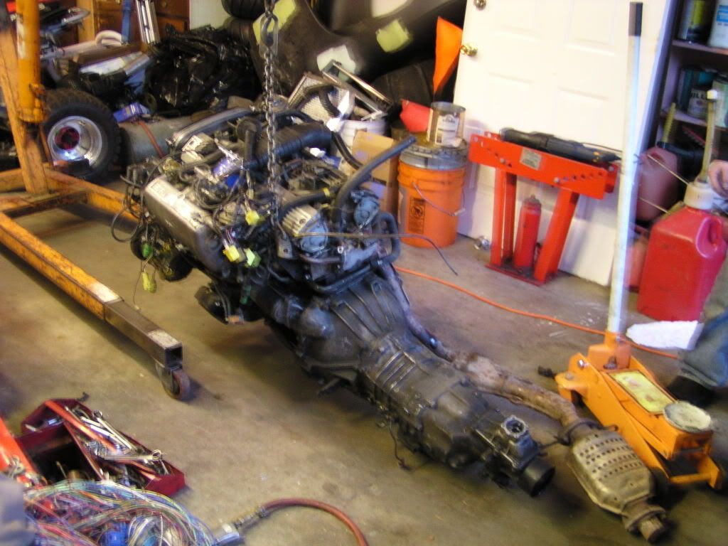

well guys, i kinda lacked off on my old build thread, got some tickets, and pulled the motor out of the car, swapped out the broken tranny, and left my motor to chill.
I've pulled some strings, and gather some fund's and this is what i have :love:

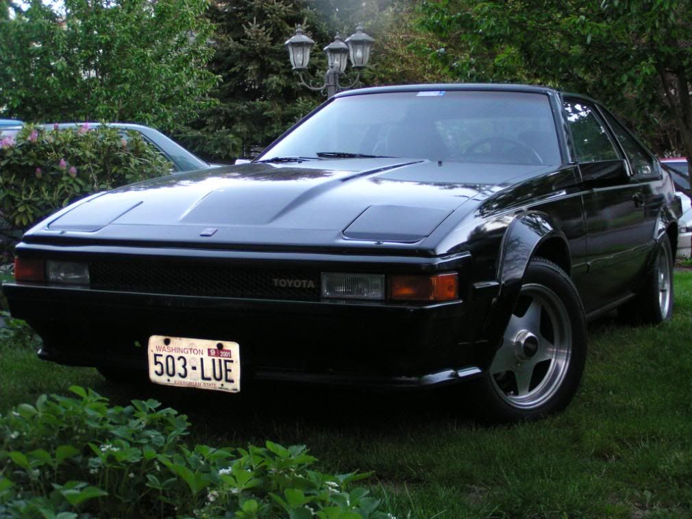

i have recently (well about 6 weeks ago) picked up this black 85 P-type celica supra, the car is a re-spray, 5spd, 4.30 lsd car
i paid 1200 for her, and motor ran alright, didn't over heat, just ticked and missed, when i test drove it i swear the missing went away.. either that or i was just blinded by lust for such a sexy car.:sarcasm:
the car has been driving me up the wall though, after i bought it it started to run worse and worse, and miss more, really feeling like i bought a sexy lemon...

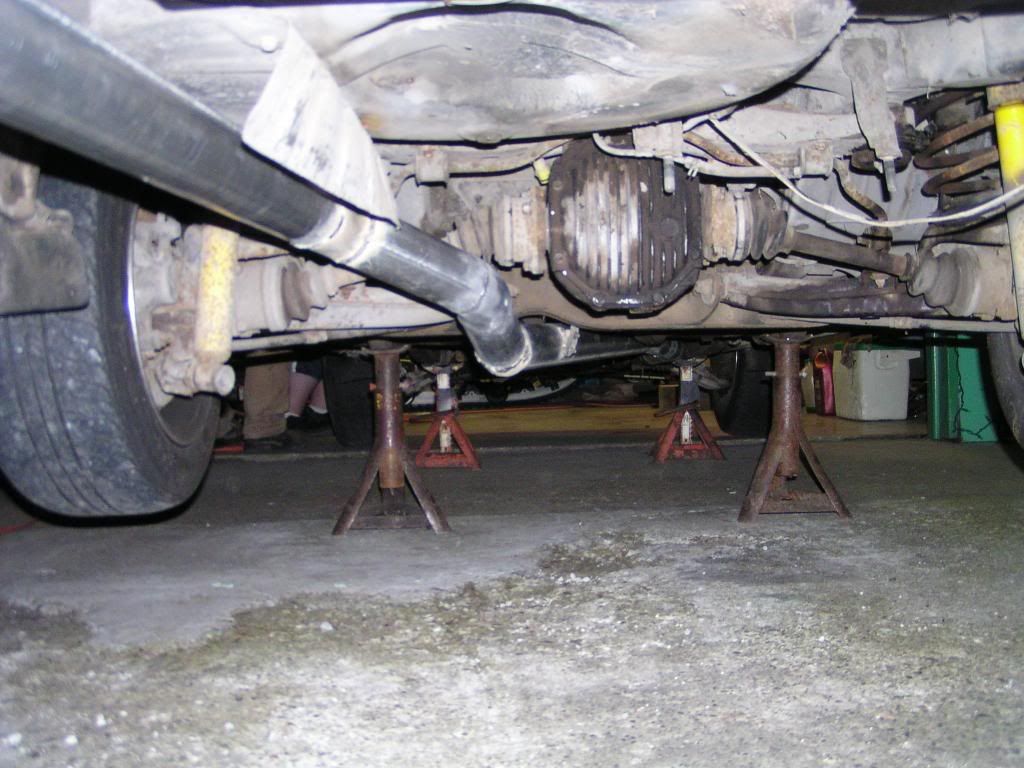

i figured out the drive shaft tonight for the r154 swap.
if you just need it on the road and dont or cant have a shaft made, you can use a mk3 front half of the drive shaft with a center flange from the stock mk2 drive shaft and use stock rear shaft.
obviously if your u-joints are bad in the mk2 rear shaft, you might consider a 1 peice , or even a newer mk2 rear shaft.
now i've looked at this route and probaly will go this way untill the rear end gives.
if you have a 1 peice made, you use the mk3 r154 or auto drive shaft, for the front yoke, you have a drive line specialist cut & balence the shaft.
and use the rear mk3 flange with joint,
doing this will upgrade you to larger flanges and u-joints, and a kicker of the u-joints are removable.
for the rear flange, so far what i have figured out is you need to disasemble an mk3 drive line, pull the center flane off the front shaft, and pull the dust cover off using a punch and hamer, just need to walk around it nothing drastic come's right off.
i belive this part still need's finish work, im not sure if it's the right O.D or smooth enough for a seal to work.
but it does Fit the MK3 U-Joint flange, And the MK2 pinion spline.
i have also read that trucks came with the right diff flange for the mk3 u-joint and the mk2 diff, but the truck diff i came across has 4.10's in it and has the same flange size, but is the wrong spline ID. it was from a 87 4wd p/u rear diff.
sum it up for you guys, I HAVE A WORKING DRIVE SHAFT!:biglaugh:

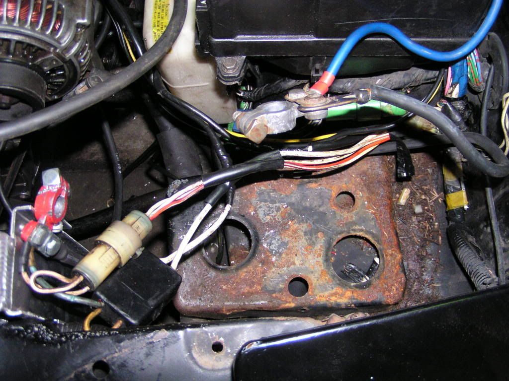

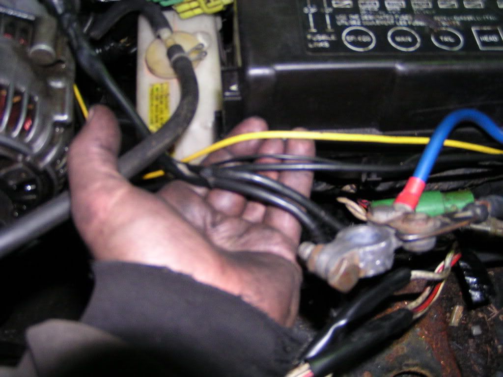

Altenator wire's
they wire straight in, just have to mod the location, when you have the fuse box taken apart for wiring up plug C1 you will find it a good time to wire in the alt too.
here in this picture i solded the Large charge wire off the stud to the main white batt wire, i keep it on the same side of the fuse it was, and the pigtail i used had 2 black wire's coming off it so i connected each end to the white wire end's i cut. kinda look's like a wish bone.

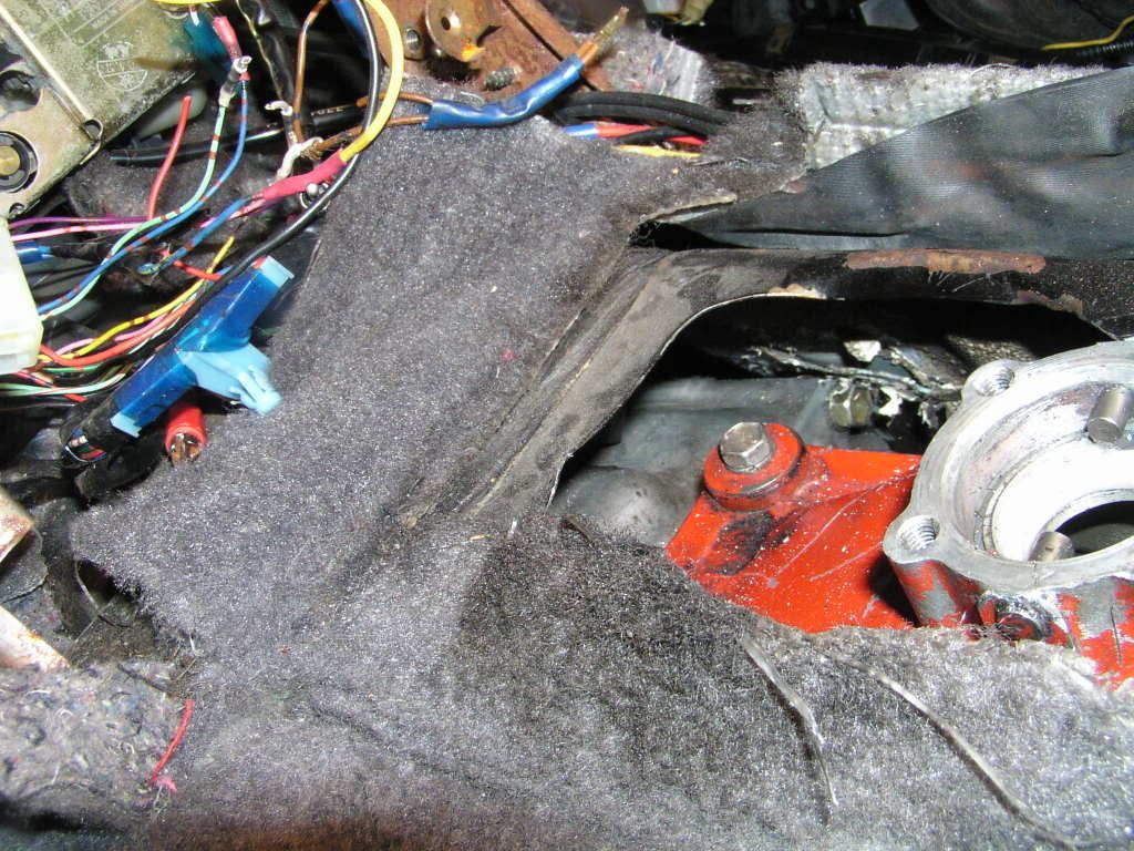

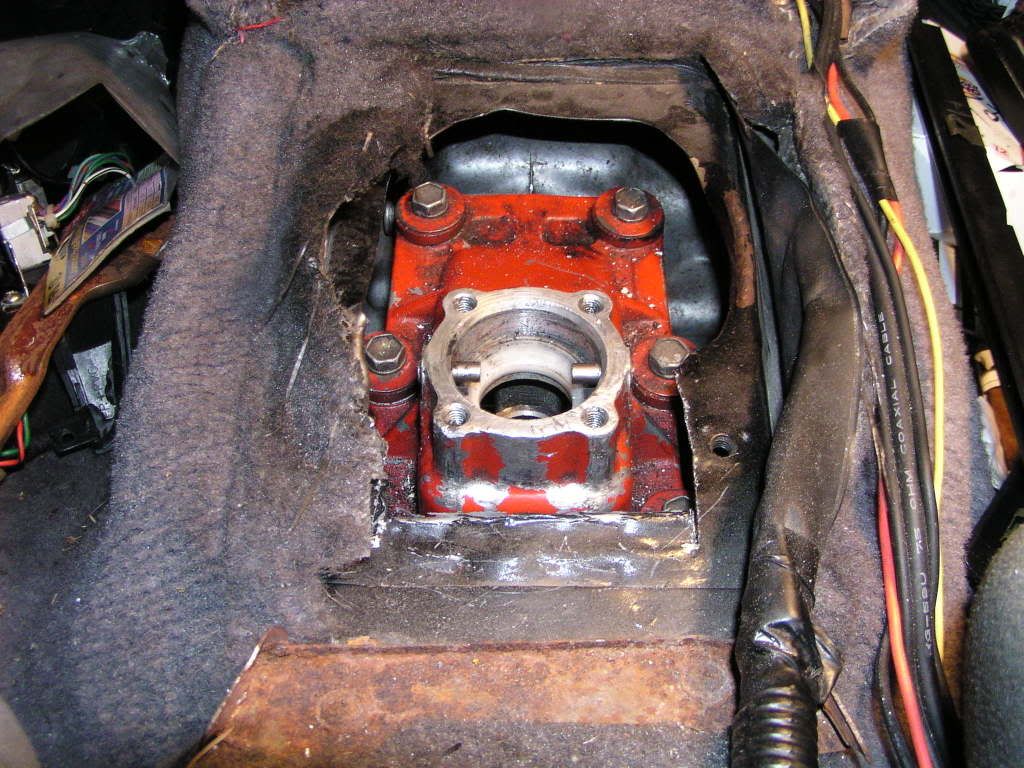

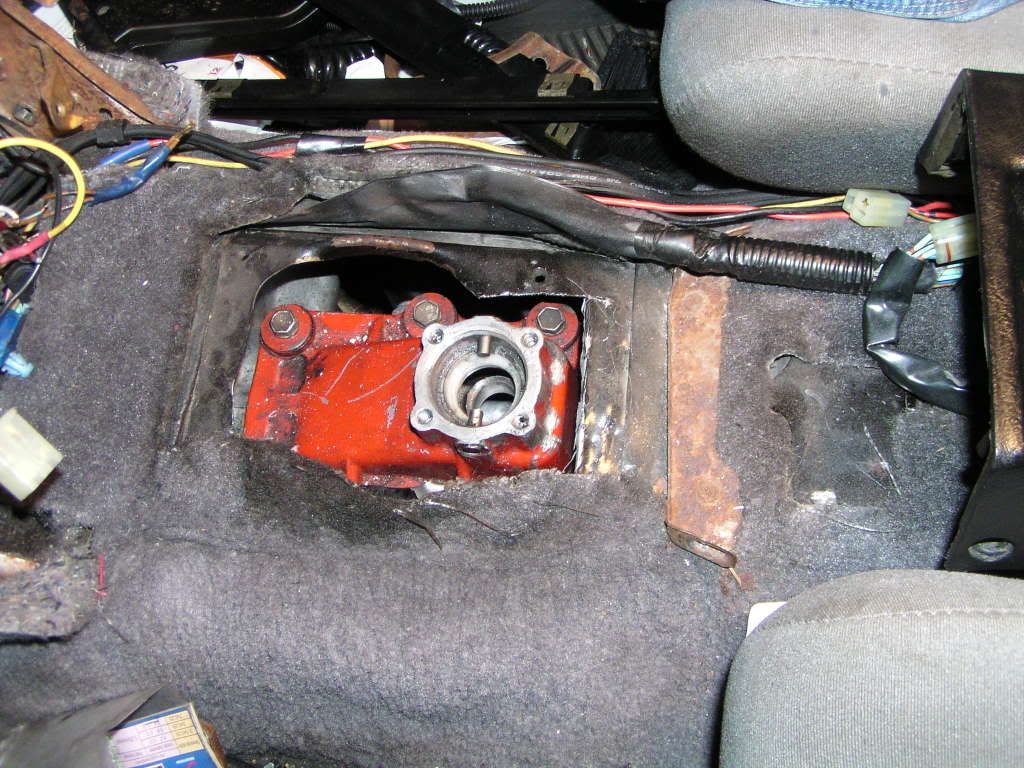

the whole that's needed to fit the R154
i made two quick slit's with the sawsal and bent the metal back and under look's cleaner and isn't to sharp.
About here is where you need to pound out the tranny tunel,you need to make it wider then the tranny, i belive the tranny sit's about 10-10.5 inches wide.
