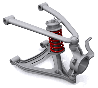

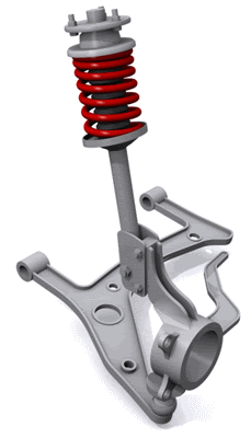

Well strut bars and supras = zero effect for the same reason caster-camber upper mounting plates have zero effect.
Strut bars were developed to over come some of the weak points of a McPherson strut set up (the supra has a double A arm set up) With McPherson struts, the suspension geometry is effected by the upper mounting position, this is why (like on my BMW) you can run caster-camber plates to tweak the geometry. When the upper mounting point flexes under load it throws off the geometry.
Supra don't not have a McPherson strut set up, we use a double A-arm set up. Our shocks mount to the A-arm via a pivot point and not to the spindles, so you could actually wiggle the shock around and it would have NO effect on the steering and tire geometry. Our load is transfered to the A-arms and then to the frame rails. So, strut bars and supras = a waste of money.
