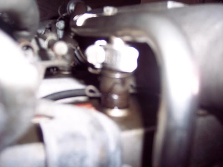

Heres the crack, its the first pcv pipe going into the left valve cover....could this be my problem? Its cracked all the way down, it was never that bad before it was just a tiny crack that didnt even go halfway down, but maybe boosting so high that one time just tore it open?
starscream5000
Senior VIP Member
Aug 23, 2006
6,359
Hot and Humid, KY
I doubt it. People run oil catch cans with the outlet of the catch can having a small filter on it (they shouldn't do this of course) and I don't think they have the issue you're experiencing... That would be the same kinda leak you are experiencing.
