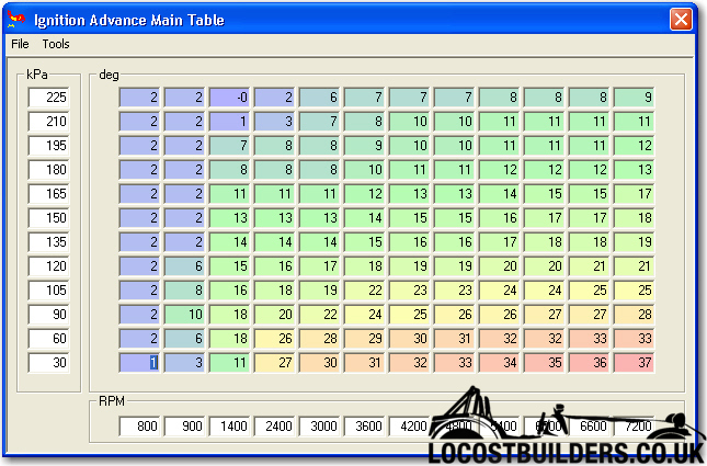

For what it's worth here's my first dyno from last year. Motor was stock everything, no boost controller, fmic, 3" dp and exhaust, and megasquirt. It was hitting about 13-14 psi. The temp in the shop was 90 degrees.
These things really wake up just messing with the timing a little :)
For reference, here's my timing map:
And here's an old video :)
