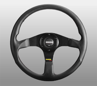

Now with a real Momo horn button...

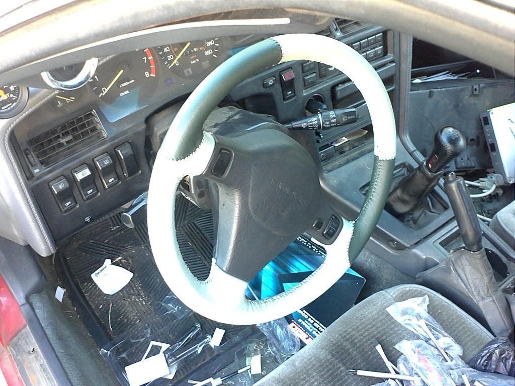

Grant wheels are cheap. Iirc like 40$ new or somethings.
One of these will prolly be my next wheel.
This is what i have now.
