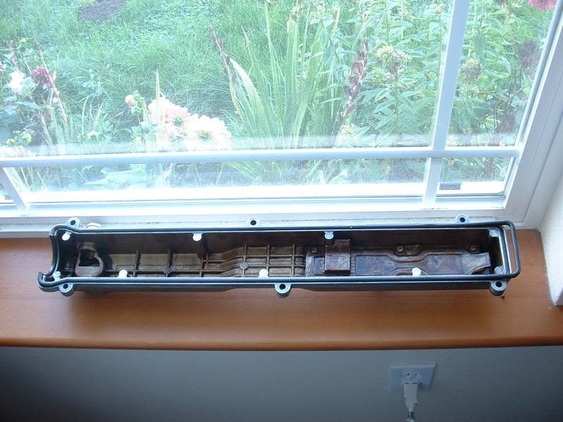

Did I do something wrong? The gasket isn't fitting. It says it's for the 7MGE engine. I'm half tempted to just use the old gaskets. They seem to be fine, besides the fact that the guy who last owned the car put in A TON of sealant.
s383mmber1
Oct 31, 2005
3,614
Somers New York
My 7mge gaskets were EXACTLY like that. I squeezed them in, and there was a small bump in the middle of each side.
Tightened em down with a little fipg and no problems so far :)
Not to say i suggest using that gasket....

Doesn't the 2J have similar valve covers, and a slightly longer motor? Was thinking maybe that's what those are for, just packaged wrong.

I was gonna get them from Toyota but I called the toyota dealerships in like a 25 mile radius and they don't have them. They can order them but they don't have them on hand. I ended up calling my friend up who happened to be about 25 miles north and he found one that's some japanese brand but it fit perfectly. The problem is that he only bought one though...

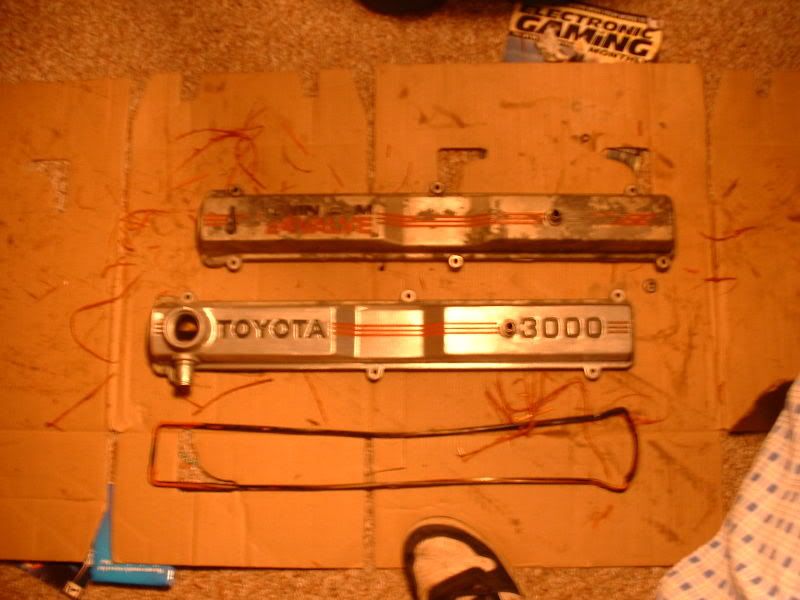

Hey since I have the valve covers off I figured I might as well clean them off. I'm almost done with the first one. It looked pretty much like the top one before I started cleaning it. Oh yea and all that stringy crap is sealant I had to scrape off.
