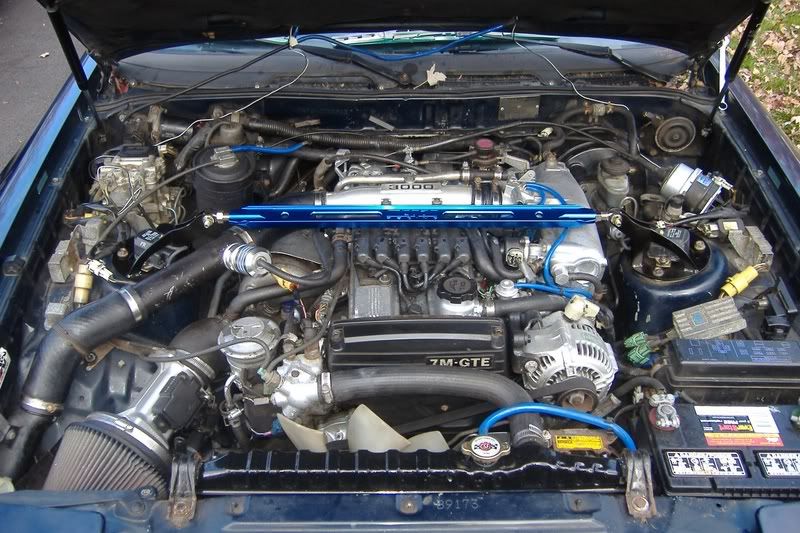

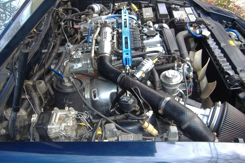

hmm interesting how you guys recirc. vented BOV. I had my turbo xs type H in for the past year, and took it out about 3 weeks ago b/c i finally got tired of it stalling out in traffic (especially up hills). Im curious if you guys think it's possible to recirculate this bov
so it won't stall out but still have the vented sound?
heres my setup before that stalled

what you could do is find a BOV that vents some air to the atmosphere and the rest into the accordion hose. i have a BOV that does that (i believe its turbo XS as well) and my car doesn't hesitate or stumble but you still get a nice swoosh at anything over vacuum. works good.
americanjebus
Mr. Evergreen
1,867
wa.
You could run your car w/ a speed density set up and vent your bov that way. Otherwise your going to keep running into that rich condition after you let off of the gas until you stop ignoring the problem.
Its a MAF system and just ISN'T designed to vent.

I used to have a stalling problem also. All I needed to do was to adjust the spring on the BOV. Not sure if the TurboXS has an adjustment though. If it does, try to tighten the spring. It helped me, and I could be wrong.
Cedrock15
The Sarcasm Specialist
Sep 29, 2005
126
Bucks County, PA
Nah turbo xs doesnt have a option to adjust spring. When i called last year and asked them what to do to fix the stalling the guy recommended i cut the spring a little at a time to see what works (they sell replacement springs), there was a difference but very minor. I cant afford the maft conversion and need a low budget fix for minor b/c as of now my bov is off and collecting dust.
