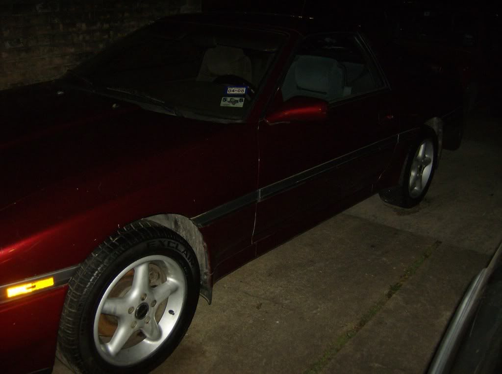

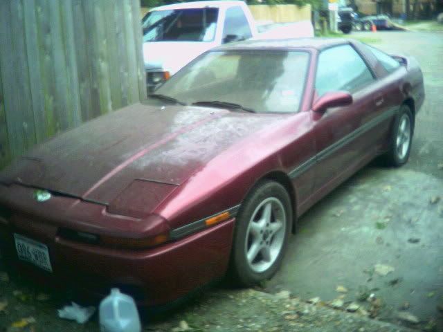

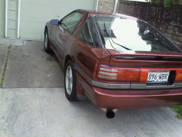

K k I get it lol, this thread sucks I guess. K let me try this again. :D. This is my 1990 supra before I bought it.
I bought the car with a bad engine soo a flatbed brought it to my house, once here I kind of washed it and cleaned it. Didnt want to do too much to it since I knew it would get dirty at the shop were they would do engine swap.

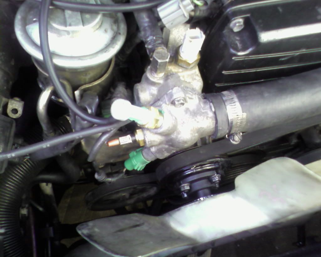

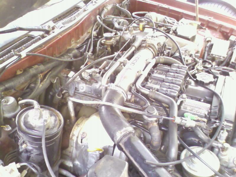

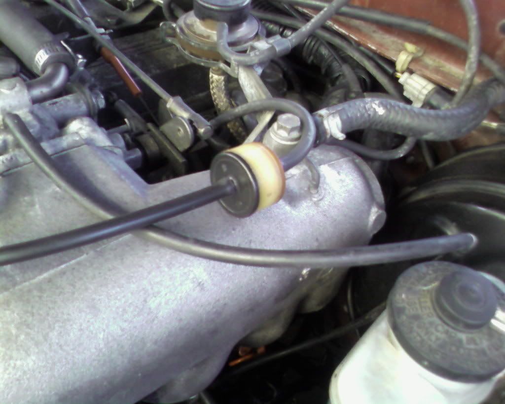

I brought the car on thursday only to find out the car wont go over mph, Yeah there is a tons of black smoke coming out, I been told this is a boost leak and well who am I to argue. I have also been told to check for error codes and these codes have been Knock Sensor and O2 aka Oxygen Sensor. What happens is I start driving it, it shifts into 1st gear then when I accelarate it kind of stays stuck, like in neutral just accelerating but going at max 20 mph. Yesterday I removed a spark plug and It was filled with black smoke. This worried me. The mechanic told me to change all the top sensors before running the car regurlaly but he didnt plug all hoses in and left something just sucking air I believe?
This
See
And these are the sensors he told me to change, so far I have changed most of them. Not sure how important these are to the issue.
K, 1st step for me in this supra build is to get it running because I kind of need the car asap. So what do you guys believe this is?. I hope its not a big deal but I am still worried. Mg man has been of big help its just I lost contact with him yesterday :(. Help?

and Sside why is your dash pot filter like that?

The mechanic who put this engine honestly sucked. That dash pot filter goes were? I have no idea because the mechanic didnt connect it. But Good News, after breaking my head for 2 days straight I decided to visit the mechanic and guess what he said. Do'h I forgot to connect the knock sensor. He told me to do it because he was scared to mess the engine up. So now I have what he said was a cut wire, i have to splice it and hook it up to the rear knock sensor. I located the sensor and I think the wire also but how the hell do I rewire it. I cant even see it. My father got his hands on another knock sensor and oxygen sensor. So assuming its bad I have an extra. Sigh. haha woop woop. Better Owner Woop!!!!. :cry:

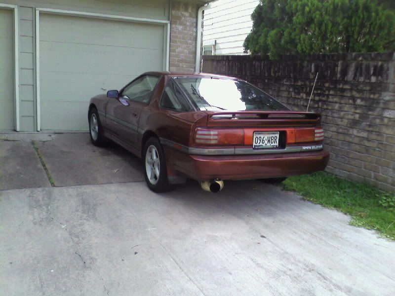

Nah I mean assuming the ones in the car are bad, I have extra :). I can see the 1st knock sensor but not the 2nd grrr. I am assuming I will need a conector right? So were do you recomend me to go get it? at the toyota dealer? or just any auto parts place. And it is just one wire going to it right?. I am gonna change the lower hose and all the top sensors and try and connect the knock that is unplugged. Oh look, I took these this morning :p. Thought yall might like to see emm.
I wish I could take out for 1 spin :(.
JDMMA70
Dec 4, 2006
2,550
Houston
Sside;1038694 said:
Nah I mean assuming the ones in the car are bad, I have extra :). I can see the 1st knock sensor but not the 2nd grrr. I am assuming I will need a conector right? So were do you recomend me to go get it? at the toyota dealer? or just any auto parts place. And it is just one wire going to it right?. I am gonna change the lower hose and all the top sensors and try and connect the knock that is unplugged. Oh look, I took these this morning :p. Thought yall might like to see emm. I wish I could take out for 1 spin :(.
Your muffler is crooked :icon_razz thats so JDM :sarcasm:
