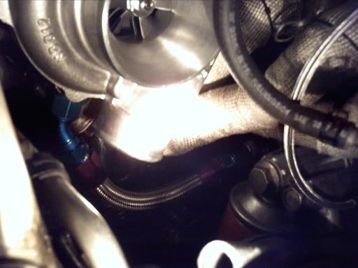

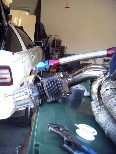

Im using a hard line for the return i will get some pics when it is done.
Yes the compressor hit the runner so i made a half inch stainless spacer.
Havent done the dipstick yet but i think i have a good idea on how to do it.

IJ: is there any difference in running the turbo oil return straight into the pan like you have as opposed to where it drains stock?

I just did mine that way as the GrpA pan is already plumbed for it!
I've used the block return a few times as well.

havent made the oil drain yet.
yes the compressor of my gt40 would hit the runners, so i bought 2 1/2in thick flanges to use as spacers and it clears now, and my car is an mkii with front sump so my dipstick is in the fwd most hole on the block so clears fine. hope the info is useful. didnt get my mani from ssautchrome but its the same one.

I would think this would be better as there is no way for the crank to grab the returning oil unlike the block return ;)

i got braided lines & fittings to make my oil drain
didn't change the dipstick at all.. just made a little metal bracket and bolted it with one of the compressor housing bolts
and .6 housing doesn't touch exh manifold
and if it does... talk to IJ and see if you can convince him enough to make an adaptor, or he'll at least give you a suggestion on where to go hehe ;)

My drain is the same as MK3Brents
and Yes my comp. housing hit the runners, I made a spacer for it. 1-1/4" I think.
