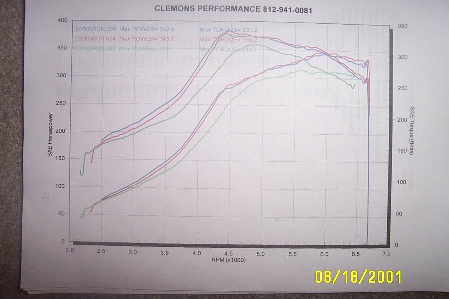

After reviewing the logs, it looks like I was pushing close to 14 psi with the cut-out open towards the end.
The one run I did with the cut-out closed was at 12 psi. That was 313 and 313 by the way.
I hope I got the 10 psi spring I ordered and not the 14 psi one.
If I do have the 14 psi spring would the restriction of the stock catback keep the boost at 12 psi or should I have hit 14 with that as well?
