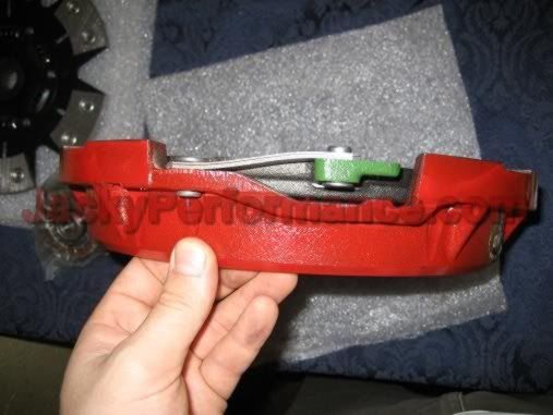

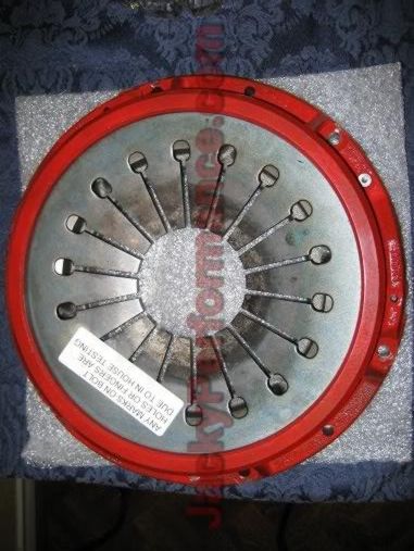

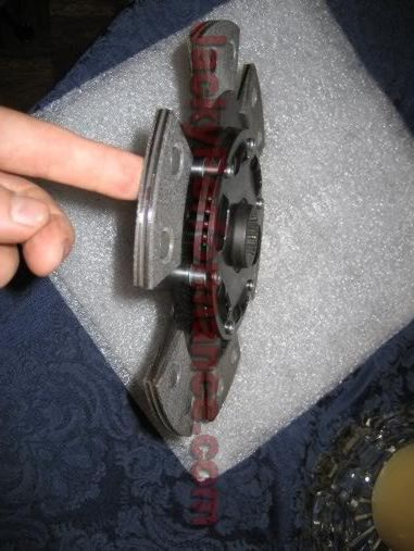

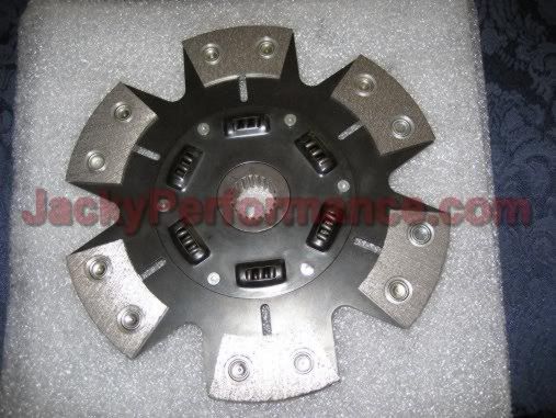

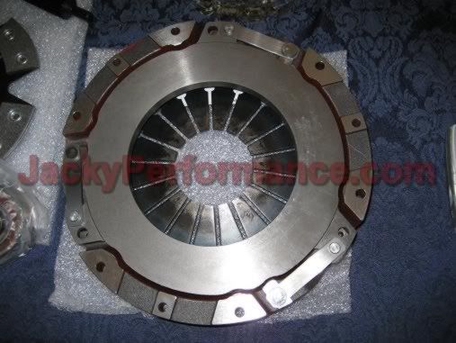

well it sounds like Southbend is the way to go as this is not the first time I've heard of the Spec slipping at lower-than-rated torque levels. Went with sprung 6 puck instead and it uses thier 2500lb pressure plate :naughty: . thanks for that info about refacing though figgie. Southbend stage 5 pics:
