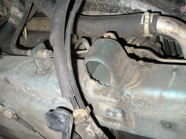

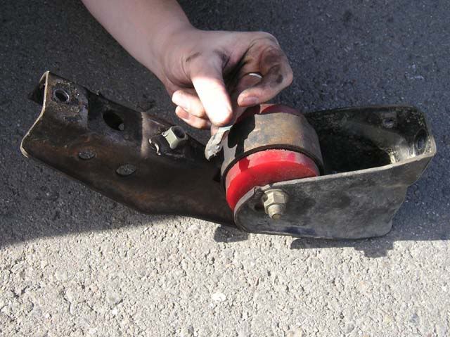

Here is what happens when you put urathane motor mounts in an 85 MR2 without proper reinforcements.
