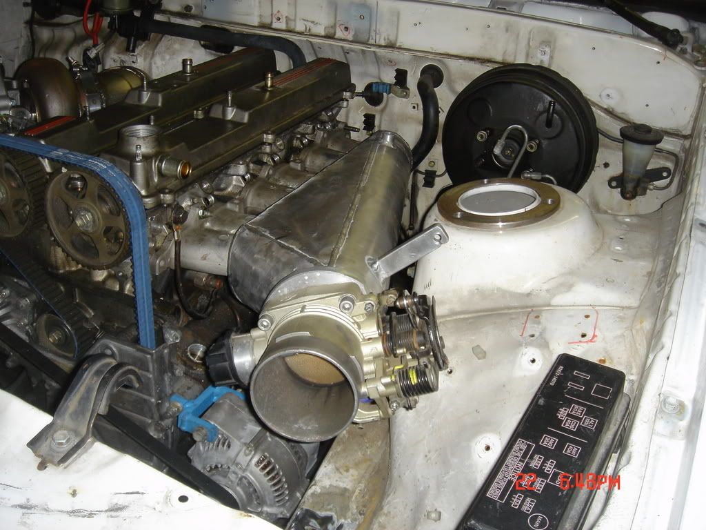

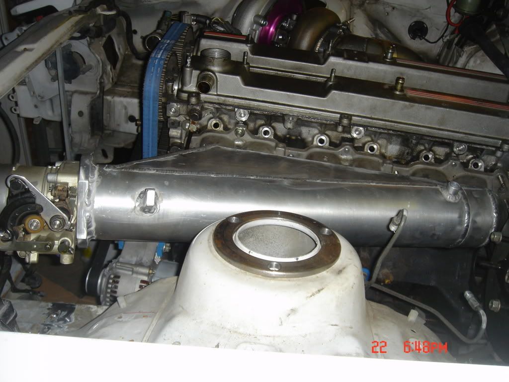

I have solid motor mounts so i wanted the traney solid to.
Thanks the down pipe was real fun to make lol.
Right now the motor is stock once i have mocked everthing up im gonna pull it and build it.

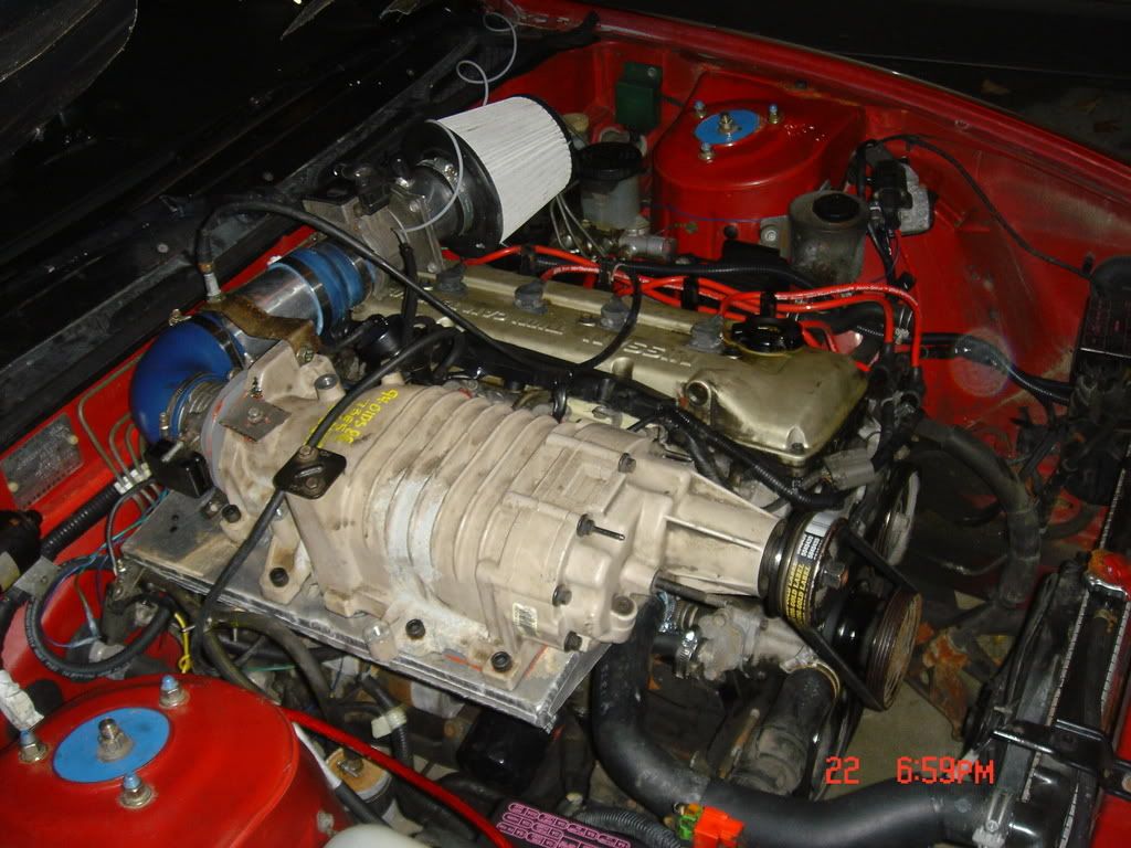

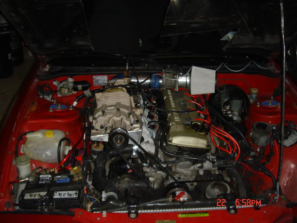

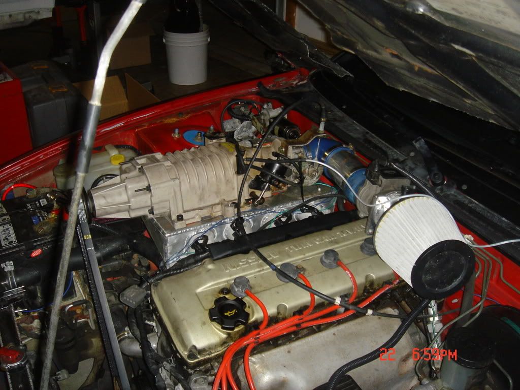

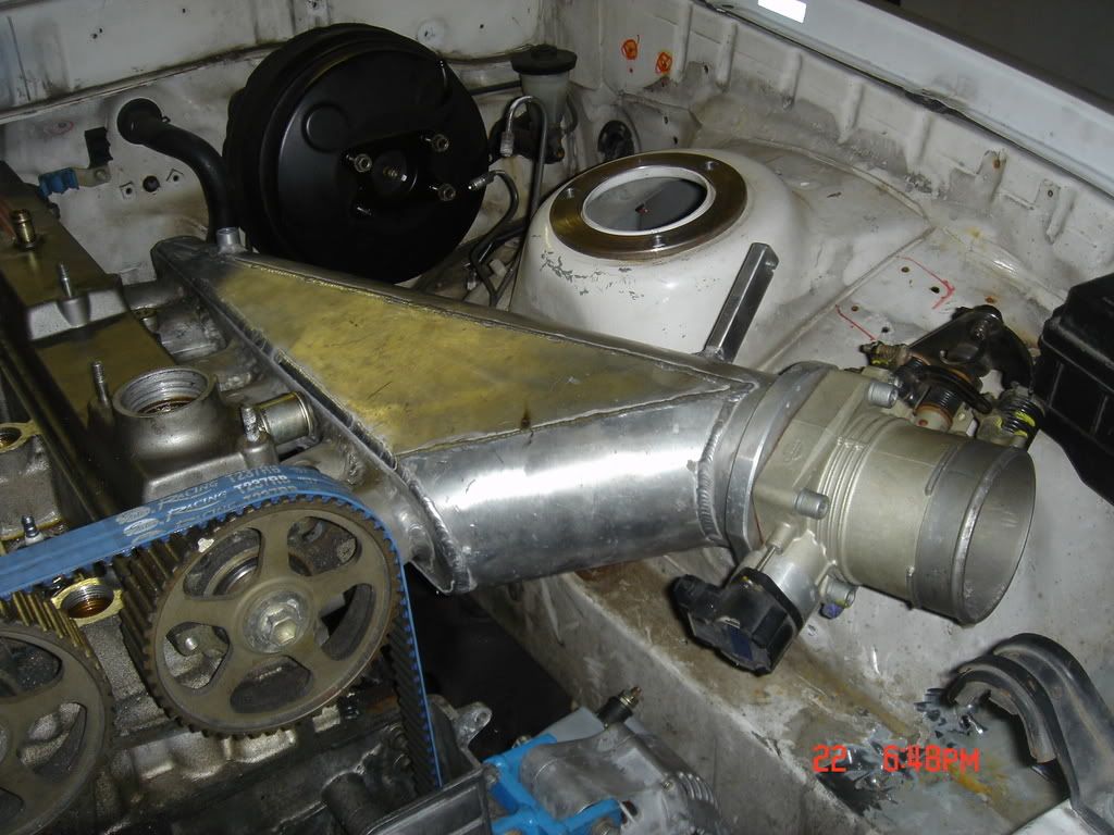

YEA i finaly got my intake back!!!!!
Here is my most recent project my buddie has a ka24 240 i made him an intake to put a pontiac GTP blower on it and with no tune it runs pretty good. HE just threw it toghter so he can drive it i have to help him do it all right and not gheto like it is now.
