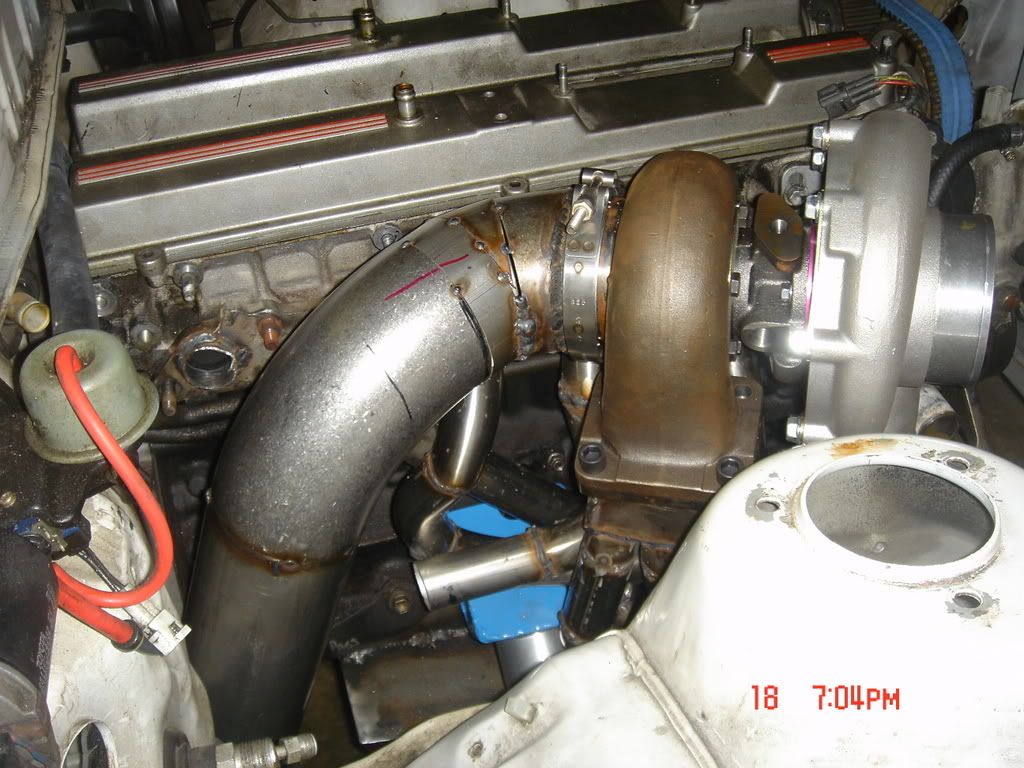

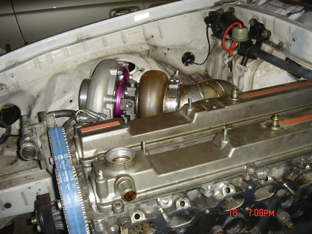

I have an 89 turbo targa im building im shooting high. Almost all the parts i run i custom make so thought out my build you can see the work i do i always appreciate your coments and ideas. so here are some pics of the engine bay and where my build is.

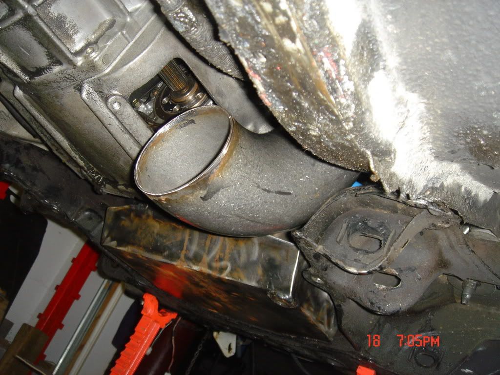

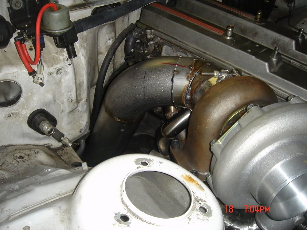

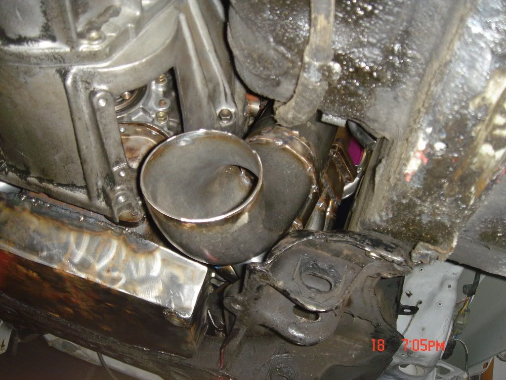

Did some work on the down pipe should have some pics tomorrow.

Yea i made the header and my internals are listed on post 13

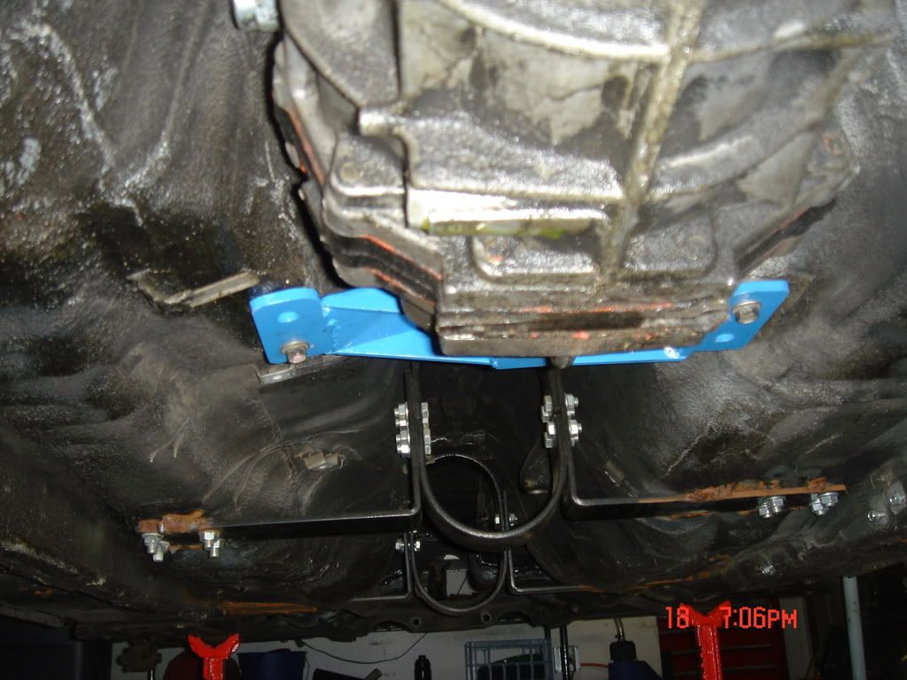

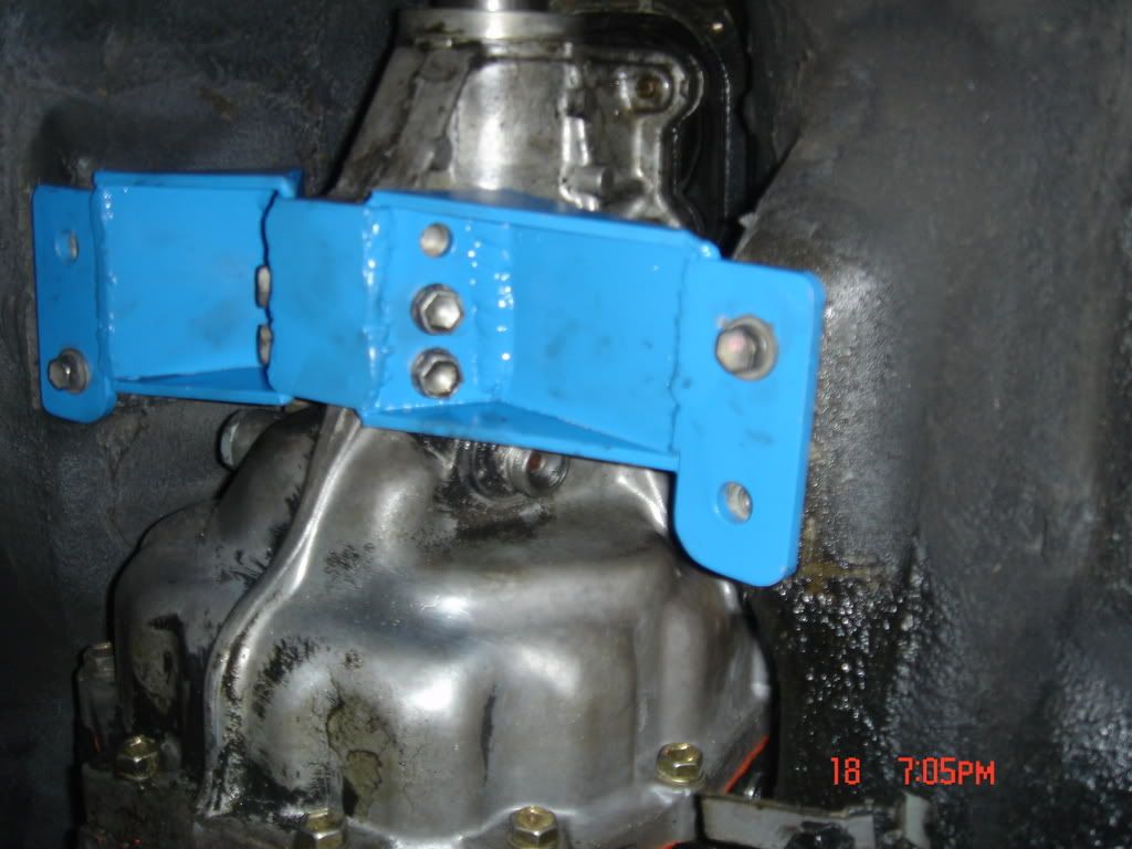

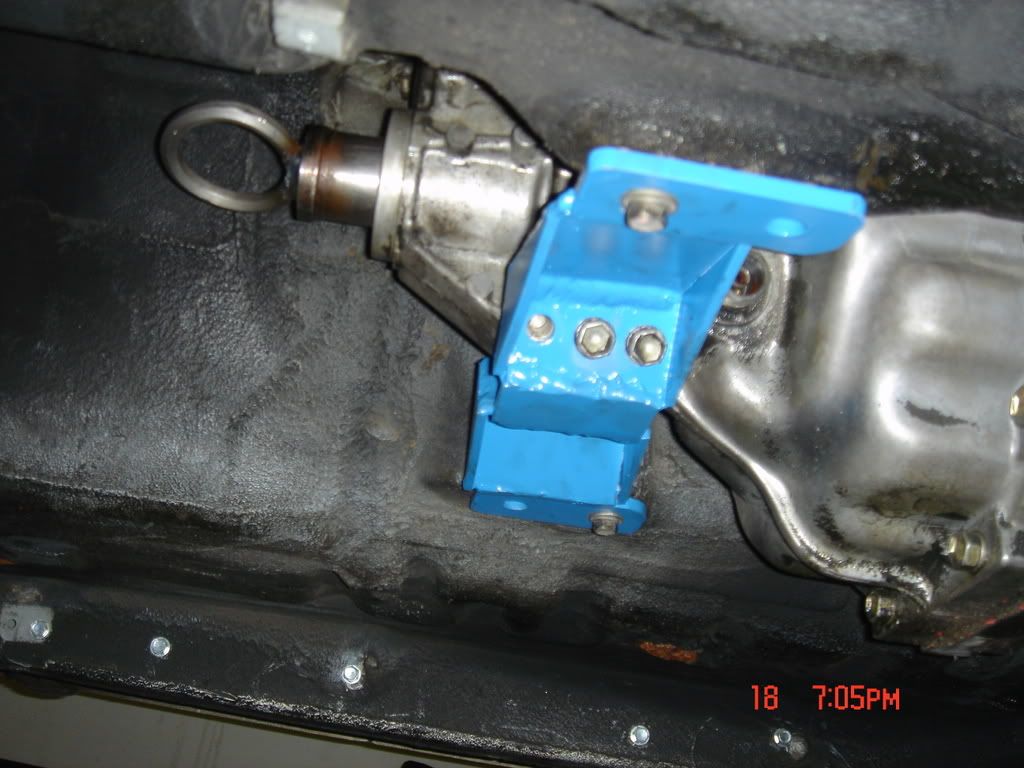

Duane here are the pics of my crossmember i fabed up that we were talikng about.
