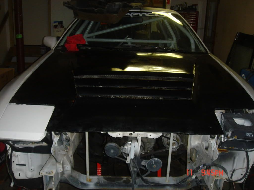

OK well im wes and this is my big build ive done alot of work on my car latley so i will try to post up some of the most recent pics of the build.

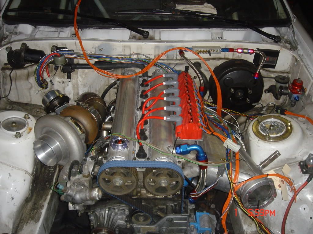

Working on the ecu harness

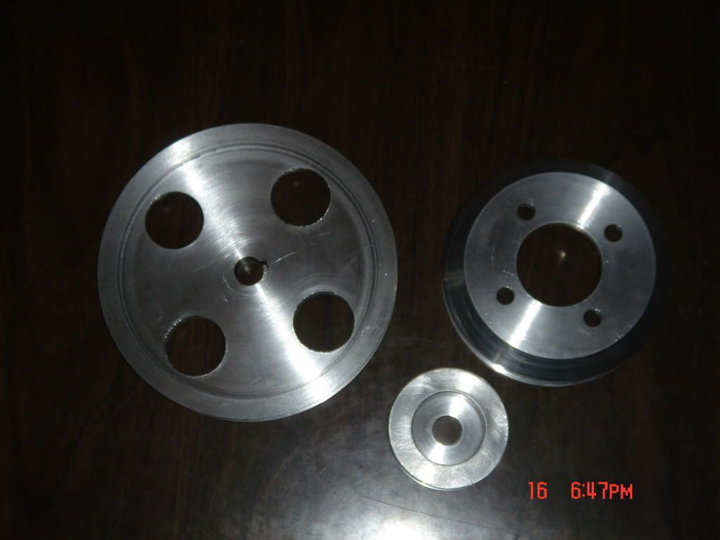

My pulleys i made

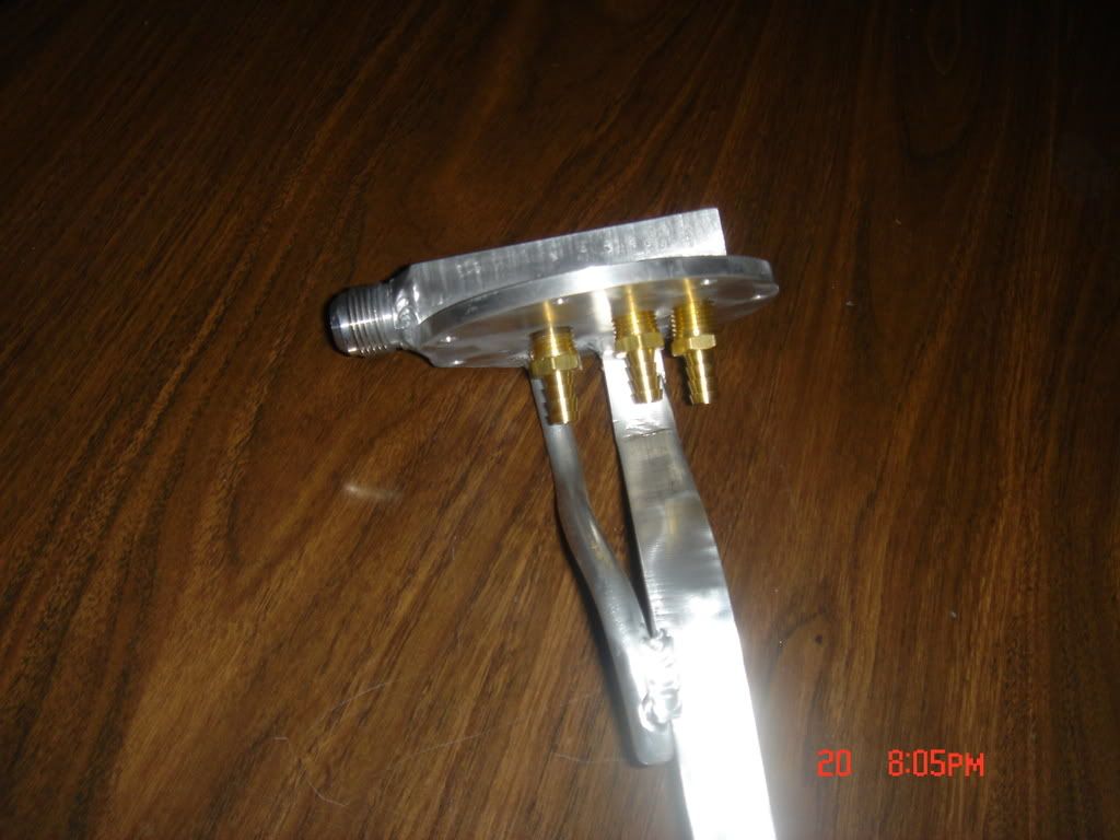

MY tripple walbro hanger

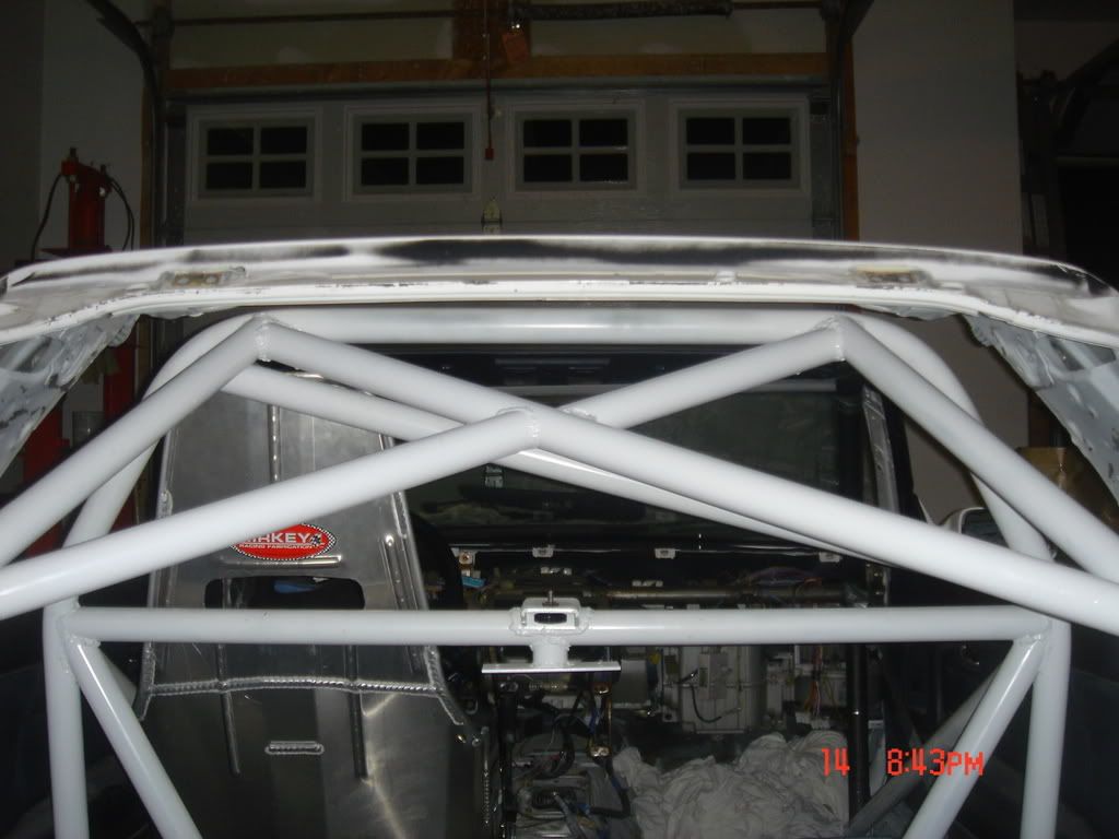

The work ive done on my cage

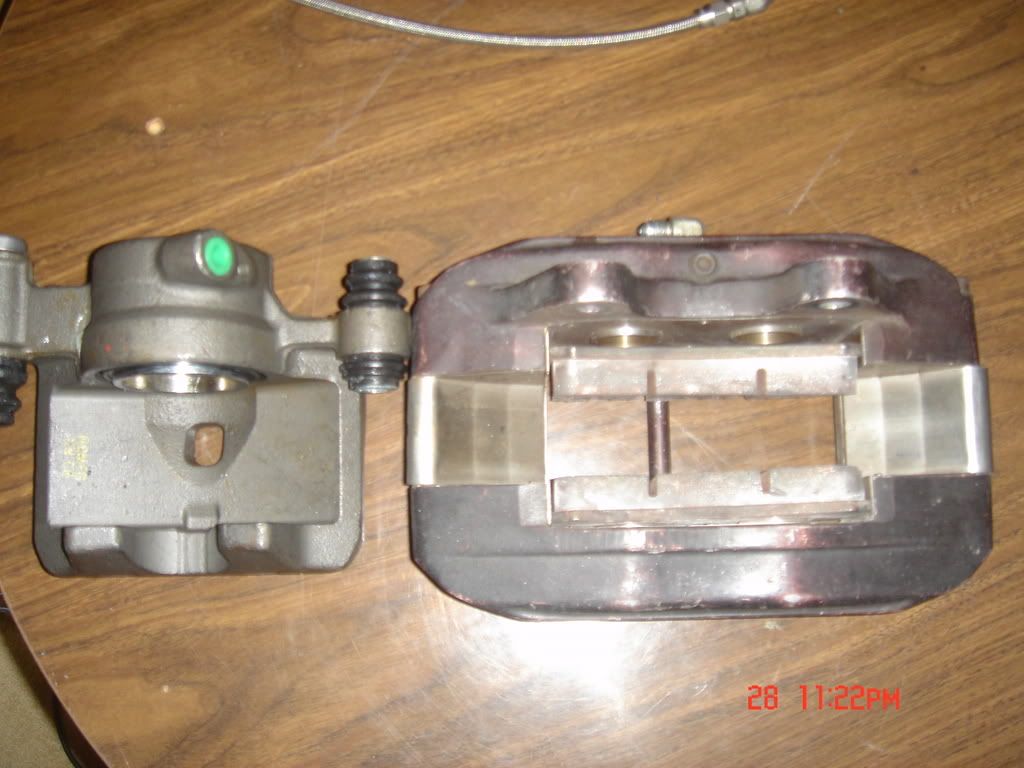

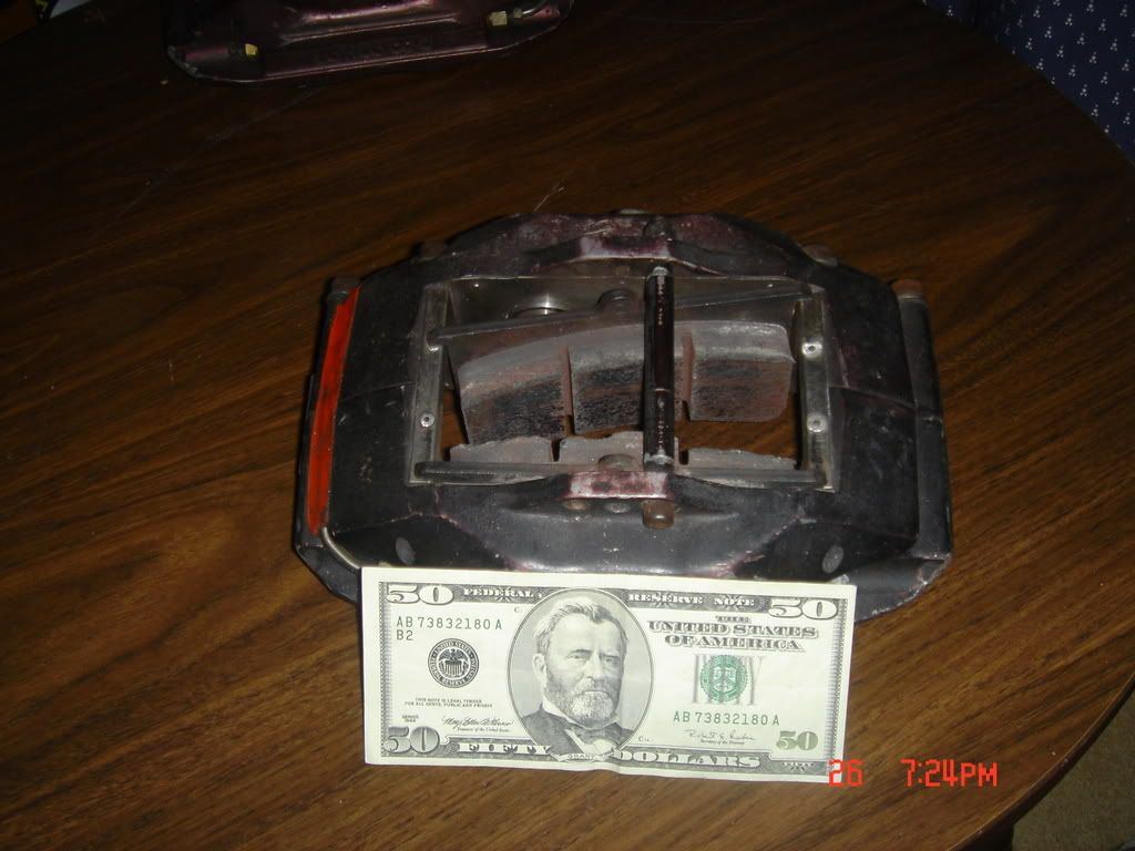

My front brake calipers

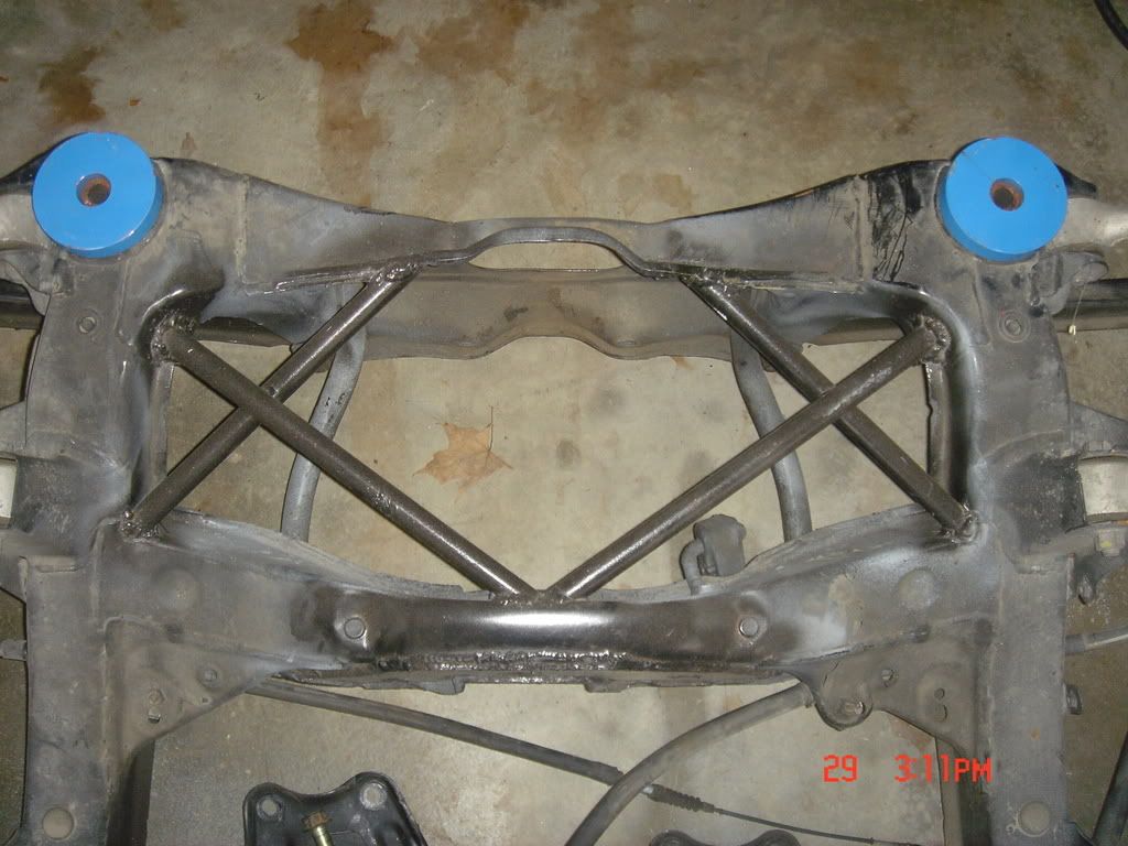

my rear subframe and subframe bushings

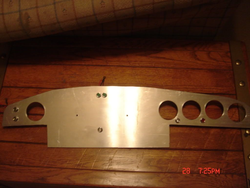

Im atempting to make a custom gauge cluster for autometer gauges

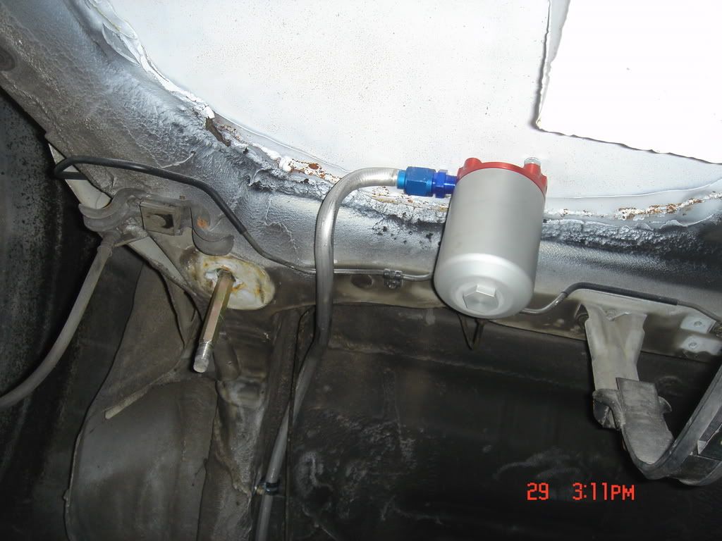

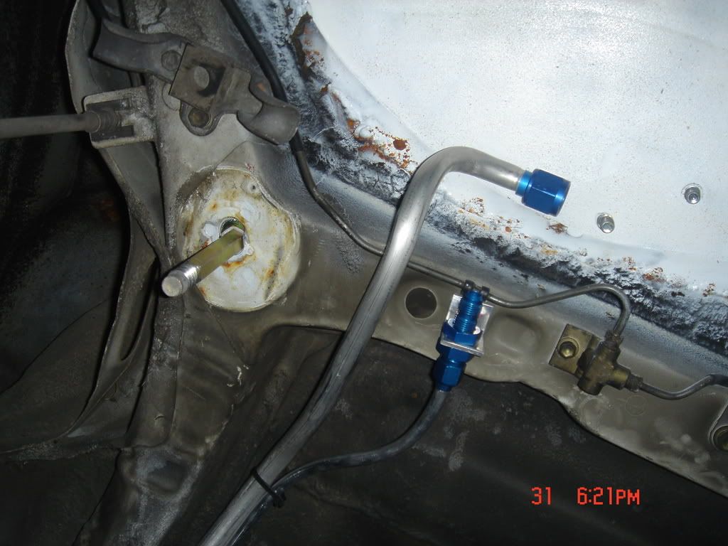

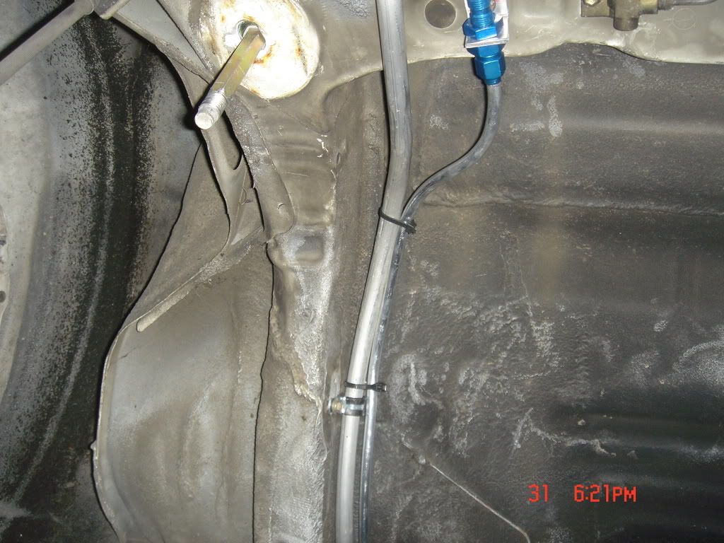

ANd i did some work on plumbing the fuel system today

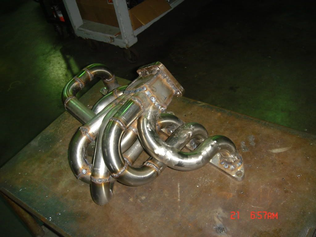

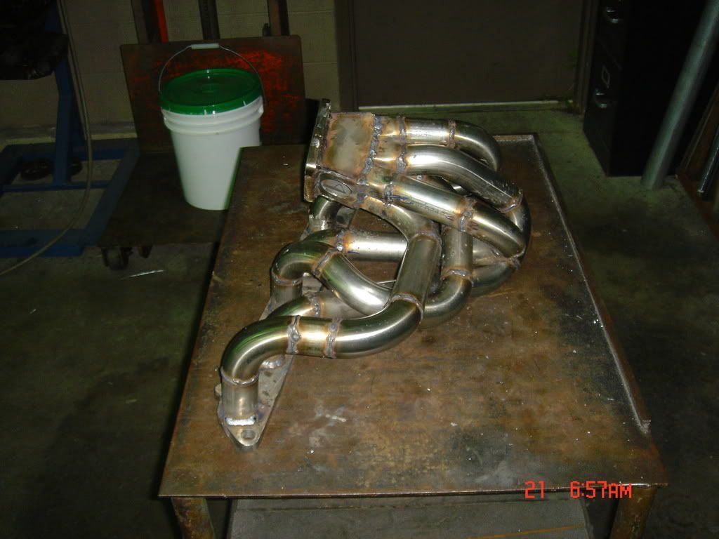

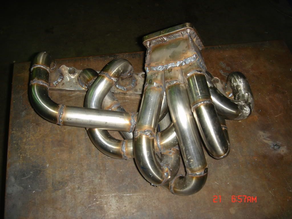

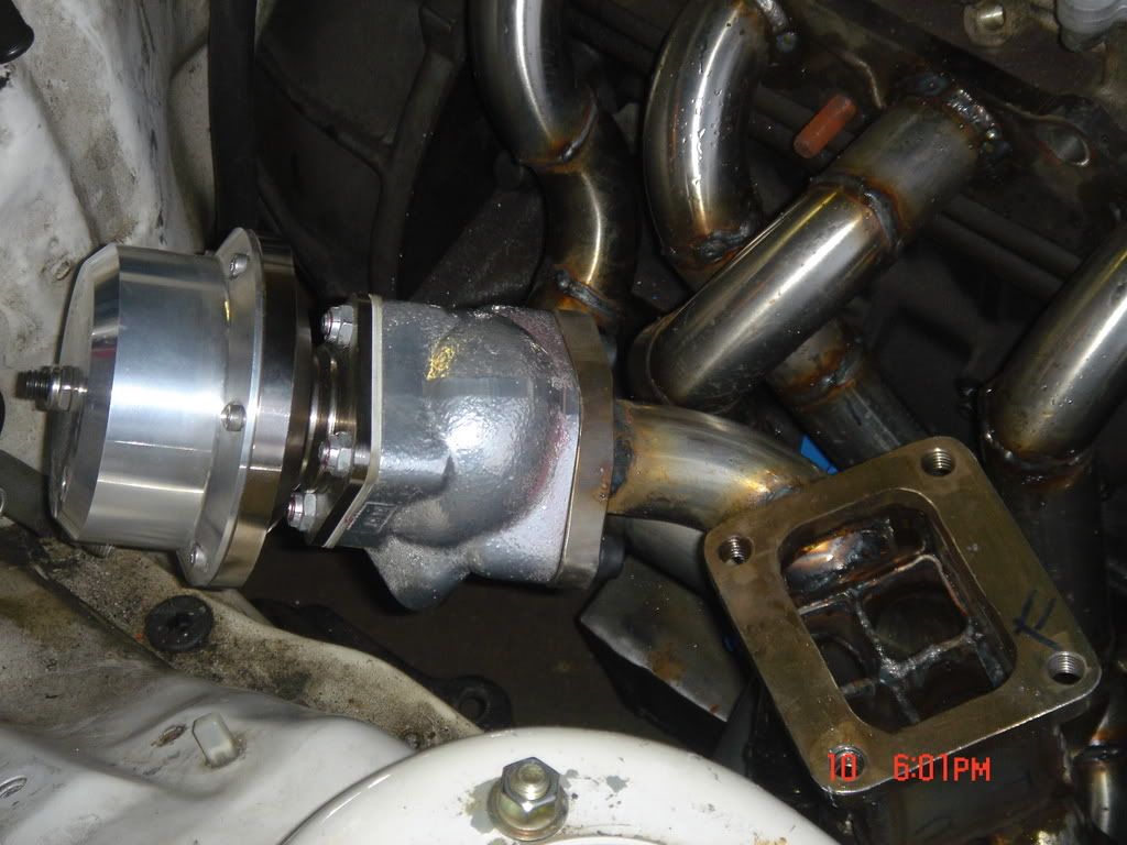

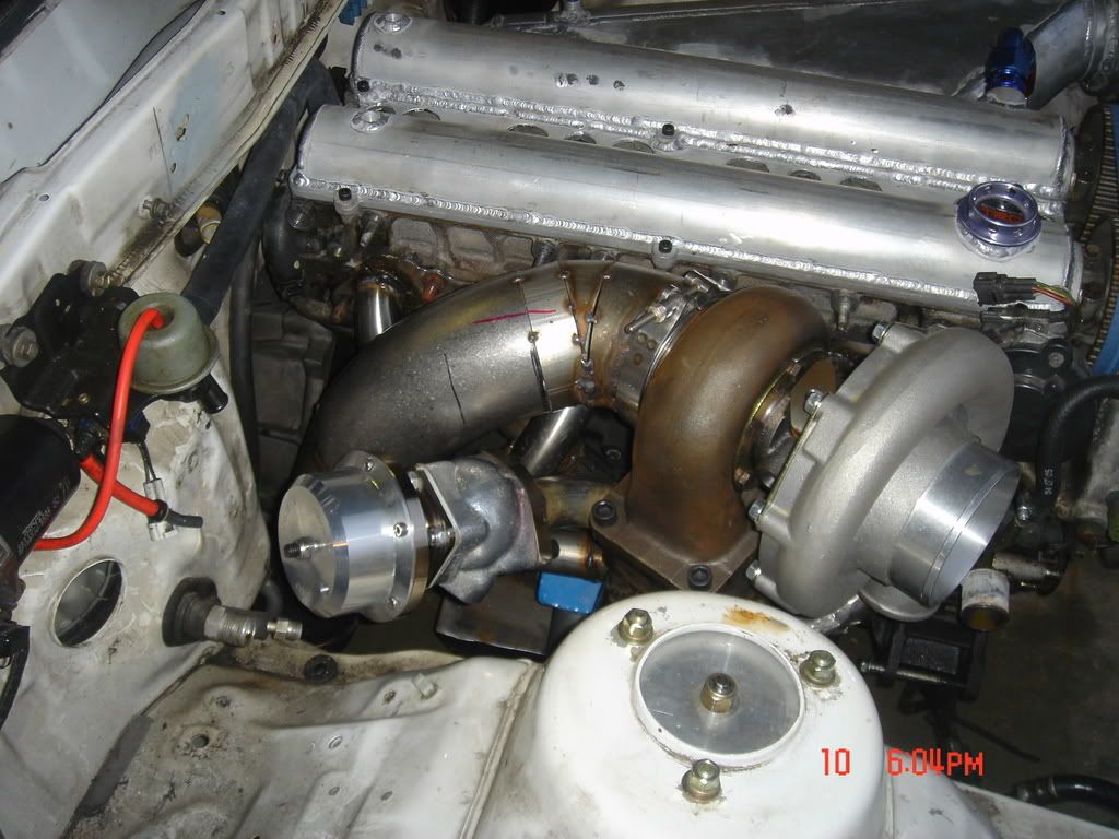

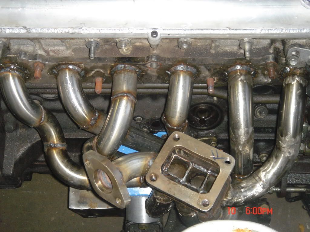

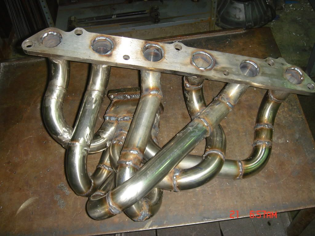

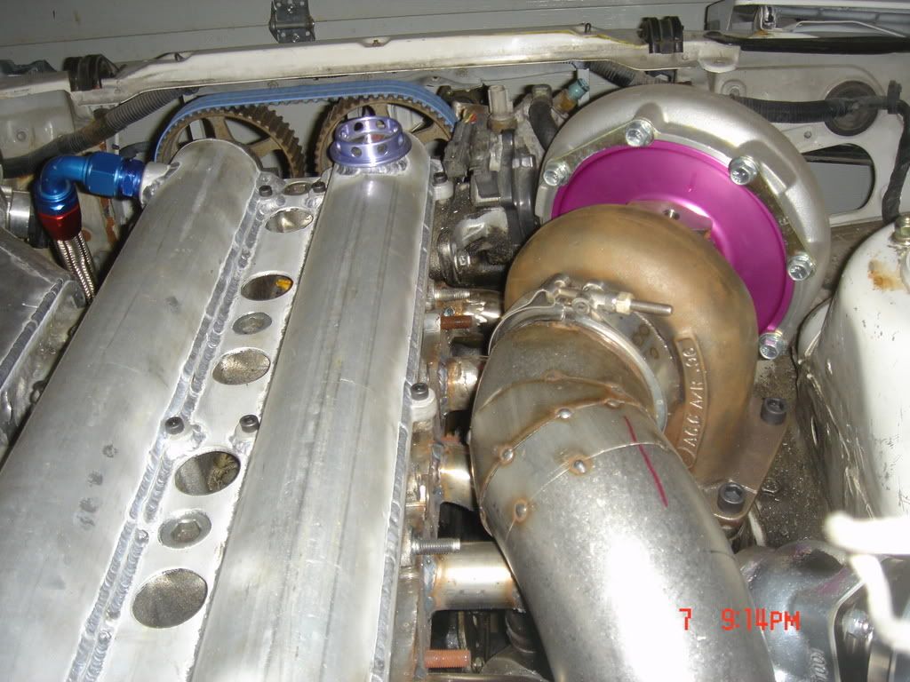

Got any pictures of your turbo setup in progress? What exhaust manifold is that?
wesbeech
Beech Performance Motorsports
Feb 26, 2006
1,022
Akron Ohio
What pics of the turbo set up do you wanna see The turbo manifold is a Beech Performance which means i made it

Well right now i dont know to much about the brakes cuz im still deciding how i want to do them and im still deciding on rear brakes

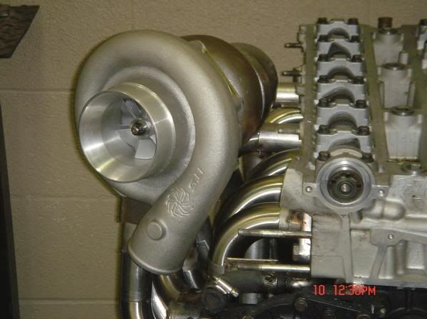

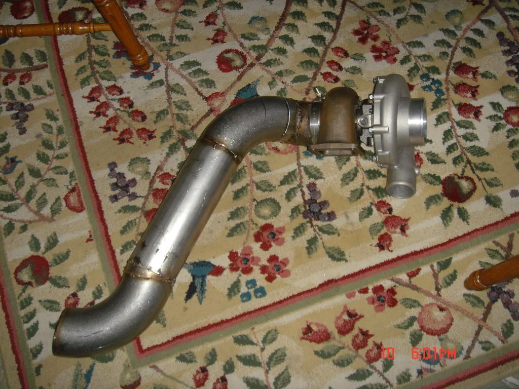

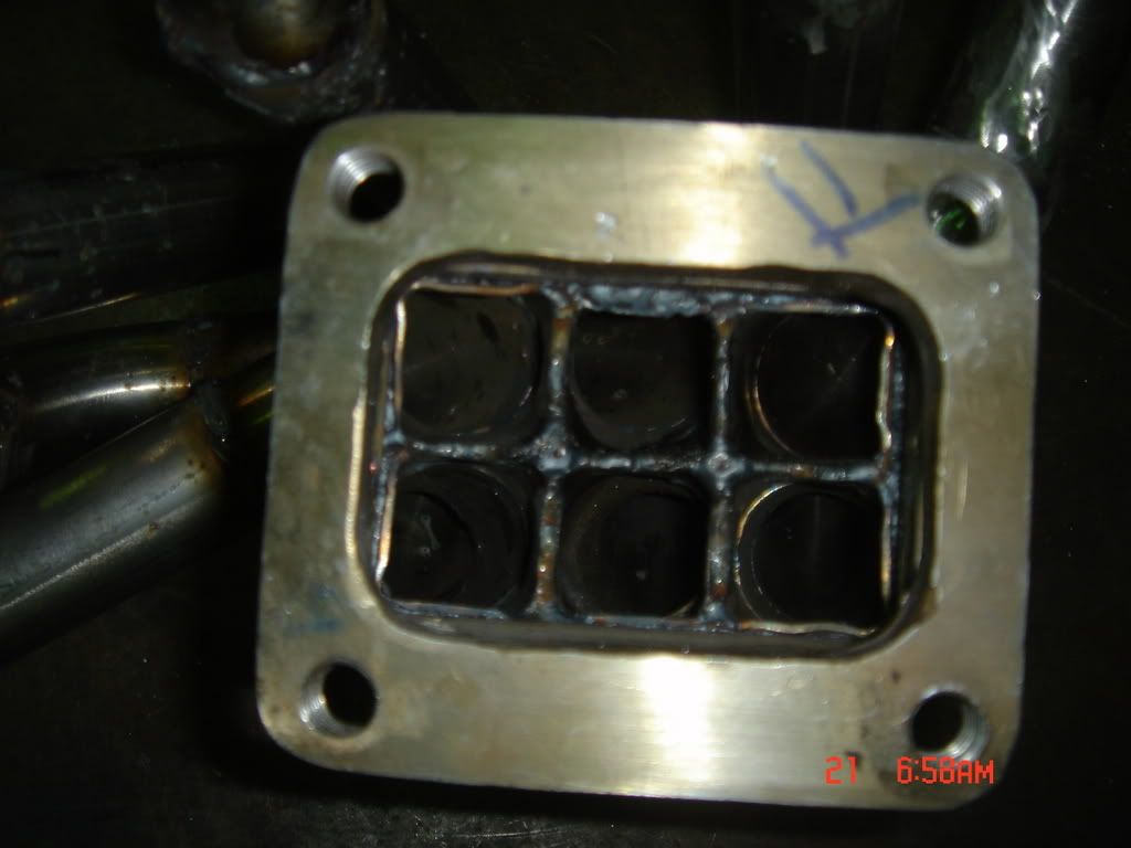

Here are all the pics i can find of the turbo set up in my photobucket

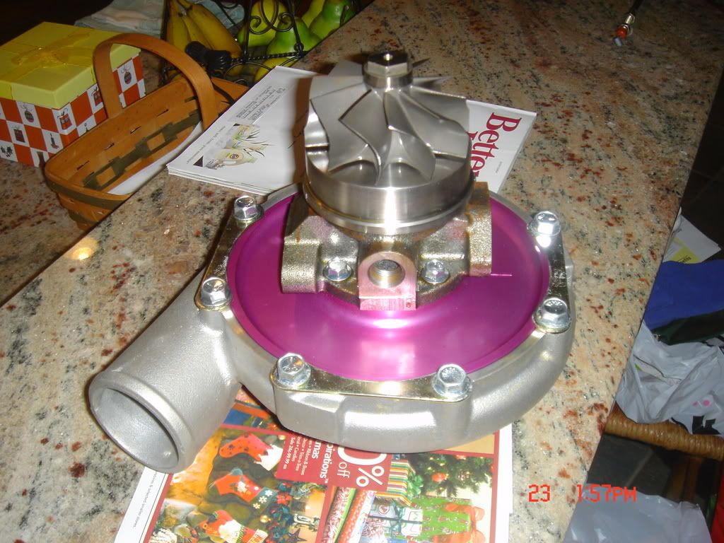

And the hair dryer itself
wesbeech
Feb 26, 2006
1,022
Akron Ohio
MK3.0dudeman said:
wow your gifted how long have you been welding for?
A few years but these welds look like shit but o well
I have to sent the manifold out to get extrude honed and hten cermaic coated cuz i dont wanna warp my fiberglass hood.
nice, get them shits honed and coated! Other than that the set up is looking sweet

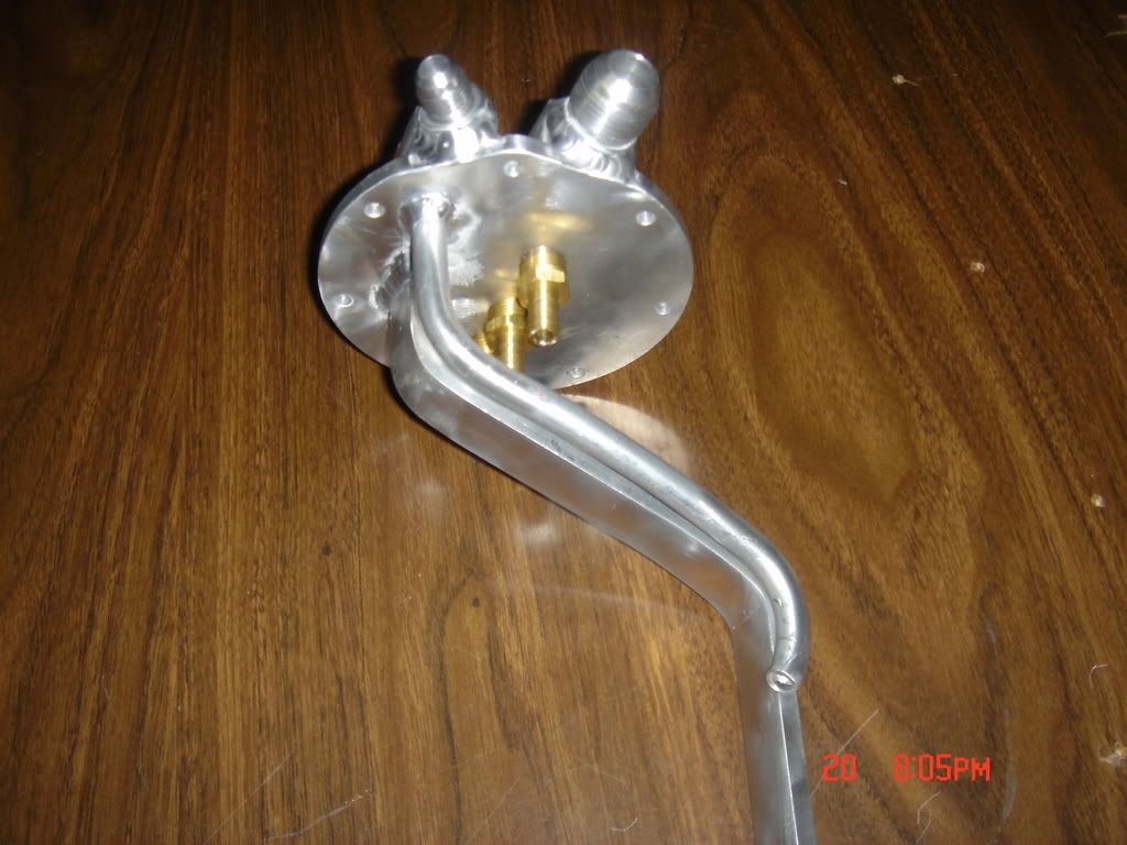

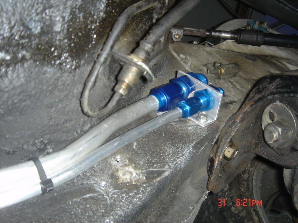

Well i ran to work today to make a few brackets real quick so i can mount my bulk heads. So i should be able to finshin up running the hard lines for my fuel.
wesbeech
Feb 26, 2006
1,022
Akron Ohio

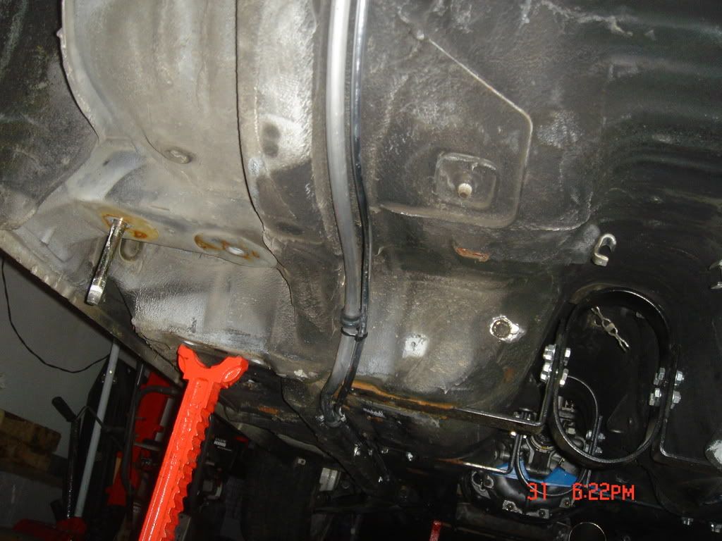

Well i finshed up runing the alu fuel lines today all i have left with that is i have to make a new brake line. I also did some work on my ic pipes but no pics of that.
