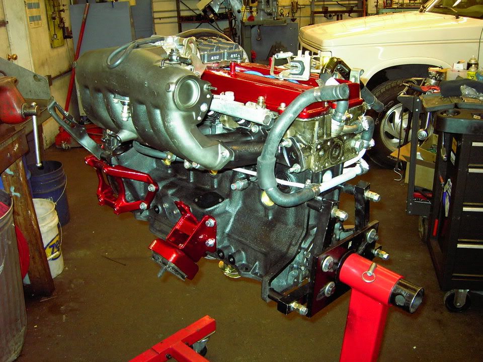

I mentioned this in another thread and I have done a company and internet search with little to show for it ...
I picked up a can of sherwin-williams Zinc-Clad cold galvanizing compound spray and was planning on coating the now mostly-rust-free somewhat pitted ends of me block heater and pump hardlines and maybe some of the conects on the intake mani for some corrosion prevention. It is a primer and I planned on putting a top could of high temp paint over the rest of the pipes as well. The only thing I could find online that was risky was the formation of white rust. I am just planning on putting 3-5 light layers on the ends only for protection and don't think it will add up to enough to damage anything... but thought I would run it by you all and get some input before i do anything...
The ends have been cleaned with a dremel (small steel brush attachment) and I am wondering if I should just leave them alone or coat them with something that will stave off the rust via self-sacrificing and/or potentially harm my engine...

here are a few pics of the ends I am worried about... replacement pipes are spendy from the local dealership and the local hydraulics shop was too scared to try to bend me new ones... so i am trying to save these...
good idea/bad idea?
sry bout the pic quality - macro isnt the greatest on this cheap camera...

either way will be fine, those look pretty normal from what I have seen. If you feel like painting them that should be fine and if you don't they should be fine.

I will prolly prime the ends inside and out with the zinc-clad just to see if it makes much difference after some miles go by - if its not gonna hurt anything internally....

Mine are coated inside and out with thermal barrier coatings from Techline.com.
It's a wet spray coating you then bake in your oven for one hour at about 300 degrees F.
Turned out nice, keeps heat out of my coolant since this runs under the exhaust manifold, and stops corrosion.
BTW, I just bypassed both the TB and ISC coolant lines by running a short hose from the coolant wrap around pipe to the nipple on the lower intake manifold. (Stock it goes to the TB, then ISC, then back to the nipple at the intake.)
No affect on cold start, and I have to think it keeps the intake manifold cooler not to have hot coolant passing through the throttle body and ISC all the time.

When I rebuild engine, to seal surfaces that have pits or you just want to prevent pitting of gasket surfaces. I use Devcon F putty to bring the surface to a smooth surface again first, It's an aircraft grade Epoxy Putty that’s 80% Aluminum powder. I've sealed holes from rocks on my desert bike with it so I know it's strong and thermally acceptable. Then once I get the surface back to normal I use Red Epoxy Insulating Enamel as a surface coating. This stuff is impervious to chemicals and dries like hard baked enamel. Once it’s dried I use the stock gaskets and I've never had leak after that. The positive is the next time you have to remove the gasket the surface will still be perfect, which makes for an easy reseal. This is also the same stuff many racers use to coat the inside of their blocks to help oil drain back to the pan faster.

i vote for brazing the tips then nice fine file and some elbow gresh usely i whould nto care cause thou pipe look liek they will last anther 10 plsu year befor they become an issue

if you spray bomed them they will be fine i sean much worse last for ever plus no one will see it but int he end you will knwo it is there and if that shit bugs you then replace it but that is kidna comon to find on car wiht poor owers aka past onwer not replaceing there coolent
cause it just turns to acid
