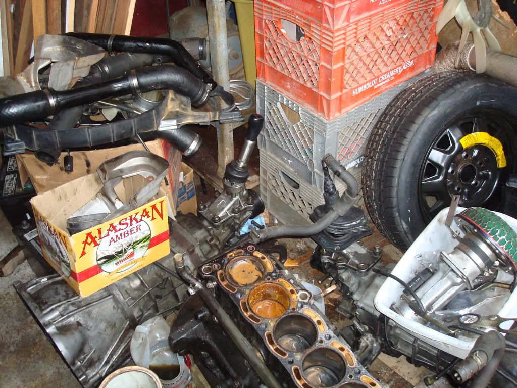

it has threads on it, but it only adjust maybe a inch. i think its perfect the way it came. way better than stock. 1st-2nd and 3rd-4th are quick status. here is a pic before i put my motor in.
